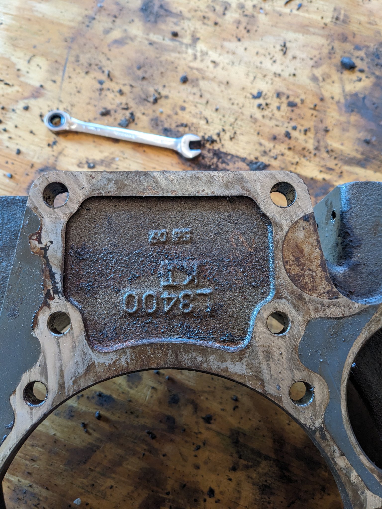

I was able to work on the tractor for the first time since the original posts. PXL_20241107_022153450.jpg
Pretty pleased with how its turned out on this half. Man, there was a lot of crap in here. I still need to coat with Ospho. I dont see any obvious leak sources. Also, several people said I need to look for a freeze plug that might be leaking, but I dont see a freeze plug - or maybe I just dont know what I should be looking for.
Any help would be greatly appreciated. Thanks!

That looks much better!
I believe you will have to remove the part (bell housing) that you just cleaned up off of the tractor. Then you will be looking at the back of the engine and the “freeze plug” will be in the rear of the engine block.
You may want to look at illustrated parts list to see what you need to remove

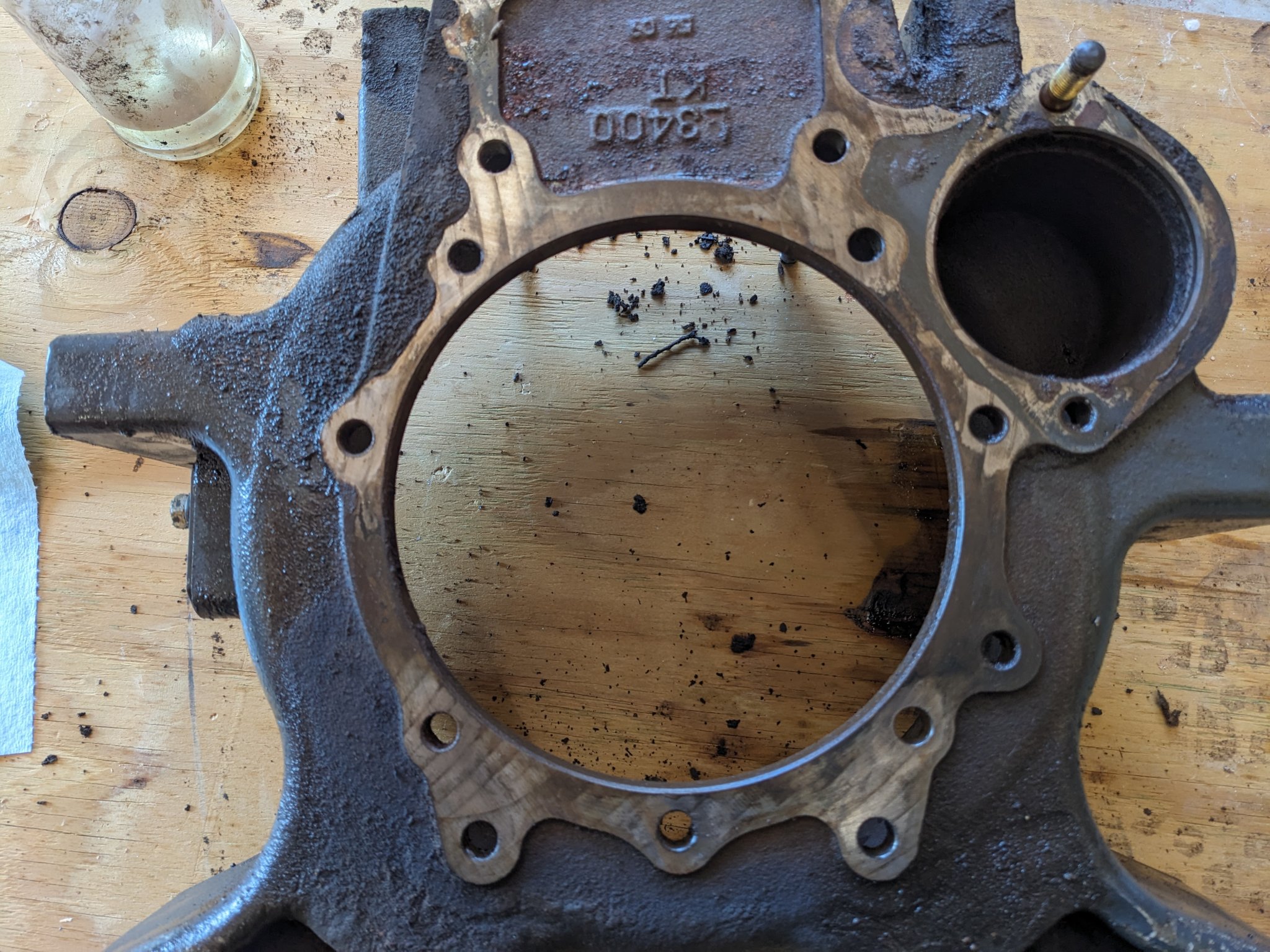

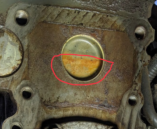

I flipped the bell housing around to look at the mating surface. A few spots around the circle don't look like clean bare metal. Do these spots look like where water could be getting in?

It looks like water was up to this level at one time.
I think the rear main seal is in that carrier with 16 bolts ( that should have some sort of lock plate?). Off, replace seal and back on.

Thats a good observation regarding that discoloration/water line. That freeze plug faces the area of the bell housing below that is enclosed. It could be that the tractor was submerged up to that place for awhile, but I think it could also be that the tractor sat out without running for a long time and rain seeped into that area and coudlnt get out.

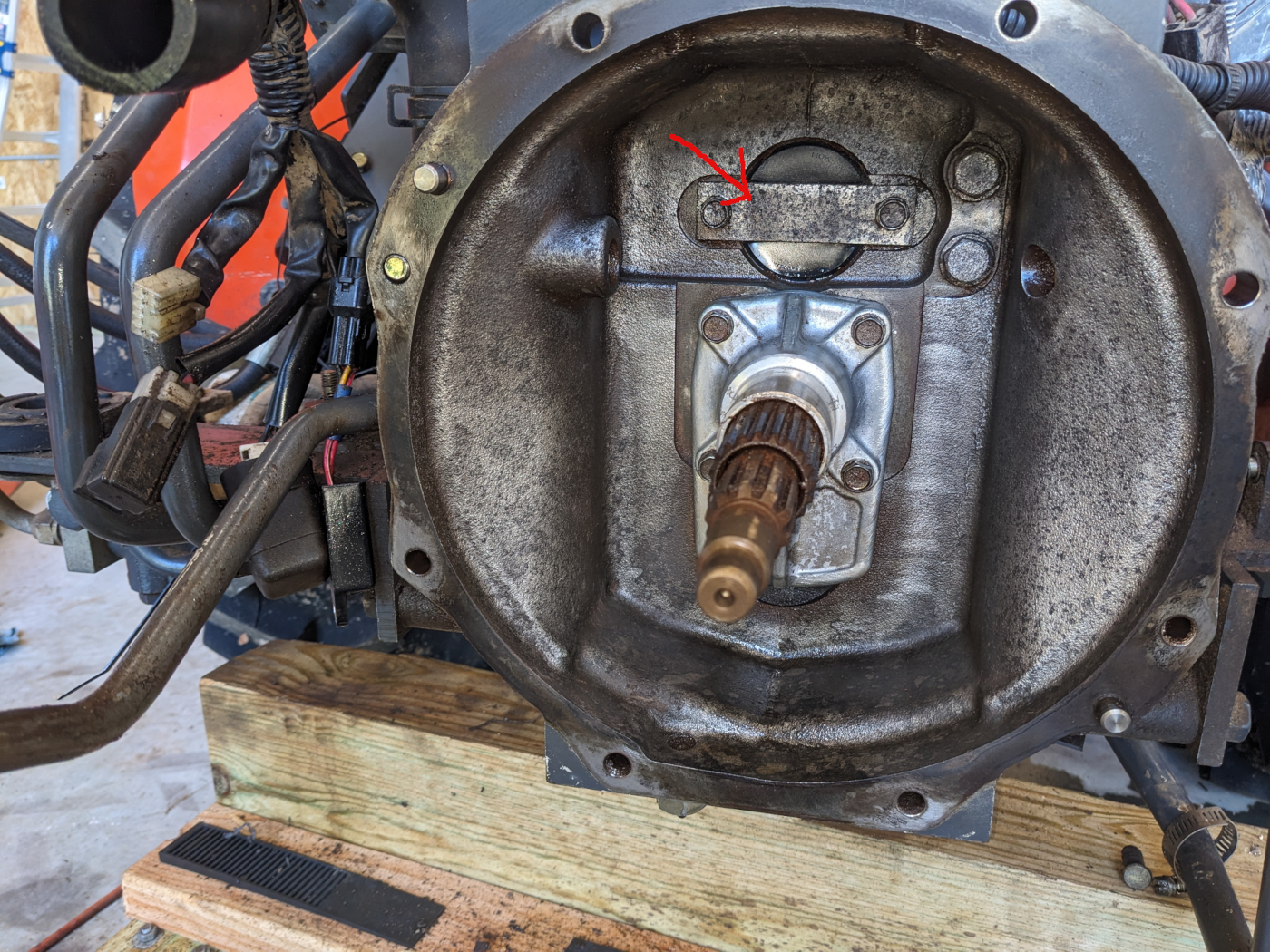

I got this mostly cleaned up and ready for paint.
What is the part pointed to by the red arrow? I'm not seeing this part on kubotas website. Every other bolt, nut, washer, has a part number is shown in the exploded diagrams, but I'm not seeing it:

That looks like something someone added to retain that ”freeze“ plug. I think if it was factory then the ends would have been round or at least had the four corners chamfered.

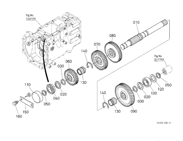

I found it. Its on the exploded diagram for the countershaft.
Is part # 110 in the image and is a bearing cover.
