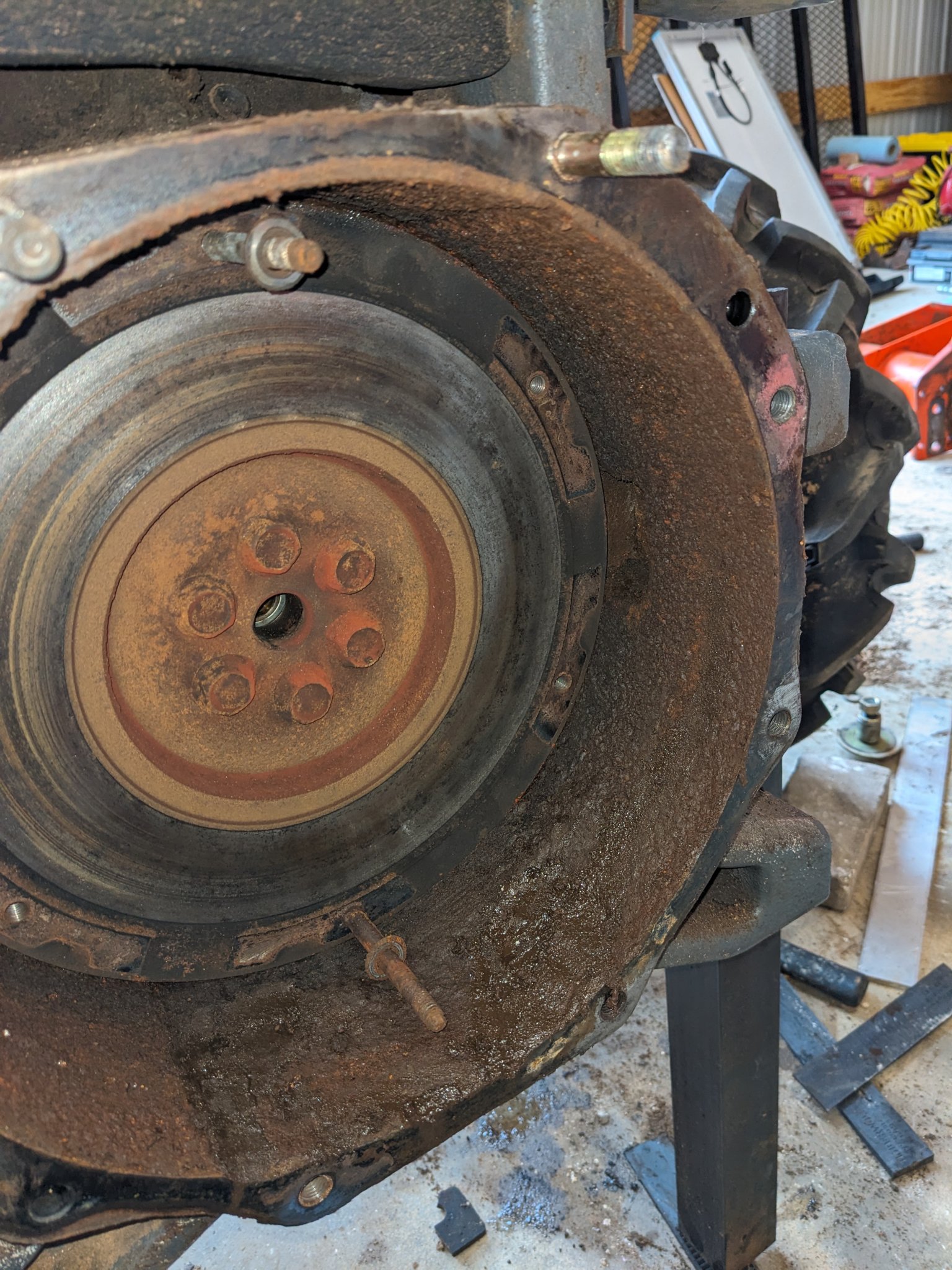

I have a 2007 L3400 with about 800 hours on it. I bought it used ~2 years ago and have only put about 50 hours on it during that time. This is my first tractor.
Everything on it was working fine until about 6 months ago when I realized the PTO clutch would not engage. I did the adjustment in the manual where you adjust 3 bolts. That worked, however when I was doing that it seemed dirtier and rustier in there than I was anticipating.
Shortly thereafter the drive clutch started slipping badly. I adjusted the backlash on the pedal. I decided to try to replace the clutch myself. Splitting the tractor went relatively easy aside from a few of the bolts being quite difficult to access.
I split it open and was shocked how it looked. My friend who was helping me agreed that it wasnt great, but seemed to think "thats about what i would expect from a 17 year old tractor. " Surely this isnt normal, right?

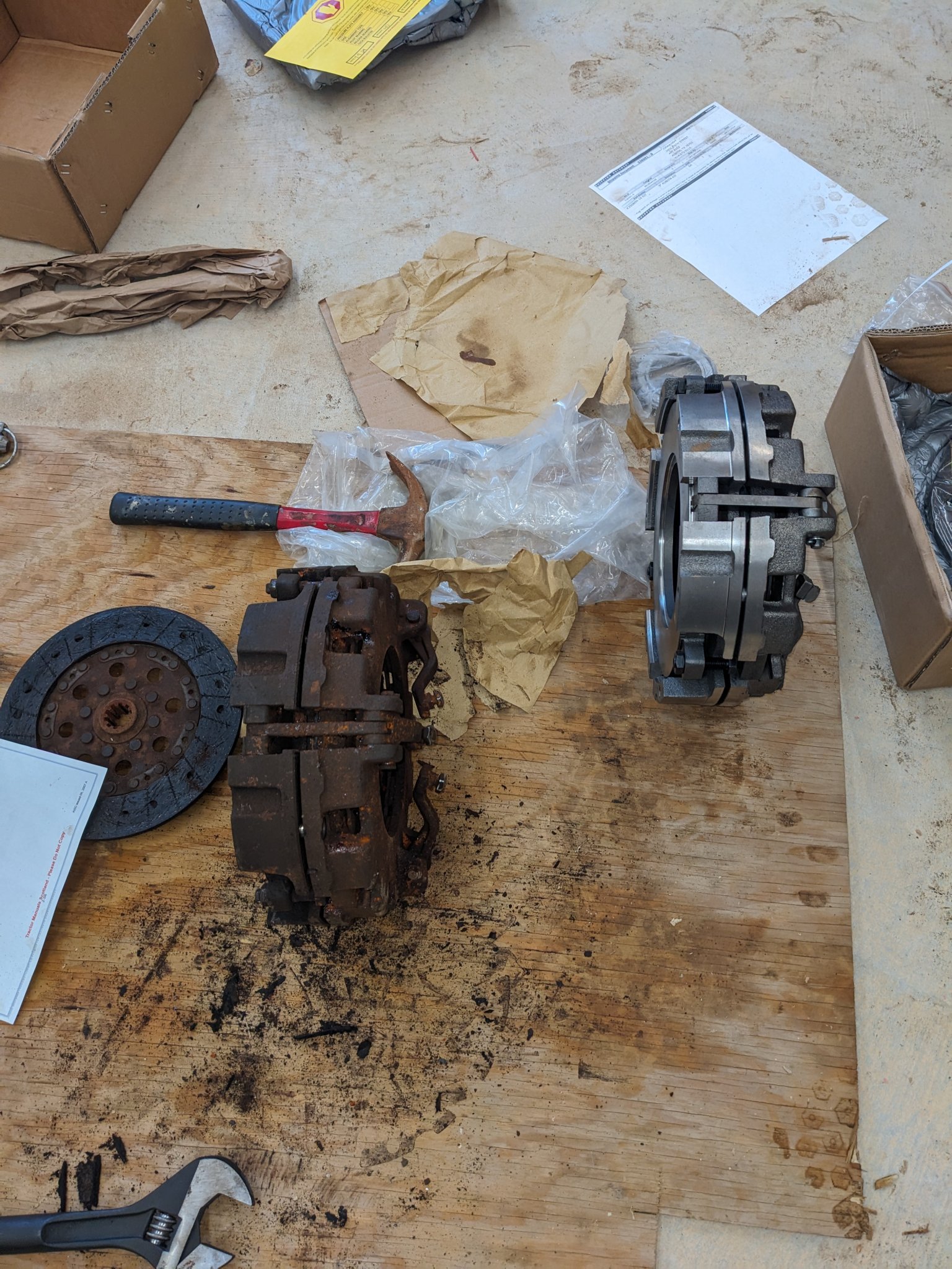

This is a side by side of the old vs new clutch assembly.

I've never split a tractor, but I've seen quite a few restorations on YouTube of much older tractors than yours, 30 to 70 year old tractors, and can't remember seeing anything like that in terms of rust.
Could the tractor have been partially submerged in water at some point? Is there an obvious way for water to get into the clutch housing if the tractor were parked outside for years? The steel looks normal at the mating surface of the two halves.

I think this is a key question. Had you been the only owner of the tractor, likely not to be expected the way your photos show.
BUT, you are not the only owner, and when buying used, you never know for sure what you are getting.
All you know for sure is what you see when you have a problem is what you have...not sure how to determine the reason with any certainty.

I bought it used from the Kubota dealership. When i bought it the tractor had a new seat and new tires. I didnt think much of it at the time, but my father later said that it was odd that a tractor with only 750 hours on it would need all new tires. My interpretation of this is that it likely sat outside parked for a very long time.
There is a drain plug in the bottom right near the mating surface of the front and back half. There was so much debris in there that this was entirely covered, which likely accelerated this. I'm going to take the flywheel off, hopefully what is behind there isnt quite as concerning as what I saw here.

Sure looks like it sat in water…maybe look around other “concealed“ parts of the tractor for signs of a waterline or other signs someone replaced damaged electronics or similar.
Check that seal on the spline shaft while you are there…I wonder if there was any water that got past that into other parts of the engine…

Going by even distribution of built up rust mixed with clutch dust, I believe you will find evidence of coolant leak after flywheel is off. Most likely freeze plug.

Yep…. plugged drain hole kept condensation and high-humidity in there. Wire brush… Ospho… and keep that drain open. Grease the splines and a new throw-out and pilot bearing should solve it for you. Don’t sell it after all THAT work :ROFLMAO:

You have an unusual amount of rust for a 2007 model tractor. Perhaps you live near the coast and salt water has done it's job on it. (Look at that hammer head!)
Here's an example, this is a 1980 tractor. I bought it from a dealer (Bobcat, and this is a Deutz tractor someone traded in). I couldn't get the PTO to work. I eventually separated the tractor and discovered a part of the throw out bearing was missing and wouldn't allow the second stage to engage.
Nothing like what you're seeing.

Thanks for sharing those pictures. That was what I was hoping to see in there.

You need top remove the flywheel and the bellhousing to inspect the freeze plugs, they are hidden.
I'll bet you have one seeping.
If they are all good, clean all the rust and debris off the inside, then use sealer on all mating surfaces, and make sure the split pin drain is clear and free.

Here's some pictures of what happens when a freeze (behind the bell housing) plug leaks.
I'll see if I can find the pictures of the freeze plug.

This is a freeze plug on the back side of the engine. Moisture seeped out and down into the bell housing causing all the damage in the other pictures.

The OP's tractor looks a lot worse than the photos you show. Intuitively you'd think that if engine coolant leaked past the freeze plug that the corrosion inhibitors would provide some amount of protection. But I suppose that if the coolant is water, or a lack of maintenance has diminished the beneficial properties of the coolant, that would increase the chances of a freeze plug leaking, and there wouldn't be much in the way of corrosion inhibitors present in any coolant that gets into the bell housing.
Is the inside of the bell housing painted at the factory? I would think that it would be.
