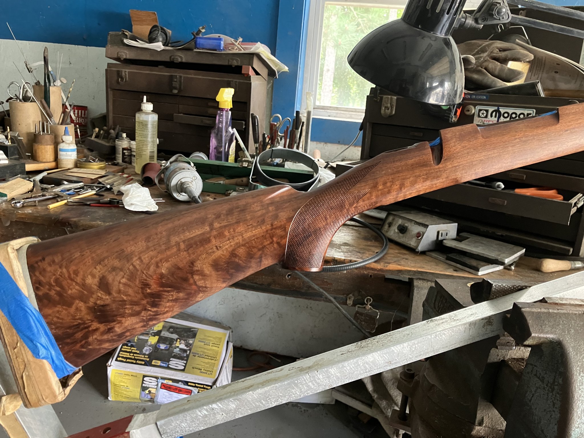

I had gotten pretty good at hand checkering back in my gunshop, gunsmithing days. Recently I had decided to rework my second built rifle stock when I attended Colo. School of Trades, circa 1981. Part of the course requirements was to build a minimum of 3 rifle stocks from blanks, all hand inletted, no rough turning or duplicating allowed.
The rifle in question is a Interarms MK10 barreled action in .243 Win with black walnut stock. Like many inexperienced stock makers I left too much wood though out. Fast forward 40 years and I decided to slim the stock down and re-checker.
This is the first panel which would not pass muster if I was charging a customer. I knew I was out of practice, its been 23 years since I did any gunstock checkering, but Jeez, I was having trouble getting even spaced lines with my vintage MMC power checkering head. Come to find out a special tiny screw that holds a miniature bearing had come un-staked and allowed the carbide cutter axle to disengage from the bearing. After fixing the problem the next panel is coming along much better.

Brother - you get an A+ for the grade - looks awesome !

Ken, I know nothing about gun stocks, what i do know is that for several years what you show in pictures of work done, it is always detailed and excellent. Your design and build of the mechanism to get you on your tractor is tops though!!!!!

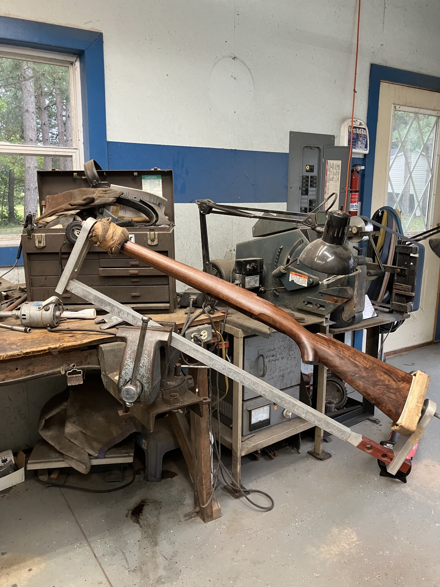

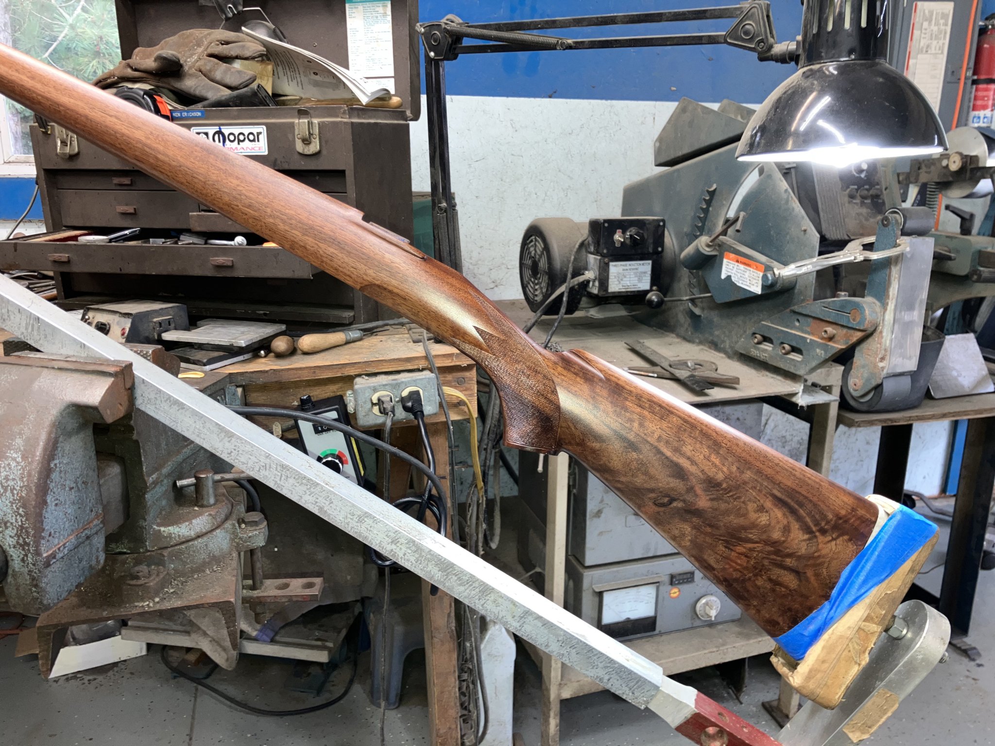

Side two of the grip is done, went much better than the first. I am glad I can not see both at the same time! LOL. Not sure if I am going to do a wrap around on the forend or two separate panels.

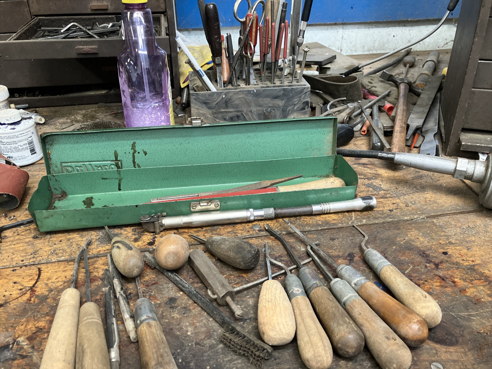

I had stippled stocks back in the day for a few customers. One in particular comes to mind. A lady was involved in the summer biathlon which emulates the winter biathlon but instead of cross country skiing between stages the competitor runs. Her first purpose built biathlon rifles had no checkering or surface treatment for improved grip. Stippling was an economical solution for her.
Unlike my single point stippling tool and overall pattern yours sounds very interesting! I would love for you to share any pictures you may have! 😀👍
