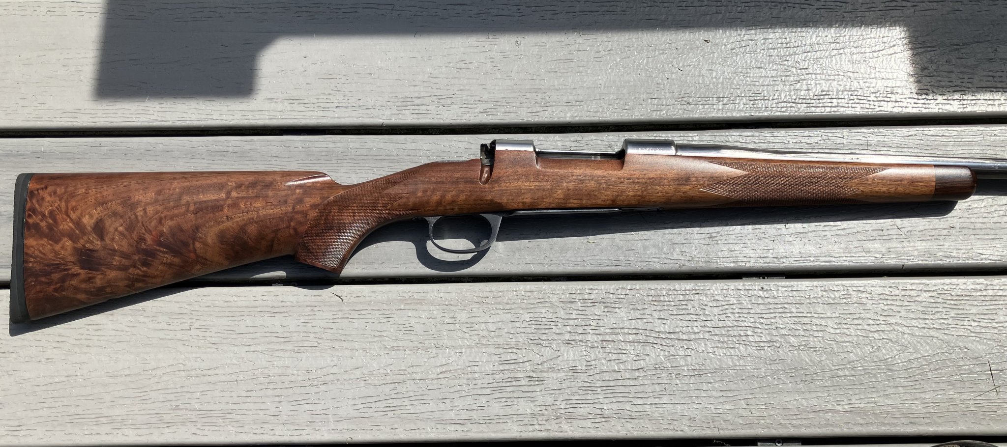

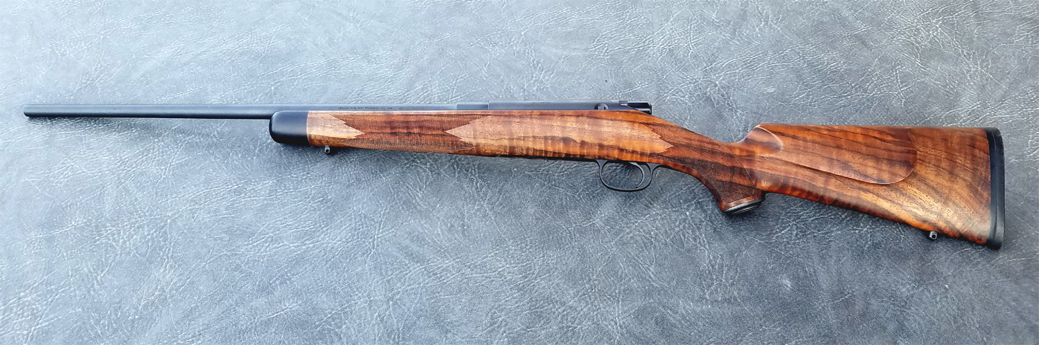

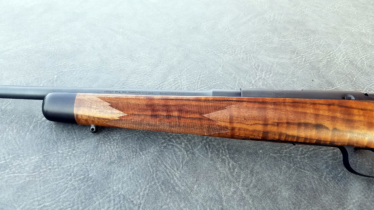

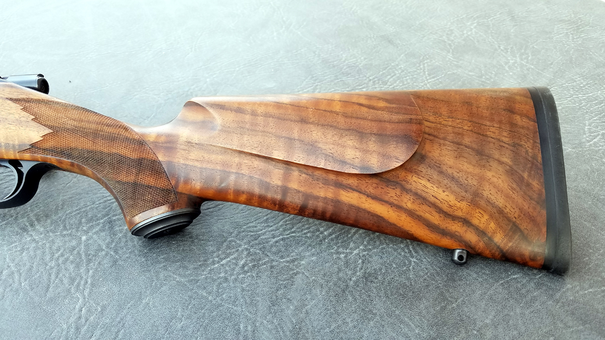

Checkering on my 243 is done and ok satisfied with my job. No doubt the last 22 or so years since my last checkering job took a toll!
After I get the metal work done and final assembly I will take some better pictures and post them up.
Last picture till then. Thanks everyone for the very kind comments, they did not go unnoticed and appreciate them all.

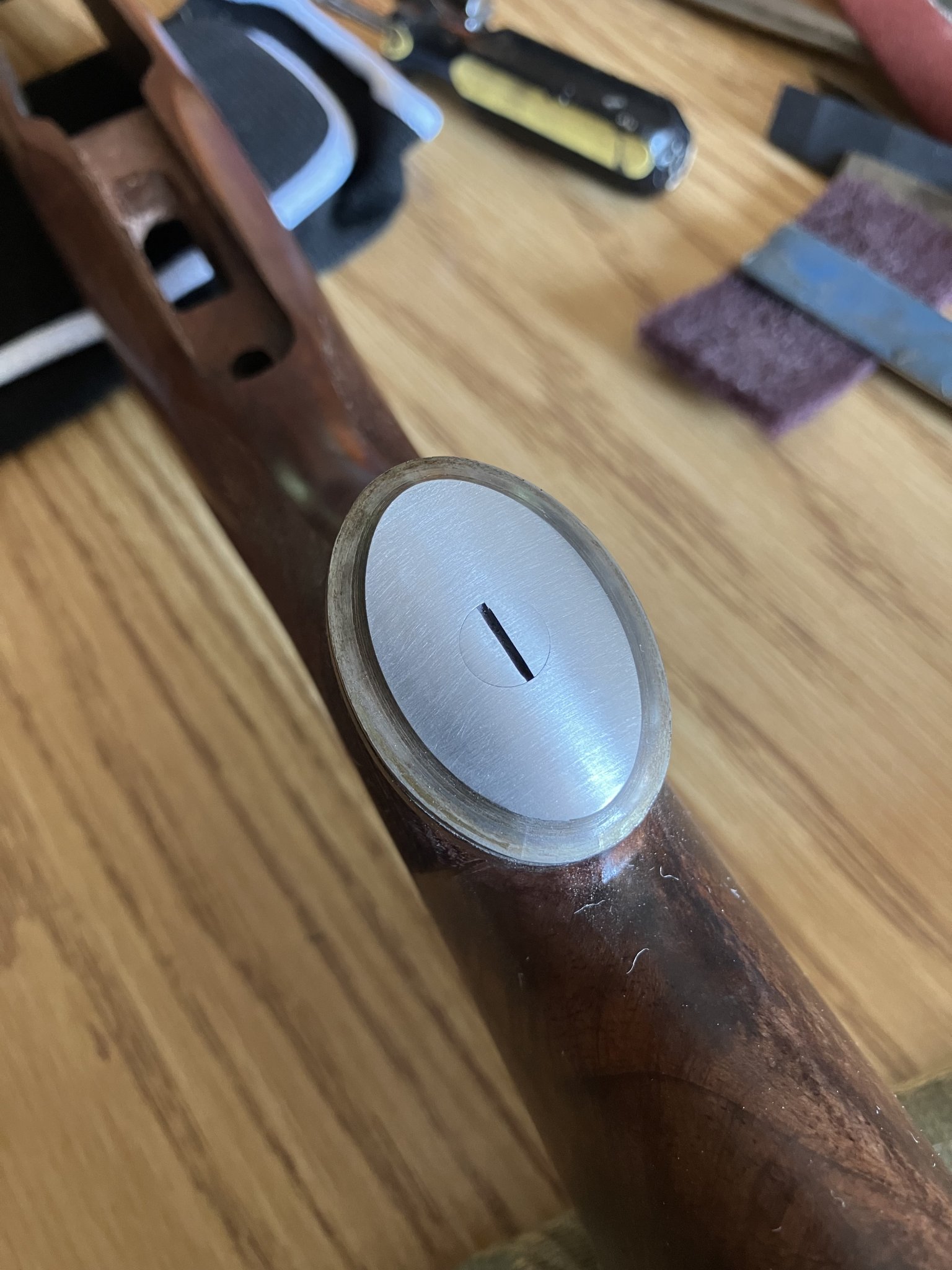

I thought some might find this a bit interesting.
When I reworked/thinned this stock down I removed my original rosewood grip cap and used a Jerry Fisher steel grip cap. As is the norm with good quality/handmade firearms the attaching screws are often "clocked" to align the screw slots.

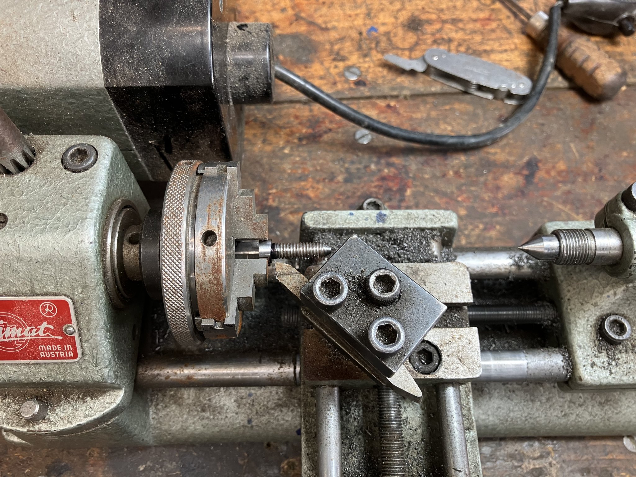

This screw was off by a 1/4 turn, 24 TPI screw , so I know I needed to remove about .010 from the shoulder of the screw head to get that extra 1/4 turn. I say "about" because there is always some wood compression in the threads etc when running a screw like this in and out durning the fitting up process. I keep the screw slot perhaps a degree or two from being perfectly inline with the bore to account for any further compression or wood shrinkage.

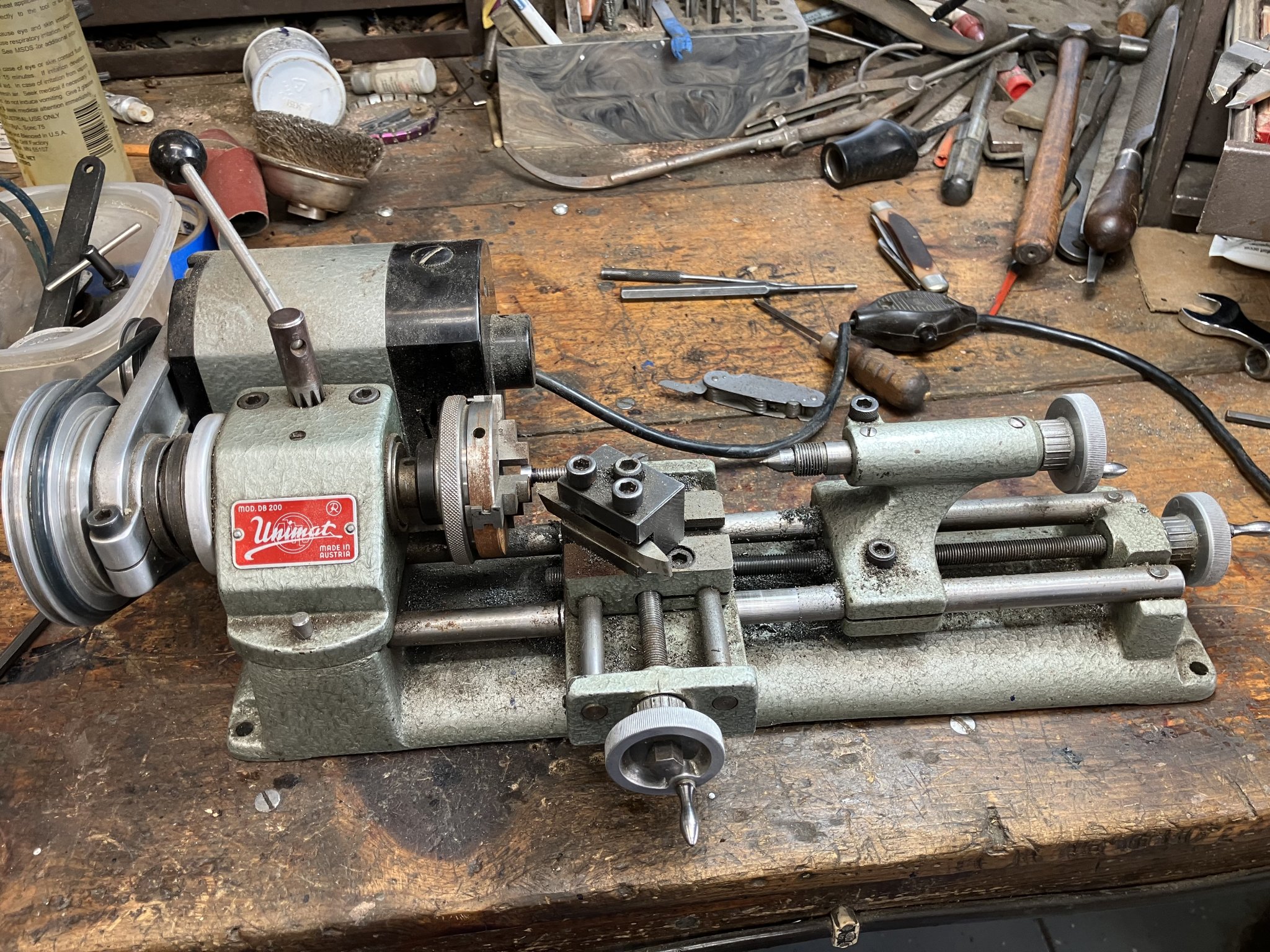

I could have counterbored the grip cap that extra .010 but it was just as easy to put my Unimat on the bench and cut the shoulder of the screw.

Yet on
Then there's the tolerance on the threads too. .010" assumes that the 24 TPI screw is exactly that, which it probably isn't.
Regardless, this is great work and one more example of the difference between production rifles and custom rifles.

And after the screw head is contoured flush with the grip cap something like this should be the result.

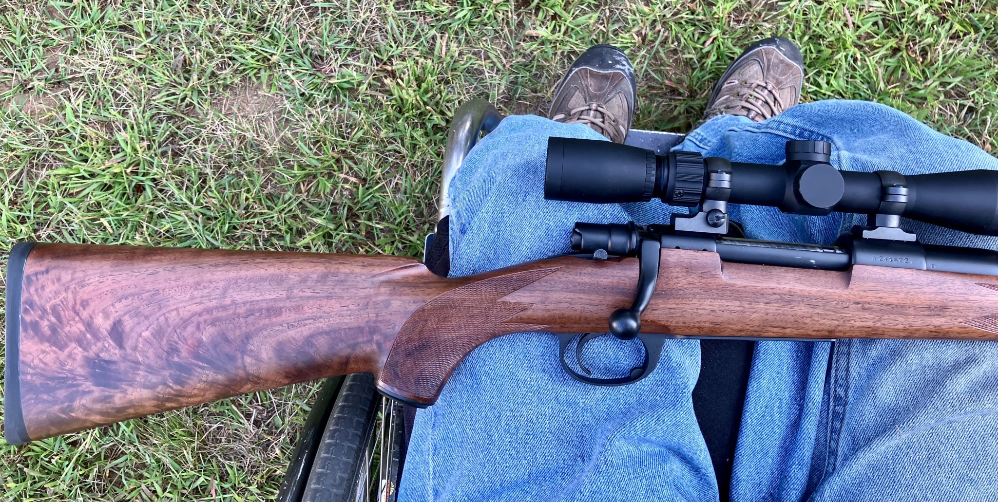

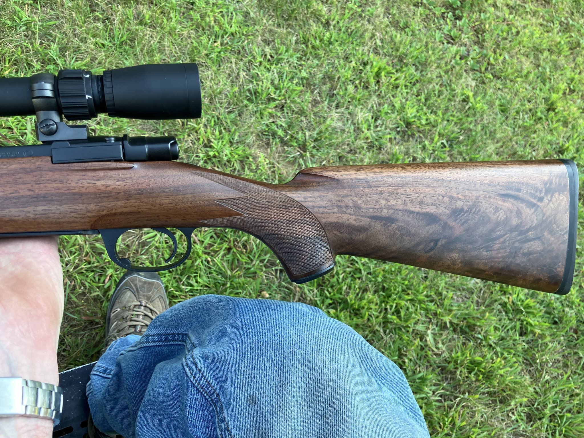

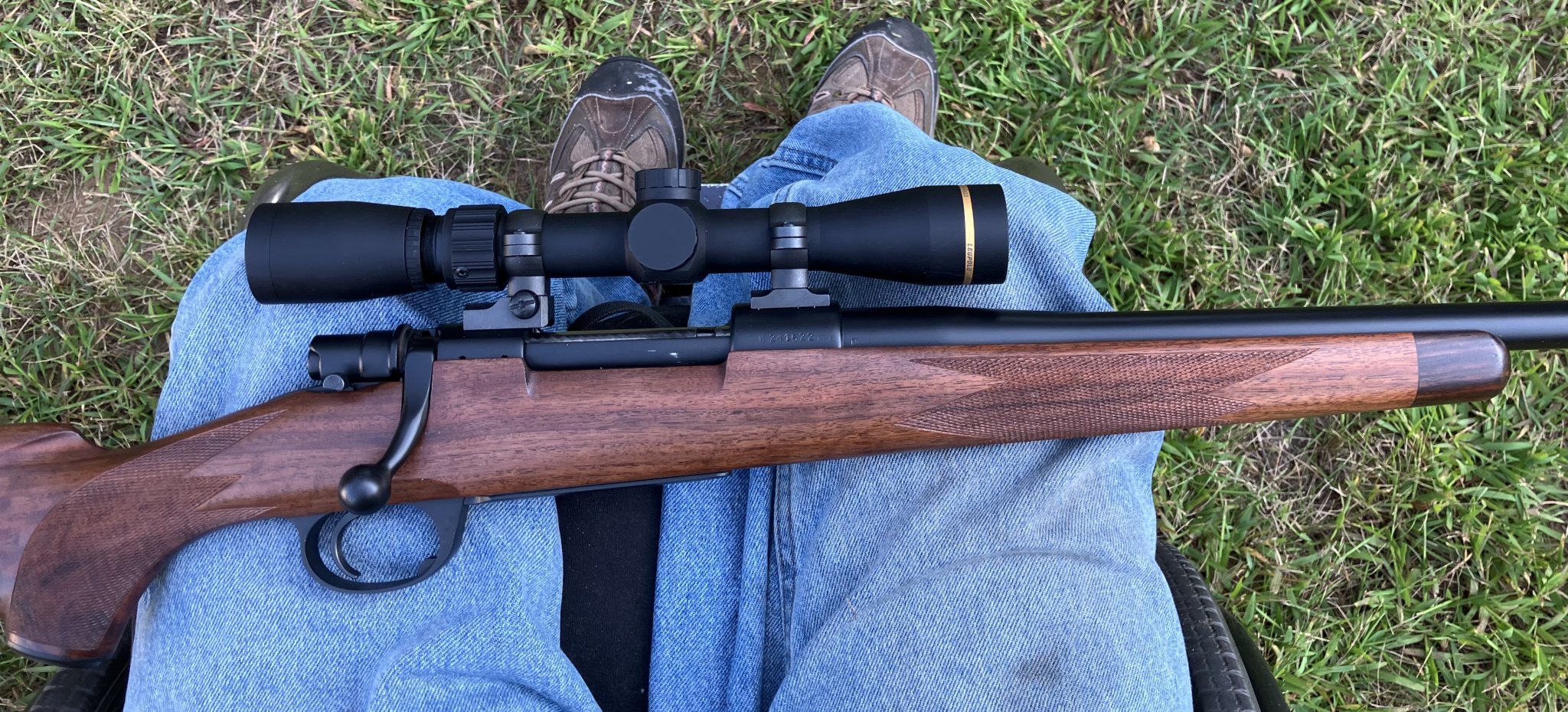

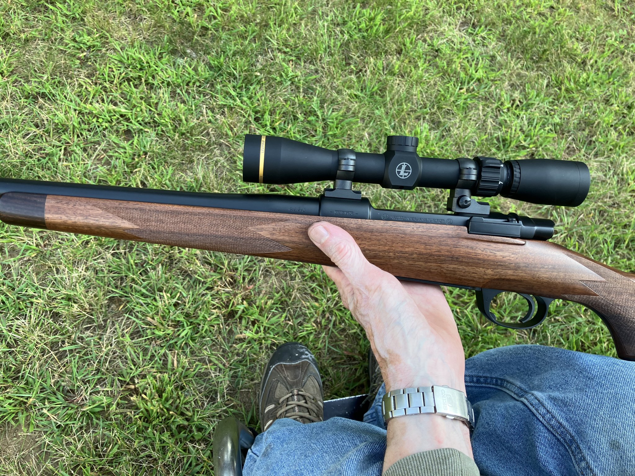

Well,
It is as ready as I am going to have it before taking it to my range and sighting it in.
It is going to be interesting how well the "can in a can" Duracote semigloss black finish holds up. Unfortunately there is no one in my area that salt blues anymore and its been 23 years since selling my hot tanks. If this does not hold up , after the deer season I will disassemble , strip the duracote off and send it down to a gunsmith friend of mine in MO that blues on a regular basis. My own fault for not getting on this project sooner.
I am actually really happy with the finish as it stand, as long as it holds up under normal use. The semigloss goes very well with the matte finish Leopold rings/bases and 2 x 7 Leopold scope.

That’s a beaut! Great job. Good call on the gold ring too! 👍
