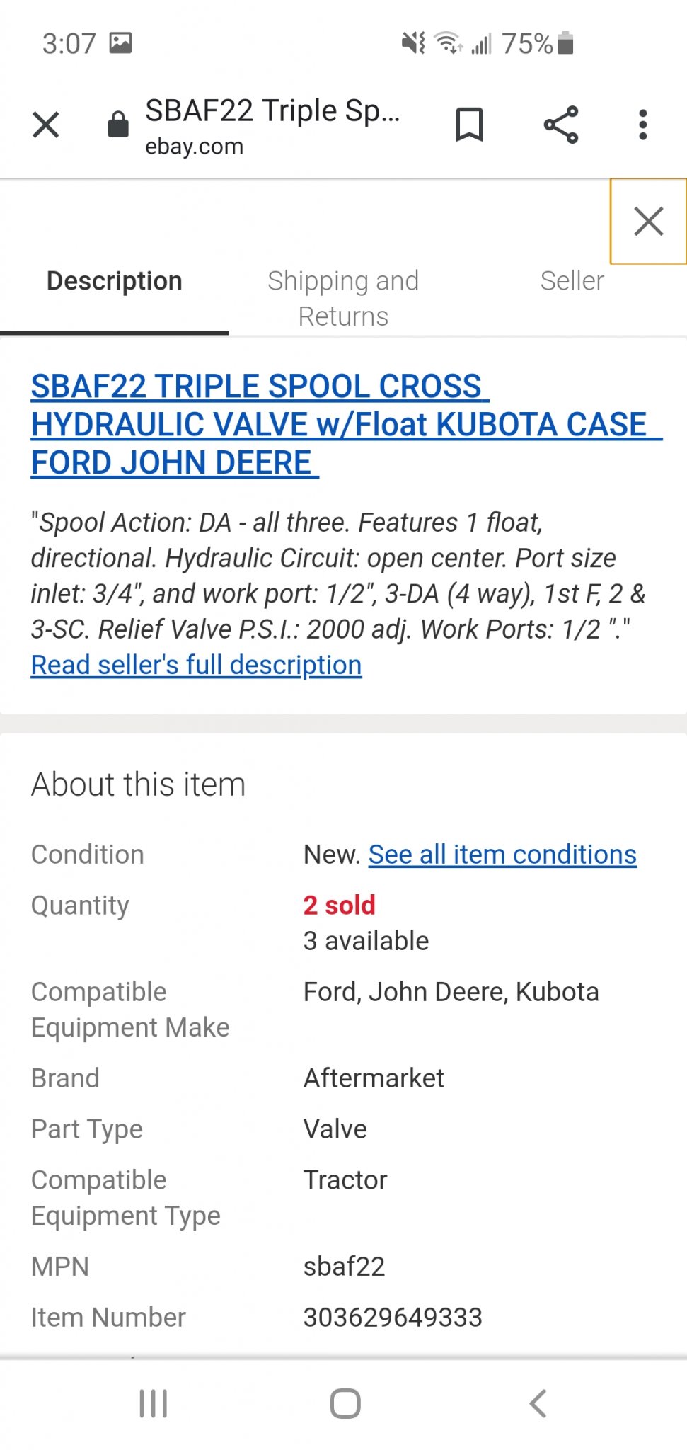

Hey guys new to the forum here, picked up a kubota b7100 this fall and made a custom snowblade for the front that mounts on the fel. I would like to make it hydraulic tilt for it but don't have anymore ports. What would be my best option here i was wondering about changing the spool valve to something like the one in the attachment but not sure of the compatibility. New too the tractor seen. Thank's Curtis

That valve will work if it's an open center (OC), and has power beyond (PB).
Some valves require an adapter to make them have OC or PB.

Sorry old and tired I answered your question wrong, yes it does have open center thats the specs in the picture, So would i essentially put a tee in instead of having that valve then? And there isn't a block in the front on this one. That would be a big bonus not having that valve to mess with!

The 2nd valve you listed is too big; capacity 30 GPM and (large ports) I/O ports 3/4" NPTF https://www.ebay.com/p/18028895623
The first one shown; https://www.ebay.com/itm/HYDRAULIC-LOADER-VALVE-3-SPOOL-W-JOYSTICK-10-GPM-W-FLOAT-SPOOL/274533781838
Is 10 GPM (closer match to your tractor) and ports that might connect without adapters (but you'll have to check that out - what your valve uses now...)

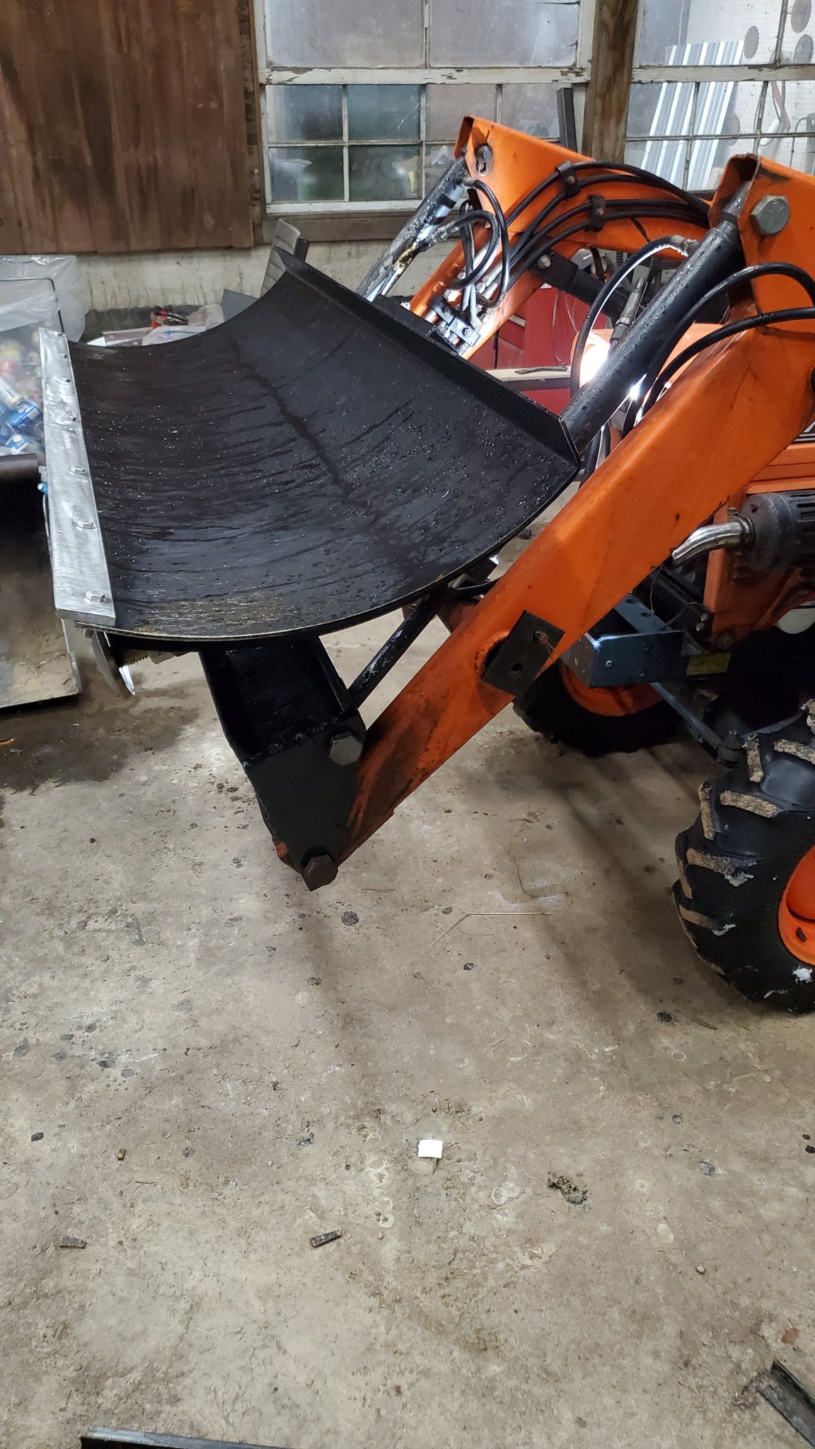

I wish I knew more too about the plumbing side im very green to that haha, I kinda just want to just change that spool regardless the float feature seems to be intermittent sometimes. Yah by tilt I mean side to side as I do use the curl pretty constantly while plowing, when I made the blade I tryed to make it so it can tilt pretty far back like a bucket. I'll take some pictures tonight of it.

Yah maybe have a quick connect on the one port if that would work. Here is a couple pictures of the plow I made tried to keep it from sticking out as much as possible and try to somewhat work as a bucket if I needed it too haha. Also found this blower down the road from me picked it up for 500 bucks needs a good clean but shes pretty minty 👍 off topic but any things I should look out for on this tractor?
