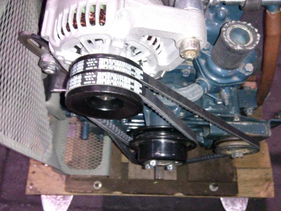

Since you have to remake/ alter the mount how about this?
Alternator:
http://www.ebay.com/itm/291131509604?_trksid=p2059210.m2749.l2649&ssPageName=STRK%3AMEBIDX%3AIT
Plug:
http://www.ebay.com/itm/Alternator-...Parts_Accessories&hash=item259f6fbeaf&vxp=mtr
This setup works well for the RPM range of the tractor.
And it is much smaller than the GM alternator, but yes a little more $$. ;)

Wolfman, Will that alternator be a good fit for a B7100 or is its size too big for a B7100-D retrofit?
Anyone happen to have the rough dimensions for this alternator ? :D
That one is a perfect size for the B7100 it just depends on whether you want to cut up the side panel to mount it or do like I did and mount the alternator on top. You will need a dual V belt pulley on the alternator if you go the way I did.
28,705
5,122
That alternator is really small about 4" diameter and about 6" long.
So yea I would say it's perfect for The b7100 change too. ;)
Thanks, Wolfman and Grumpy.
Do you happen to know if a dual V belt pulley will fit this shaft or do I need a longer shaft alternator of the same style?
Grumpy560
1979 B7100D 4WD with B219 loader/ 3 G6200 HST mowers/ JD 310D 4X4 backhoe
Oct 18, 2014
178
Estill Springs TN,
I paid $113.00 for my alternator and it came with a dual V belt pulley installed already.
