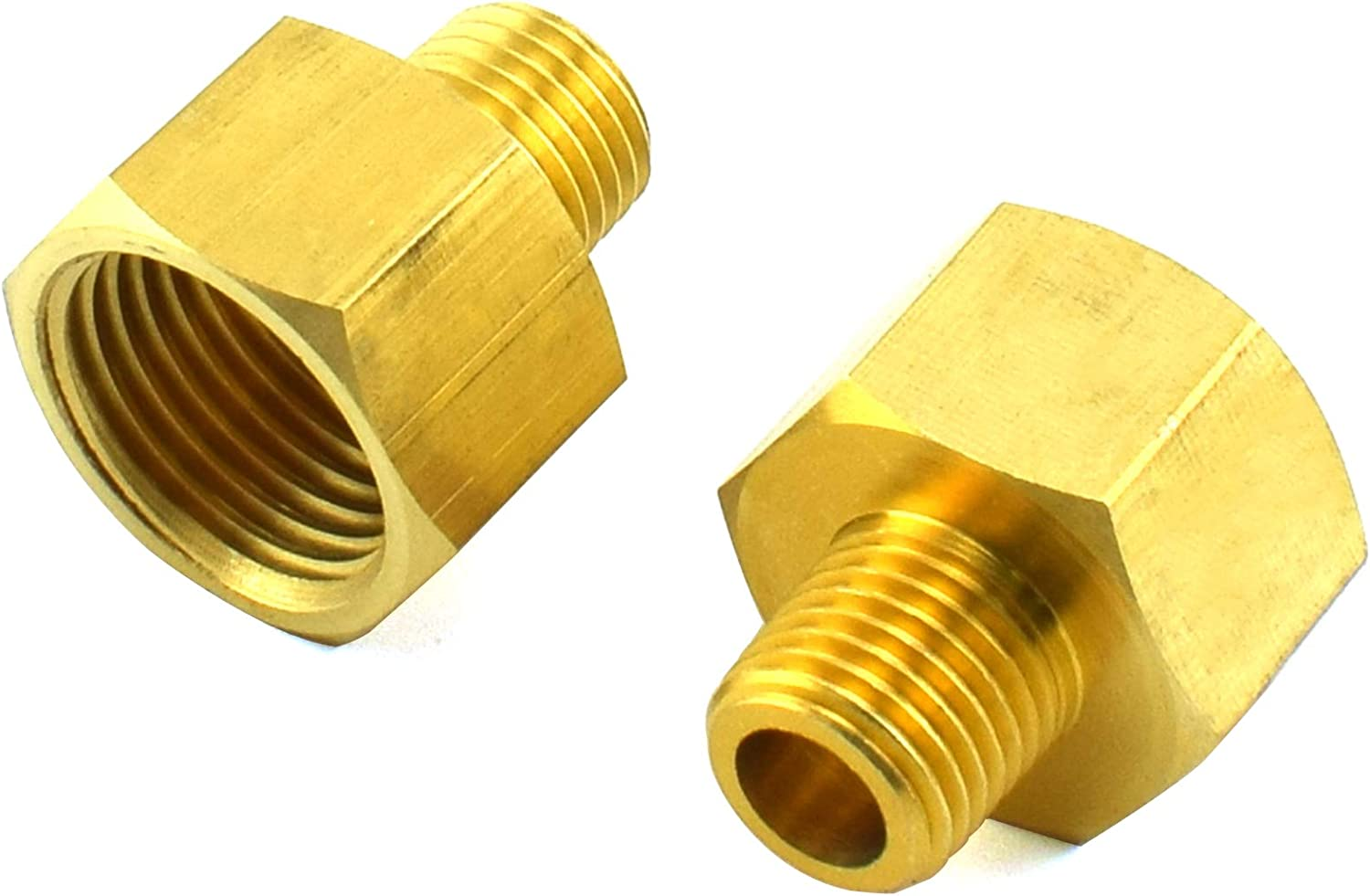

I purchased a used hla sb1000 snow plow with hydraulic angle. My third function has two male 1/4" quick couplings. The snow plow has 1/2" male quick couplings on 3/8 hoses. I purchased 2 kubota 1/4" style female quick couplings and went to my local hardware store thinking I would easily find a reducer but there was nothing there that would work. I need to go from the 1/2" male thread to the 1/4" female thread. so my question is can I use plumbing pipe or is there special fittings to handle the pressure? will brass or galvanized reducer with a 1/4" threaded nipple be ok if I can find it. ? Is there a reducer available that would make this simpler? Just to make sure the male quick coupling is .800 " across the top which I think makes it a 1/2" coupling. I would assume that also means 1/2" thead. I know nothing about hydraulics. thank you

Maybe?? I know of at least 2 different grades of brass NPT fittings; low ~150psi and high ~3000psi applications. Without knowing working pressure for those pictured, safe answer is to use steel hydraulic fittings for your application. Surplus Center, Discount Hydraulic Hose or local hydraulics shop should have them for $3-4 each. HTH

Without knowing what thread you have on the hoses and QD's it's impossible for us to answer, but you want steel fittings for hydraulics, not brass or galvanized ones as they aren't rated for the pressure.

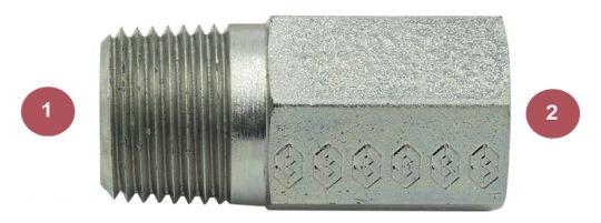

That won't work reliably on a 2000 PSI hydraulic circuit - get steel hydraulic fittings. I had trouble following your desription of what you need to adapt. Here is an adapter to reduce 1/2" male to 1/4" male as in your picture. If that is not what you want to do please explain what you do want to do.
Thank you that is exactly what I think I need
