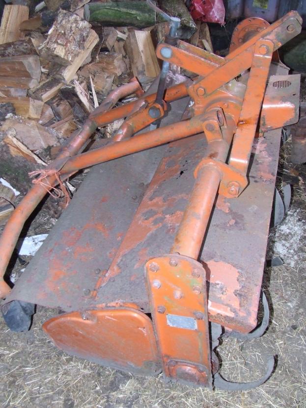

Hi,I recently bought a rototiller and second time using it the chain broke.There is no model no.visible,only10807 stamped on plate and 5708D stamped on gearbox.The tilling width is approx 4'6" and there are 30 tines,it looks very similar to the one in the video on the site.Problem with the chain is that nobody here in Ireland stock a chain which is 7/8" pitch.Can anyone give me info on chain or tiller please?
regards vino

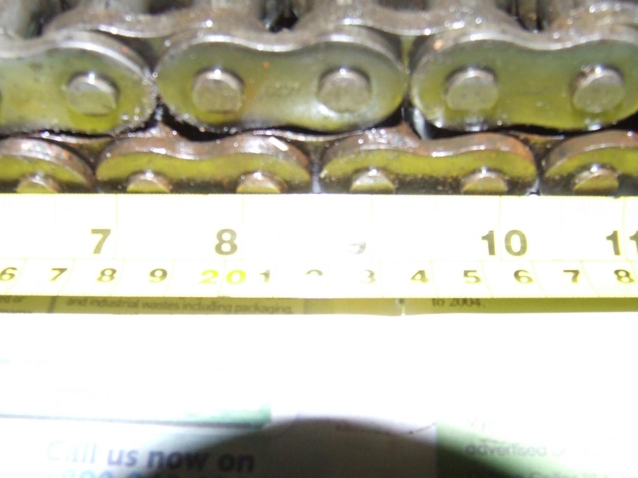

i,ve been a millwright and mechanic all my life and have never come across
any 7/8 pitch chain. for this chain to be 7/8 pitch it would have #70 stamped
on it. i,ll bet it has #60 stamped on it , 60 means six 1/8 =3/4 pitch. now a
well worn #60 chain streched out could measure 7/8. look at the side links
for the #

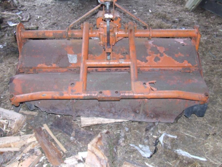

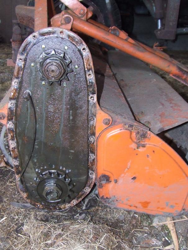

Here are a few photos of my rototiller inc.one of the brocken chain.If you can see the measuring tape it measures 7/8".On the outside link OCM is stamped,on the inside link 6E is stamped.The pitch is definitely 7/8".Anyone identify rototiller or chain please.

that is oddball all right. is there much wear in the chain. like push together and pull. hard to tell by the pic, the top sproket looks worn. i wish u luck
finding a new chain.

Not much wear in chain and chain was continuous,no connecting link.Any idea what model rototiller is?

You might look in to simply replacing the sprockets and the chain if you can't find a replacement. Sprockets aren't that expensive.
