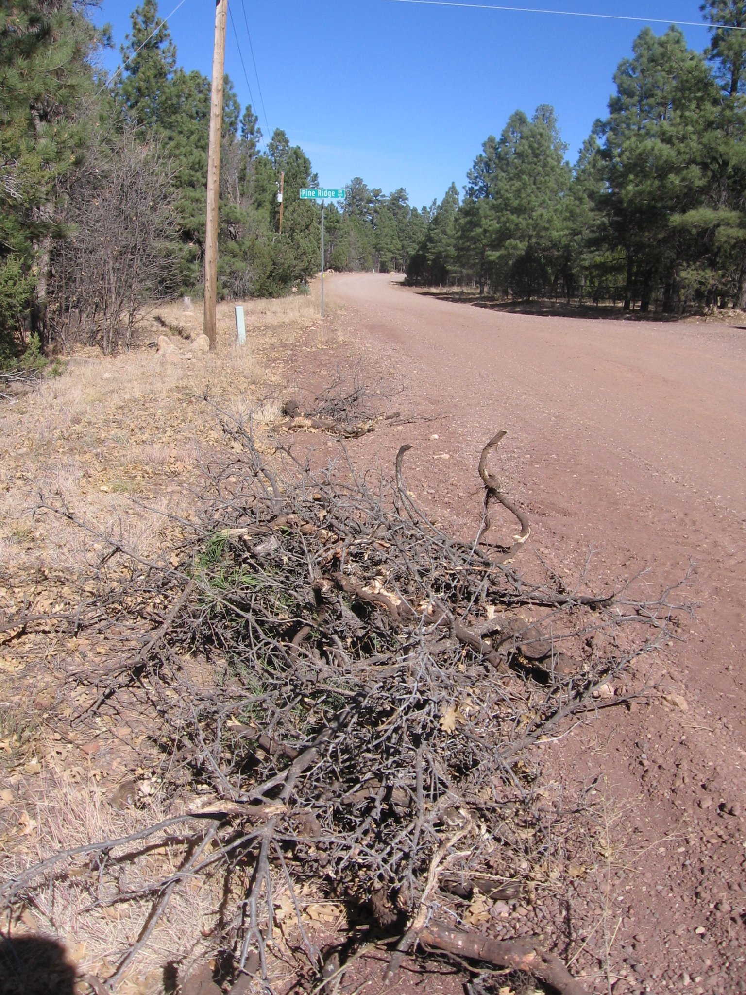

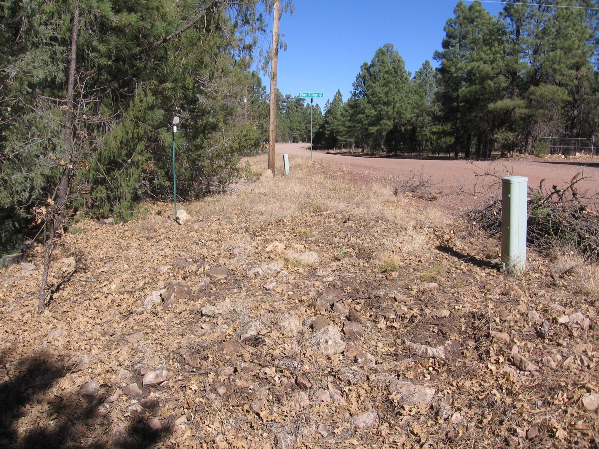

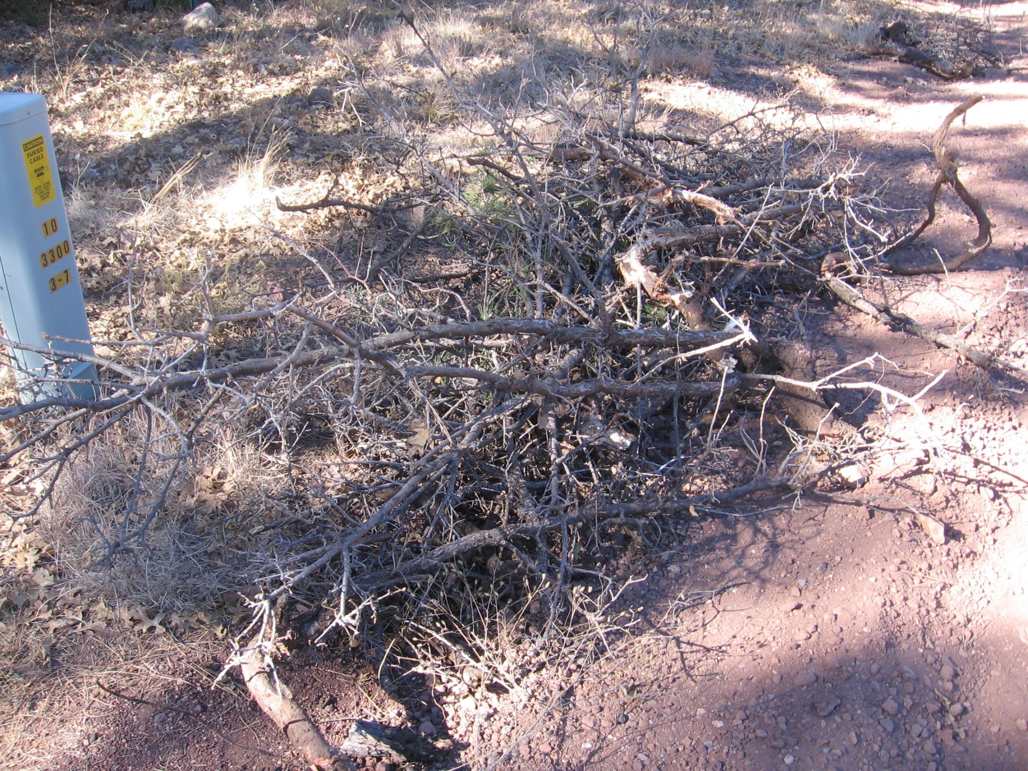

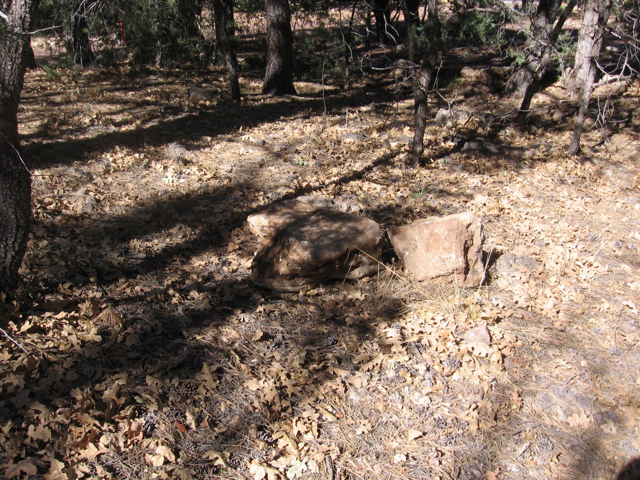

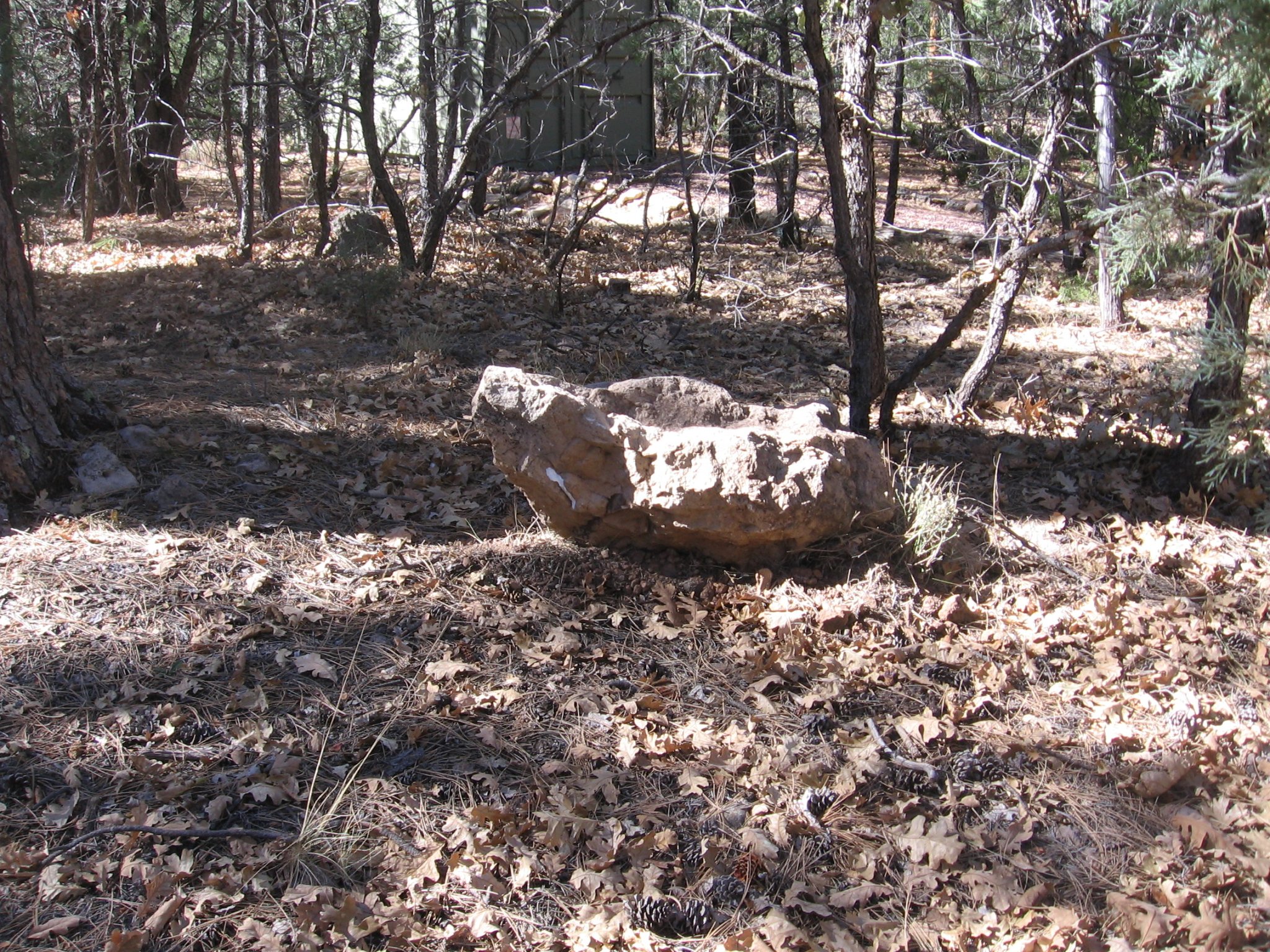

Working up at the cabin, I used the BH to pull out 30-40 Gambel Oaks, ranging from 18" to 7ft.
(forgot to get a before pic) This area needed to be cleared for a future fence line.

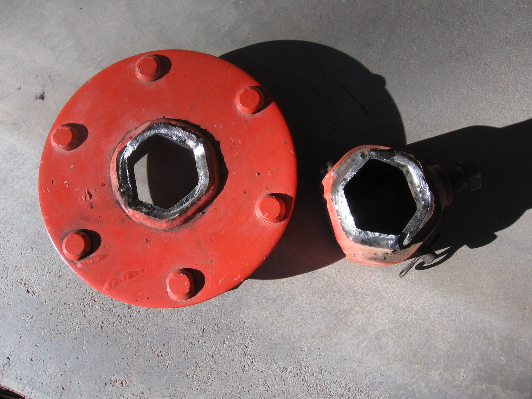

A quick look showed this:

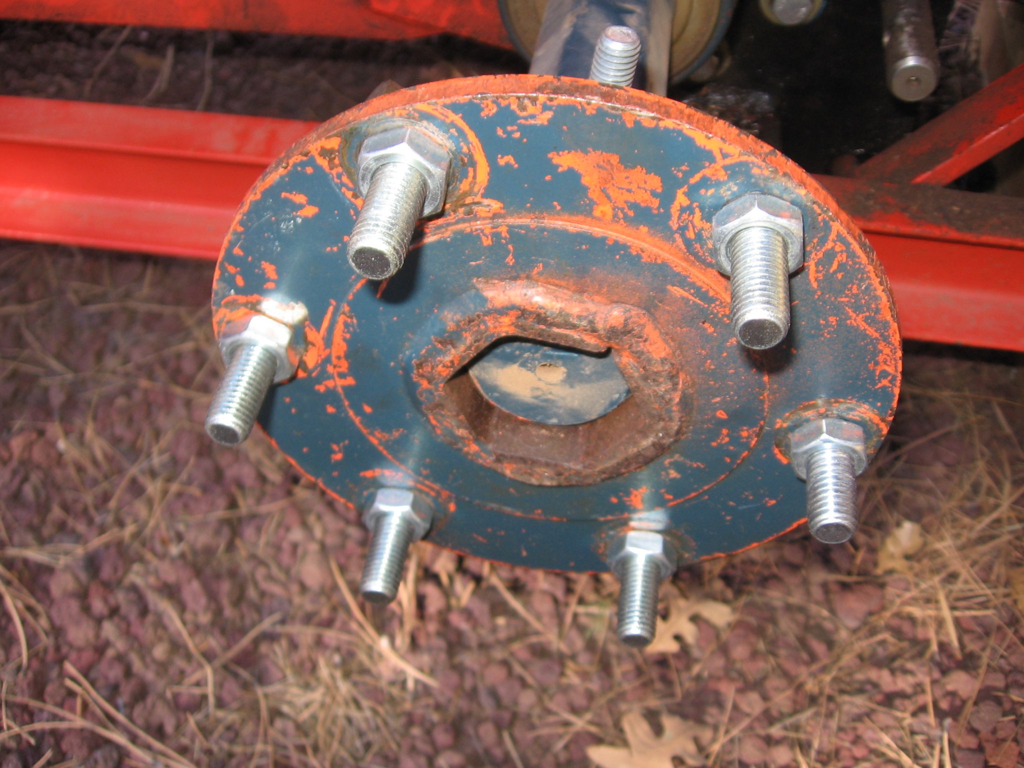

I used the outriggers to jack it up & block it with 4 x 4 & 2 x 4.
8,022
3,336
Thankfully, I had a couple of worn out, old hubs that NIW gave me a while back. Thanks Sean!
But they had no studs, and I have no hydraulic press at the cabin. So I found some suitable o-rings to center some 1/2"-13 bolts in the hub holes, and did a temporary fix just to get it put away.

I inspected the other hub with a mirror, and it looks good, but we shall see.
Hub appears to have been cracked for a long time (years?) before letting go.
Two new hubs on order.

One thing that seemed odd to me was that there was absolutely no indication of impending failure.
Everything felt (and sounded) completely normal. I had just started a slight right turn when it dropped.
Thankfully, I had no load in the bucket and was not on a side hill.
(both of which I had been doing 5 minutes previously o_O )

I had the exact same failure of the old style hub about 15 years ago. It was soon after I bought my first B7100. I replaced both hubs with the new style cast hubs. No problems since then. I still have that broken one somewhere in my collection of Kubota parts.

That hub looks like it could be welded back on, maybe for a spare.

you wouldn't believe how many times I've seen that happen. Dumb design, worked for a tractor but when you put implements and / or attachments on it, they break more frequently. The new hubs are a little stronger but still kind of a crap design, IMO.

Good ingenuity figuring out a back to the barn fix. If there’s no rust on the failed surface, I’d think it was pretty fresh. Doesn’t seem like it’s take too many rotations for the wheel to exit stage left once the hub failed.
