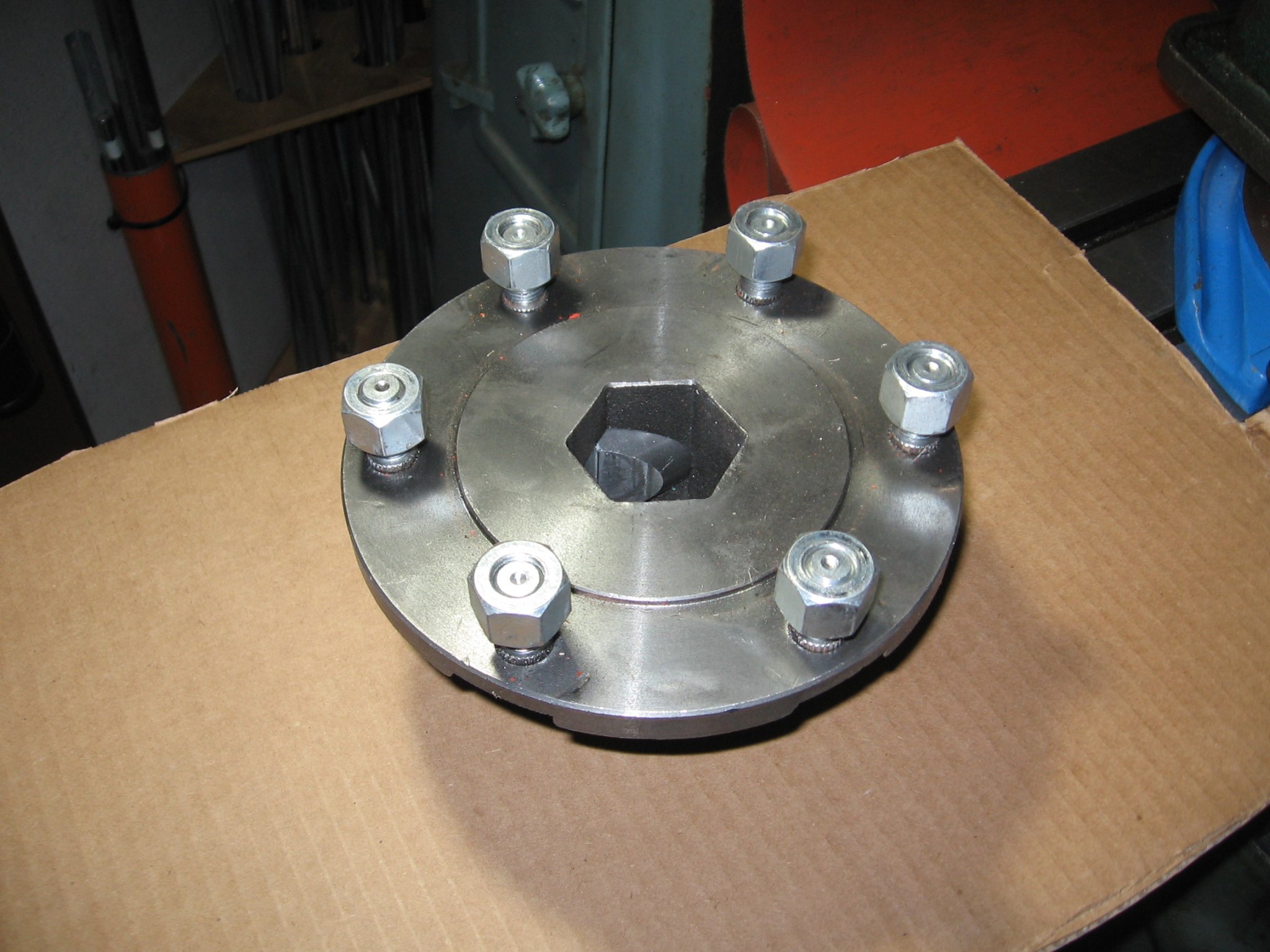

Got a chance to study the break a little.
First, to be clear, the weld did not fail- the steel of the 1/2 hex failed.
The weld probably caused a stressor in the 1/2 hex steel, as it fractured right next to the weld.
Tried to take some detailed pics, but not very successful.
In person, it is obvious that one half of the hex steel failed sometime ago, and hammered on itself repeatedly, producing a very shiny, almost peened surface. (the upper portion of the hex in these pics)
The lower half is definitely a much grainier surface, so I think the top half had been broken for a long time, and the lower half letting go caused the sudden collapse.
There was no rust anywhere, but this is Arizona.

I think your analysis is right on the mark! Stress riser over time was the culprit.
BX23-S,57 A-C D-14,
13,885
6,323
In looking at picture in post #5 , there isn't a lost of 'steel' where the hub 'disc' is welded to the 'shaft' In section. I'd want a nice thick fillet of weld between the two,or better an additional 1/4" thick 'disc'.

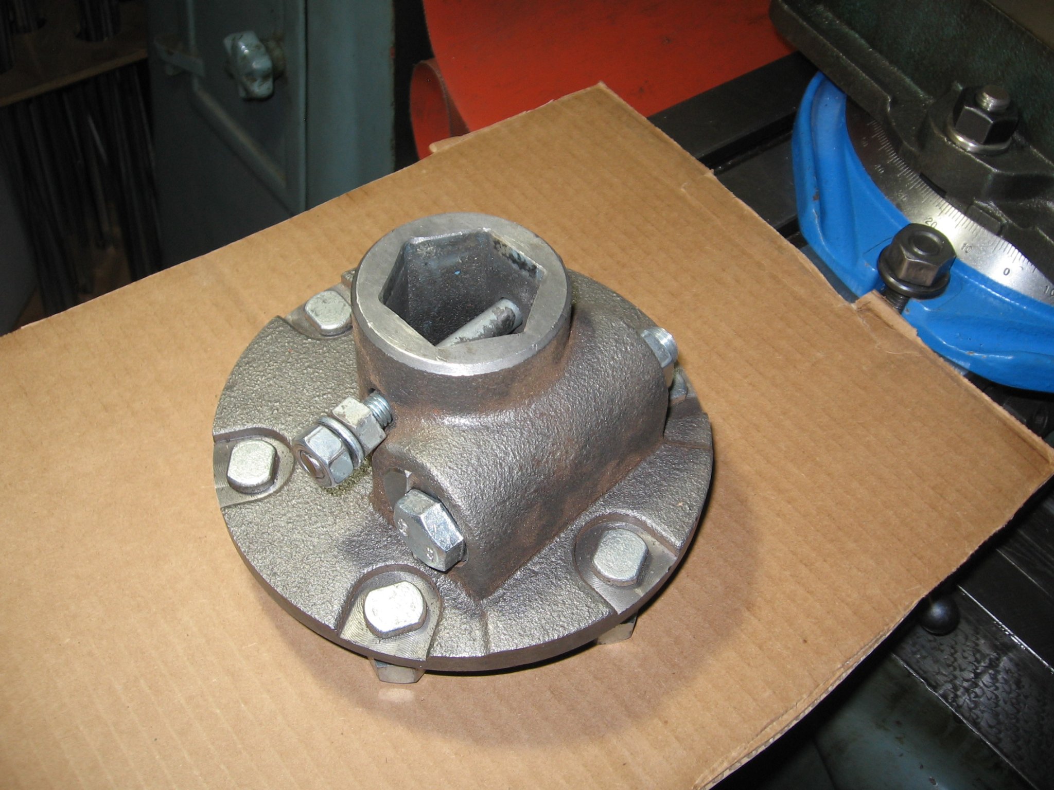

I did not want to re-visit this thread, but here we go.
These are the cast steel hubs I replaced the bad originals with.

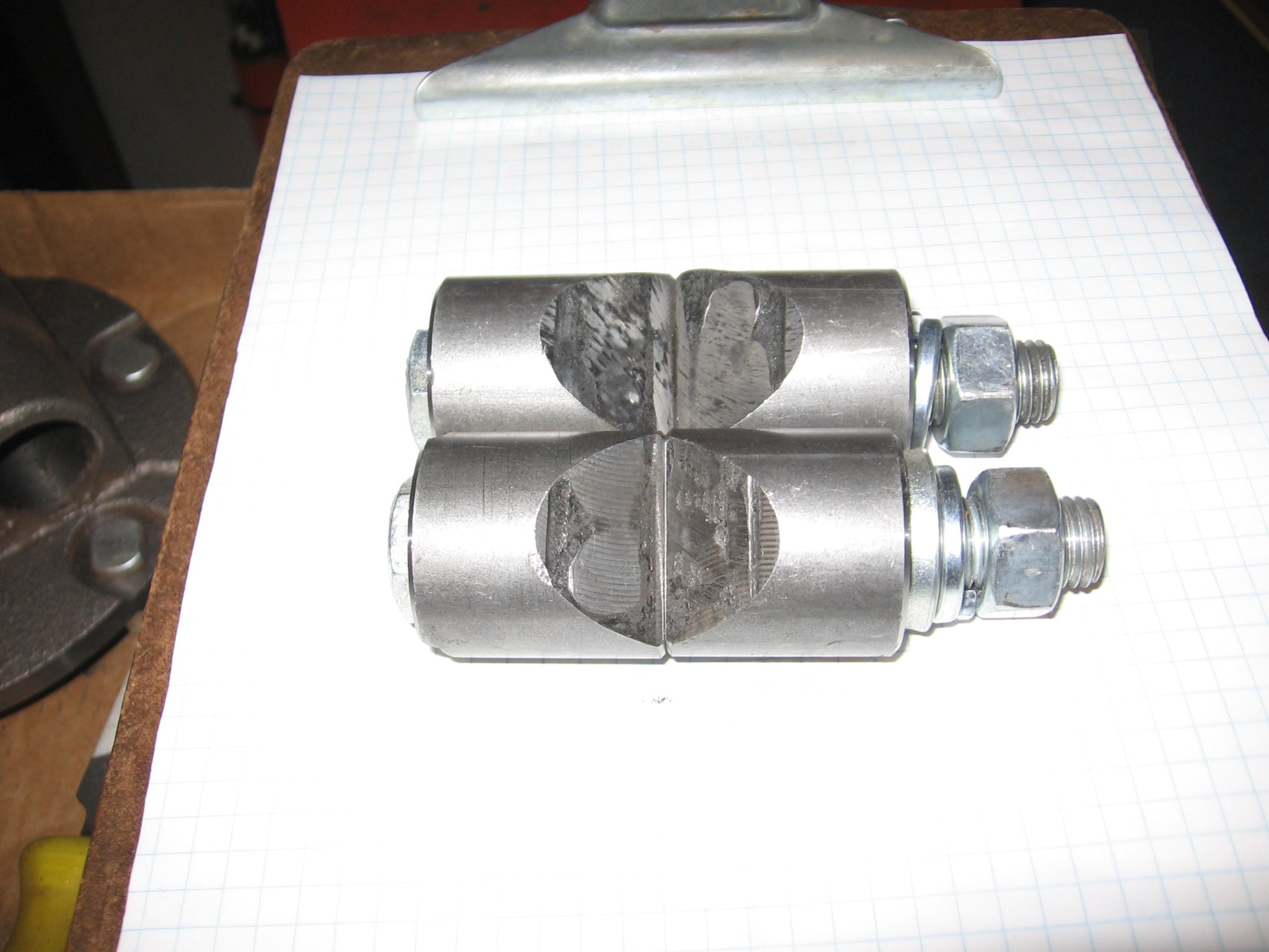

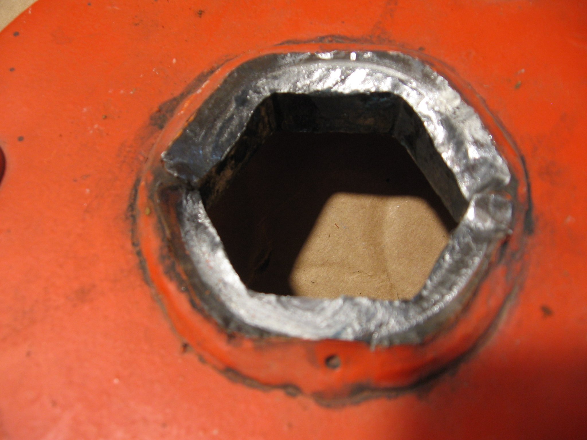

Everything seemed fine until this past week, when I noticed an occasional clank or clunk sound, coming from the rear.
Jacked the rear up with the outriggers & found play in the rear wheels.
Tore it down further and found this:
8,199
3,580
Further diagnosis found that the two halves of the clamping cylinder were bottomed out on each other, without applying any clamping force on the hex axle shaft. There must have been minimal clamping force on high points or maybe paint when I installed them, but they are loose as a goose now.
8,199
3,580
I took the hubs home, and used the lathe to face .125 off the hex clamping end of each half of the clamping cylinders, generating about .250 clearance between them.
I then added a .250 thick spacer & a thicker split washer under the clamp nut .
Hopefully this will solve the problem.
I will re-assemble next trip to the cabin.
3rd pic shows modified clamp (lower) vs un-modified clamp.
