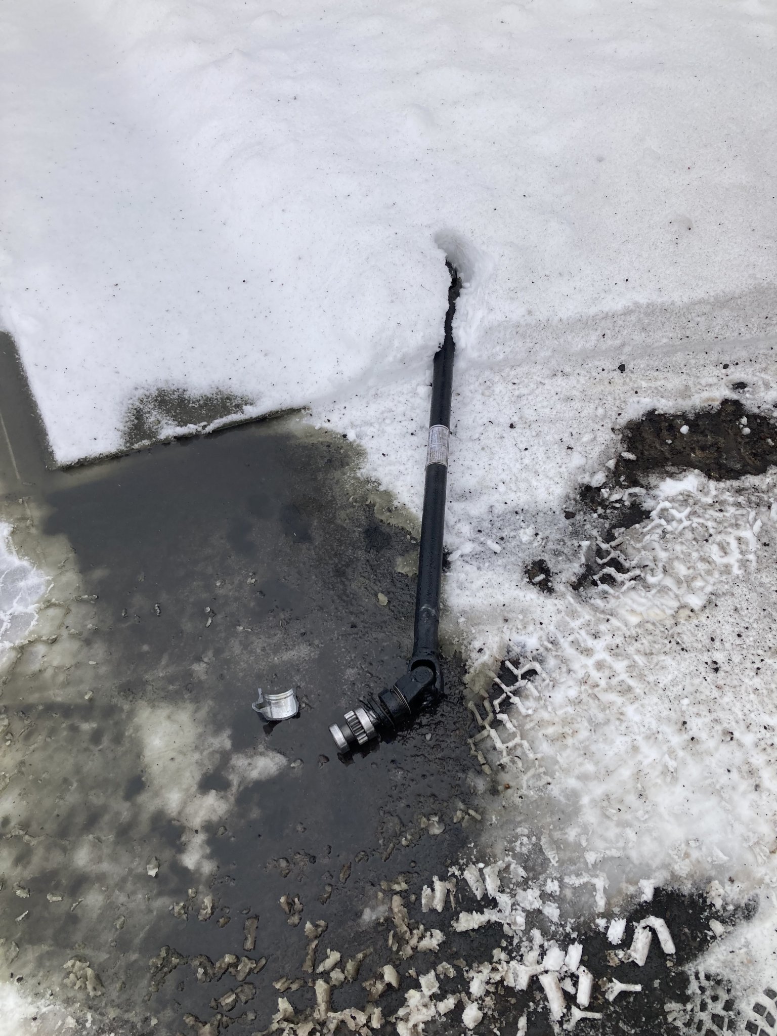

hmm.. shear pins didn't work !!
man it looks bad BUT needs what a case and a few little, $$$ parts ??
and of course new pair of pants !!!!
about $600 in Canadian bucks....though if reused parts, $500 for case only
I was expecting worse

The only good news is that he didn't spill a drop of oil. You have to wonder if the driveshaft was properly hooked up or not.

He lost the safety clip that holds the large rear pin in place that secures the subframe to the tractor frame. This put most of the weight of the blower pushing down on the driveshaft. 🤦‍♂️
If he’s lucky he can get by with a new pto case and driveshaft if it’s bent. $300 for the case and $400 for the shaft.
