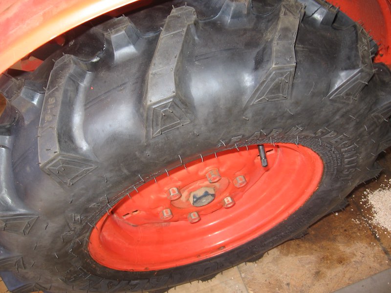

I have them front & rear on my B7100, and they are awesome. I pull stuff with these that would cause my old tires to just spin.
