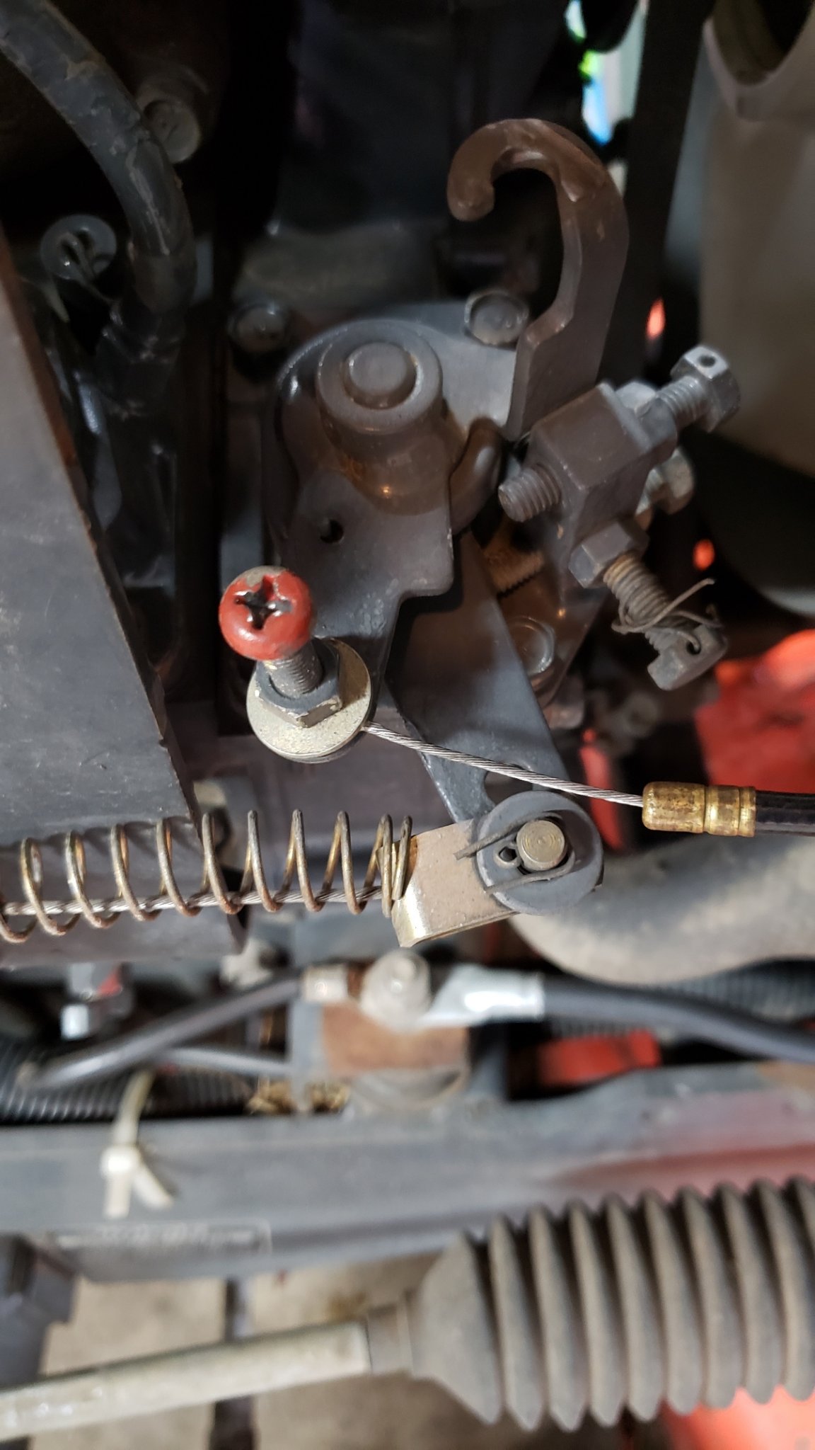

If the solenoid is broken not working just press the throttle lever on engine with finger to the rear most point. The lever springs to an idle spot so 1/4” past it is the kill.
