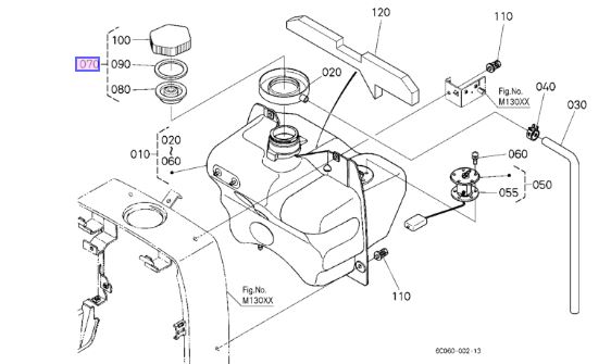

Exactly the same as a B21 inner fuel cap gasket, just looked at mine.
EDIT: Part 80 of your pic NIW, and exactly same as OP photo.
EDIT: http://www.messicks.com/part/6a100-54952/gasket-fuel
Same part no. for B7500, B7800, B21 and probably many others, no one ever looks in the cap or pulls it out!
The picture the original poster put is identical to the part on the fuel cap of my B7500.
At this point I'm about 95% sure you guys are right. Like I said in an earlier post -- Those drawings are sometimes more representational than they are photographically accurate. It looks to me like it's part #80 in North Idaho Wolfman's posted parts drawing ... But that drawing isn't totally conclusive because it's a representation of the location of the part not a perfect drawing of the part.
