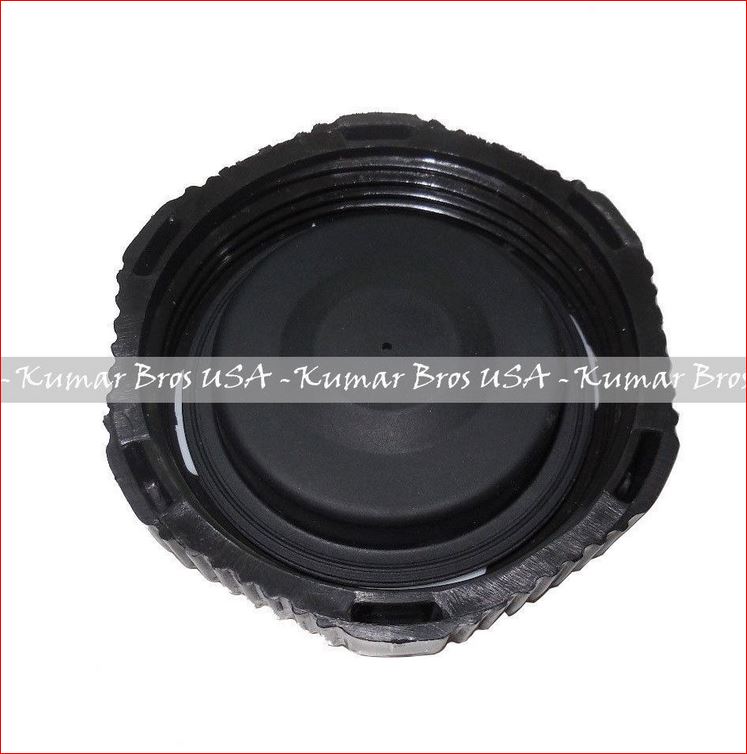

I found this picture of the underside of an OEM Kubota fuel cap from Kumar Bros. on eBay and this is definitely the piece that I found laying on the ground under the tractor. The problem wasn't finding a picture of an OEM cap, it was finding a picture of the UNDERSIDE of an OEM cap.

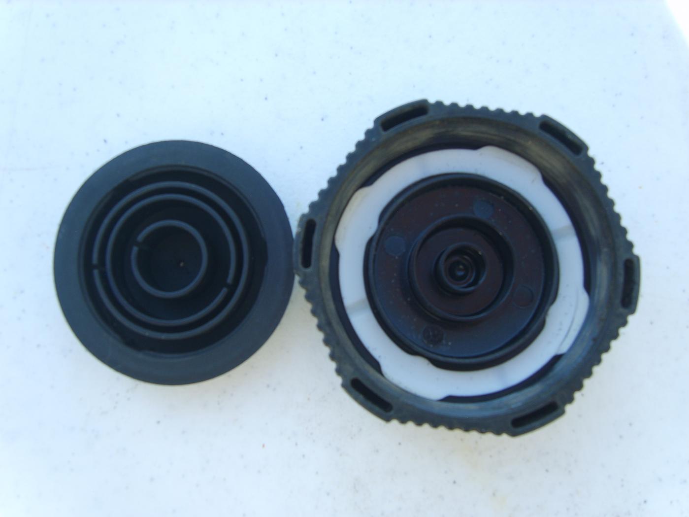

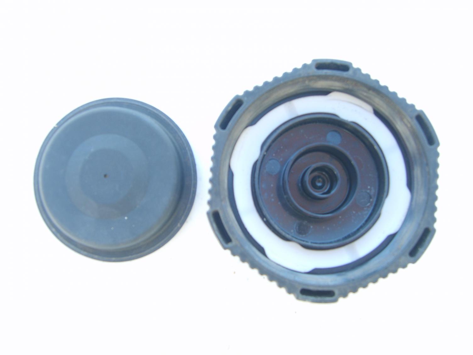

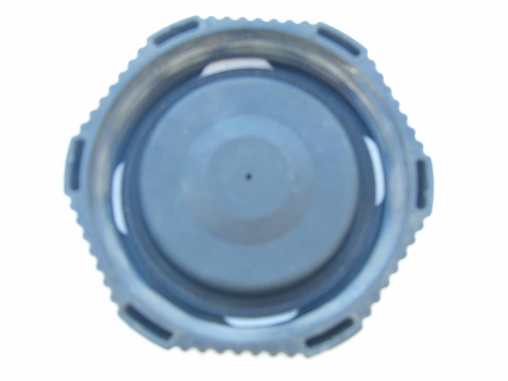

The first pic is the one from Kumar Bros. and the rest are of my cap for comparison. They're all OEM fuel caps for Kubota tractors.
Thanks to all of you for helping and most especially thanks to TractorMac who first identified the correct part and made it possible to verify that this is indeed what we are looking at. TractorMac got the answer to the mystery and thank you very much for that. It was making me a little nuts ...
If you have a cap like this and you pinch the rubber underneath enough to get a grip on it, it pulls right off and the inside looks like the original picture I posted. This picture, with the part in place where it belongs, is beyond a doubt the same and correct part.

I found this picture of the underside of a Kubota fuel cap from Kumar Bros. on eBay and this is definitely the piece that I found laying on the ground under the tractor.
So I was right..sort of, it is an aftermarket fuel cap, hence why it doesn't look like a factory cap. ;)
I have no idea where you got that idea. It's the original OEM cap. It's the same as any other diesel fuel tank cap on this model and several other models of Kubota. You can buy just this rubber part from Messicks or you can buy the whole cap, but it's the same cap that came on the tractor.
My next door neighbor has exactly the same cap on his Kubota.
I re-read my post above and maybe I wasn't clear, so I edited it to be more understandable. The picture of the cap from Kumar Bros. is an OEM cap and I only posted it to show the part in its proper place from a source other than me. This confirmed to me that the part goes where I put it. My cap is an OEM cap, my cap is just like other OEM caps. This particular OEM cap has a rubber breather gasket/diaphragm that is fitted to the underside of the cap to allow the tank to breath while still keeping unwanted foreign objects out.
