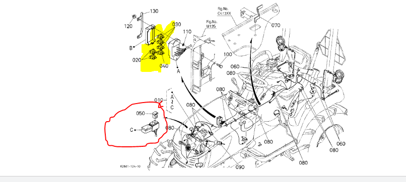

If you did, it normally will pop a main fuse and you'll need to fix that. (red)
Check the rest of the fuses too as a 5amp OPC fuse will leave you dead in the water too.

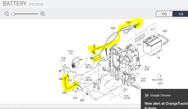

Your model also has 2 main ground cables so make sure you check both.
