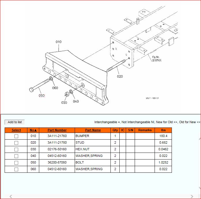

Looking up the bolt part number above indicates your looking for a 16X1.5X200 metric bolt. There are several places on line that have these, about $12-$15 each - ouch!
Fastenal has them only to 180 mm length and in Class 8.8.
I would get a minimum Class 10.9 bolts and preferably Class 12.9 if I could get them.

The first diagram is exactly what I need. Very much appreciated Wolf Man.
Is there an on-line way of ordering from home or will I need to go to the dealership?

I went to Coleman's website and entered the part numbers from your diagram and sure enough, the description matched and they were in stock. 4 bolts with shipping will cost me more than I paid for the bracket but I got a really good buy on the bracket so no worries there.
I'll wait till Monday and call and see if they can confirm the size before buying but I'm closer than I've been. Appreciate the help.

Bolts are on the way from Coleman. Very courteous and helpful. He went and pulled one of the bolts and measured it at a little over 8 inches. Should work by my measurements.
