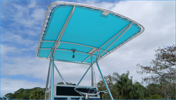

I am thinking a simple rectangle frame, maybe with a couple of cross supports (maybe, if needed). Wrap shade cloth around it and use paracord at the edges and connect them across the bottom of the frame. If I put in an adjustable bracket, I could move it forward, backward, angle it down, or just take it off with the turn of two T-handled screws. I am thinking along the lines of a T-Bag for a boat, when I think of the design.

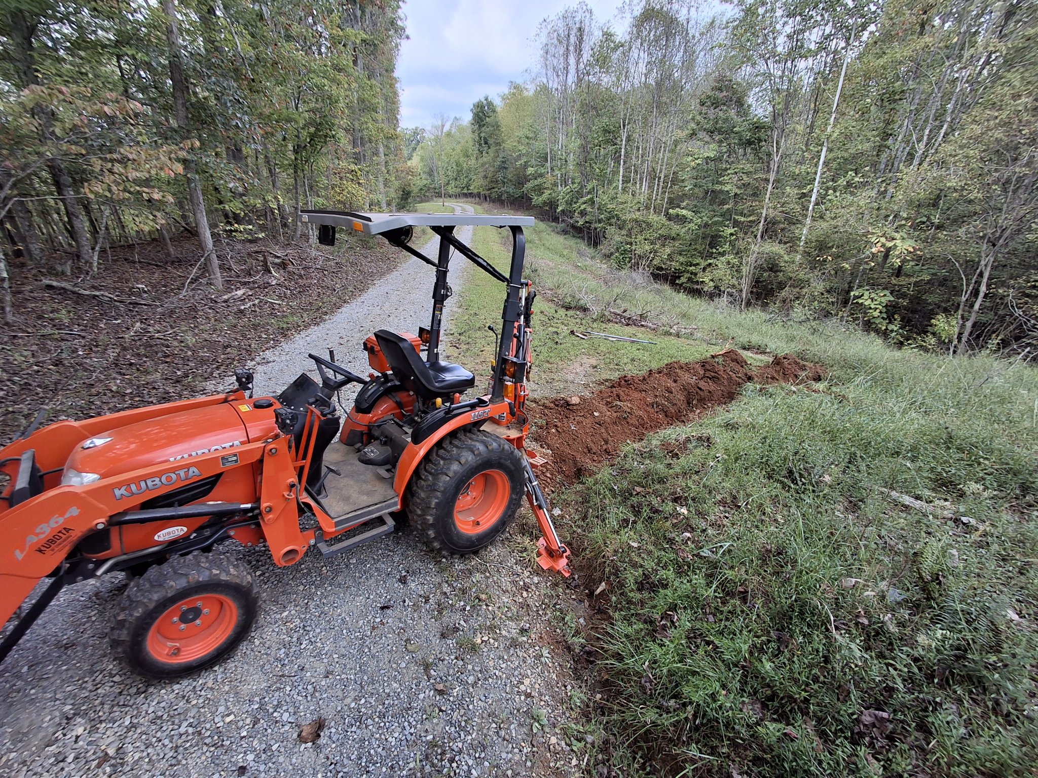

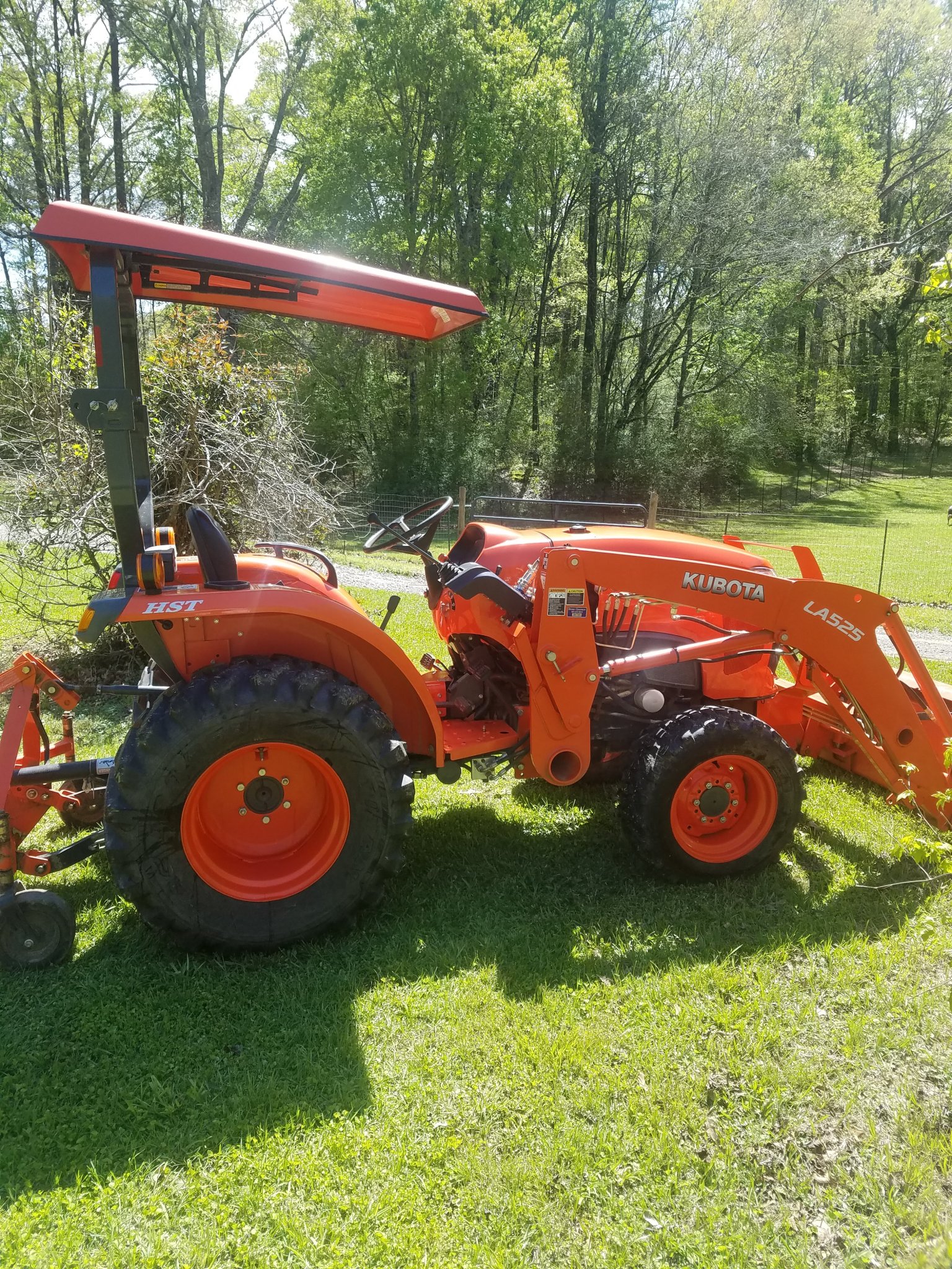

The previous owner of my machine built a top for my B2620 from a plastic base for an outdoor HVAC unit. It has served me well enough for 4+ years now. I cannot imagine this cost him very much.

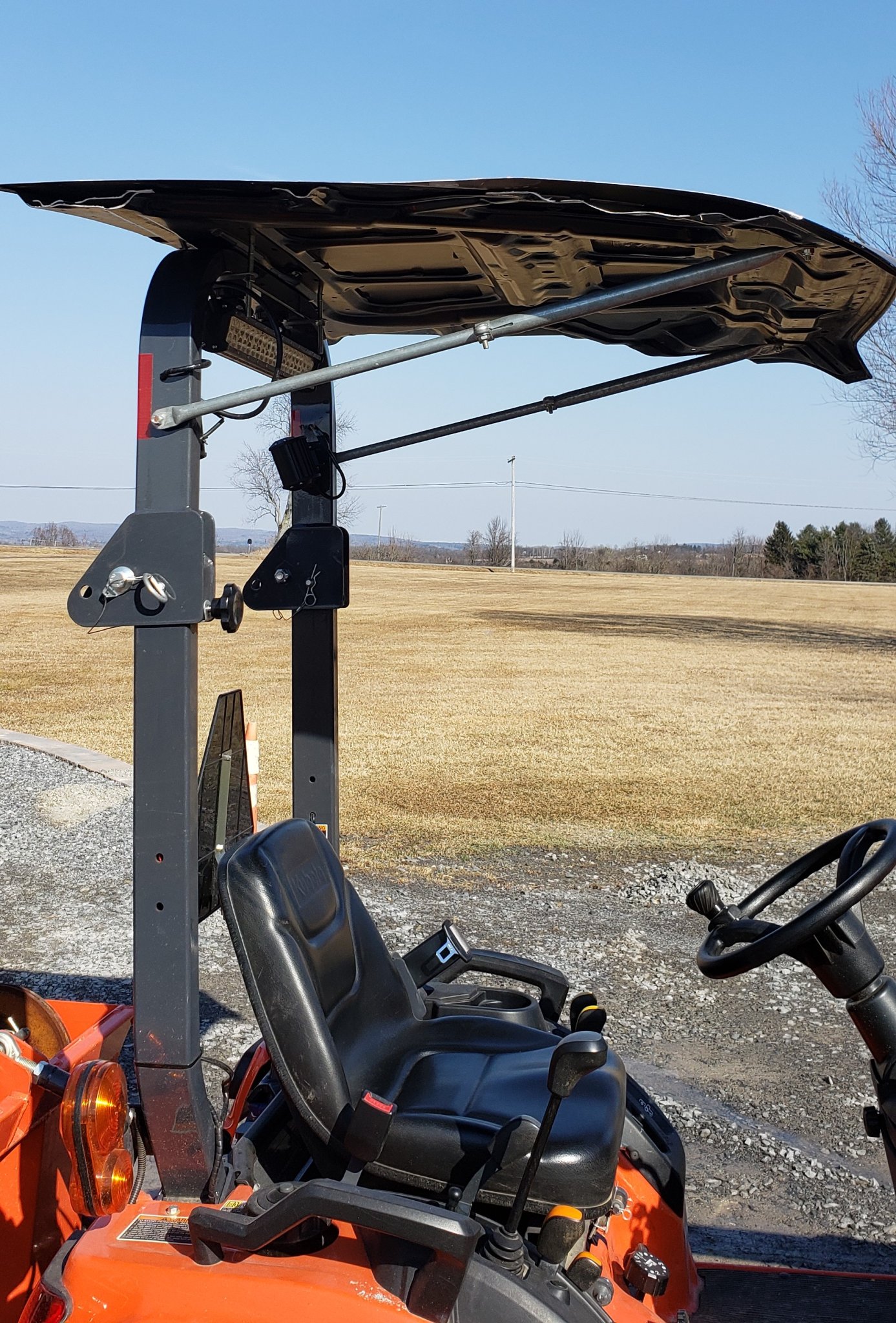

Used an old Subaru car hood, cut down the sides, supported by adjustment arms from an old satellite dish bolted into existing ROPS holes. Just barley fits in the garage while up (1" clearance). Pretty heavy but it's taken a lot of abuse from tree limbs. My son calls it the bat mobile hood.

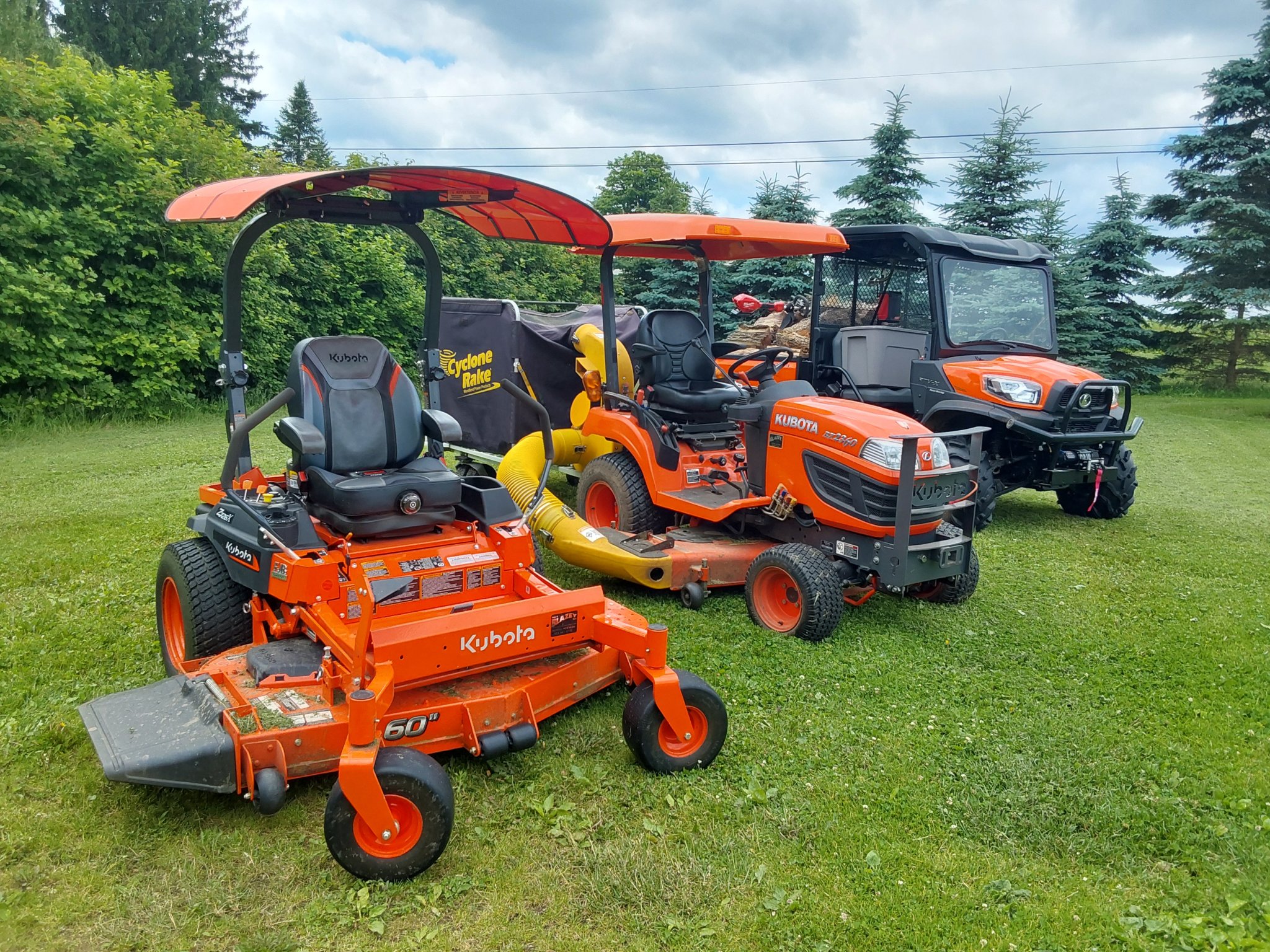

I have one of the lightweight plastic ones on my zero turn and it pops right off easily. Just a thin sheet of polyethylene with a bow that makes it rigid but it doesn't break. The heavy plastic one on my bx is beat up pretty bad from hitting low branches. It just shattered the edges with a light hit.

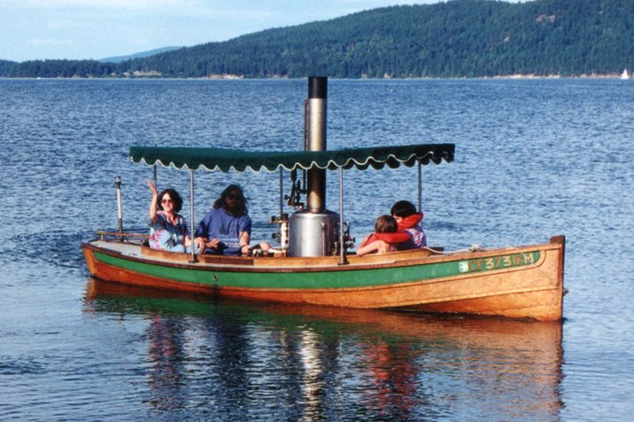

When I made a canopy for our 19' steam launch, I bent 1/2" EMT into 3D curves; that's really not needed here. I followed the design of commercial awnings, using a lacing rail set back from the edge underneath and grommets in the cloth edge; the fabric is laced on w/ 3/16 paracord between the lacing rale and the grommets. This keeps a suitable amount of tension on the cloth
This is likely more trouble than you want to go to, but it's lasted perhaps 20K miles of trailering.
