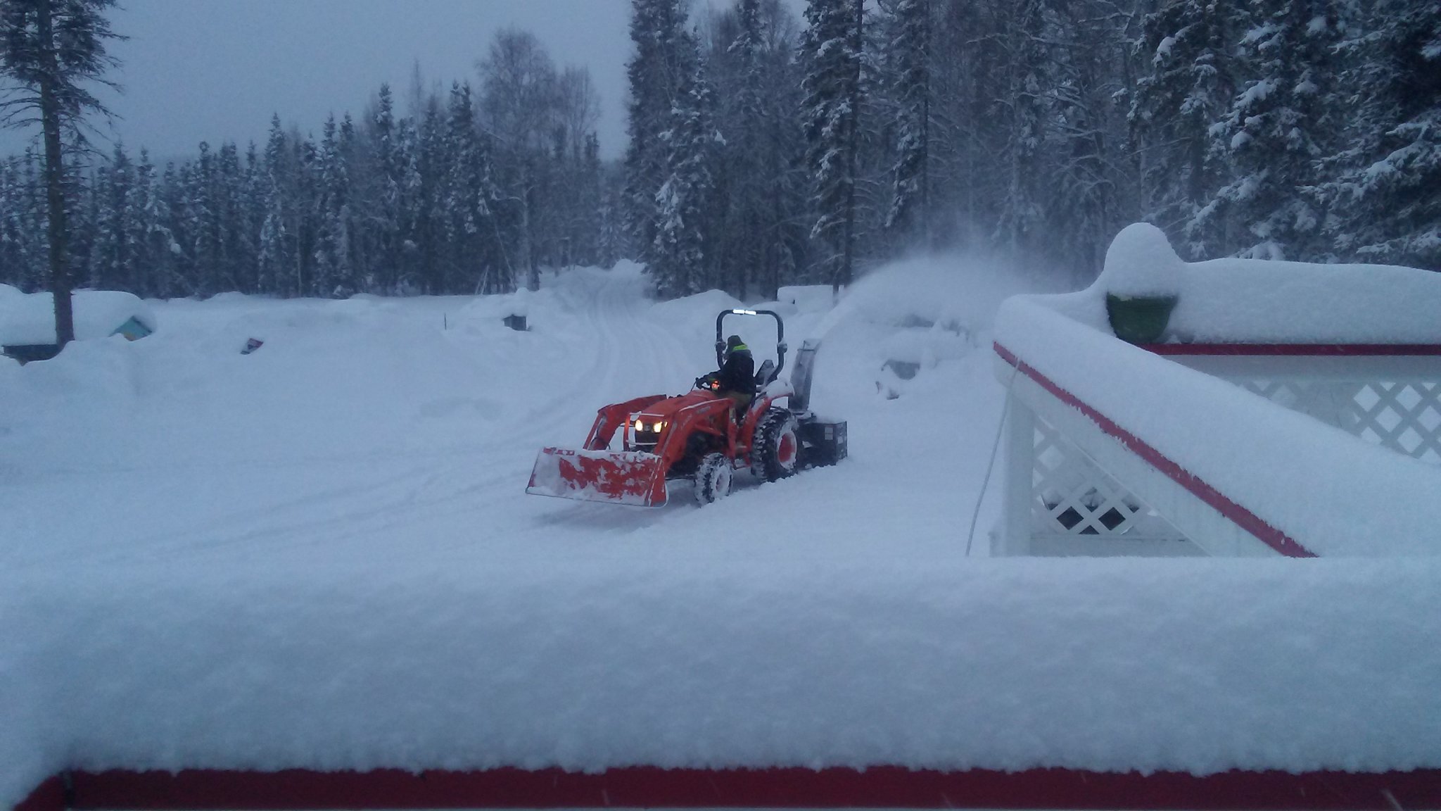

I just put on an Original Cab Company cab on my tractor. I was in the tractor yesterday and it was in the teens (14 F here in Alaska)
and it was toasty. Got my cab for $1400 and it included the glass front window, winshield washer, and electric cab heater. I'm pretty impressed. Last year was open cab snowblowing. This year will be warm in a cab.

Now they throw in the heater if you buy a cab. Go figure. My challenge was where to mount the heater. Not alot of room in the cab.
