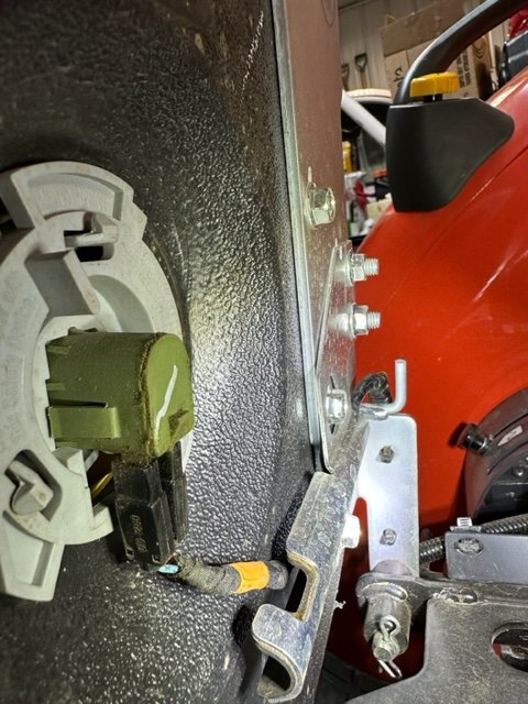

I can't see the ends of my pallet forks when seated on the tractor and, after scratching the concrete pad the other day, I really need to be able to stand and move the machine forward and back. I have looked around fairly carefully but can't find any seat pics online that look exactly like my seat (and I don't want to do something that disables it). I am not very sophisticated mechanically or electronically either, so forgive my lack of knowledge here.
Here's what the switch looks like on mine. If anyone can tell me what needs to be done to keep the tractor running when I stand, I would appreciate it. I'm fine with the PTO setup and have no interest doing anything stupid or dangerous but I can't use the pallet forks properly as things are. Coming from a 2000 L4300DT all these safety "improvements" aren't all that helpful. Overall however, the MX6000 is a huge improvement, especially the SSQA.

Take a paperclip and cut in half, shove the u shaped piece into wiring harness. It is not pretty but works. Or wire in an on-off switch in parallel in the harness. Or mount a wireless camera on the pallet forks that use a phone as the screen so you can see the forks and keep your butt in the seat.

I'm not sure I understand where the paper clip goes? Do you insert it without removing that plug? A pic would be great if you have one.

A VERY basic and effective concept!
Pull both of those little plugs off their connections, and push one side/half of the paperclip into each little plug.
Really better done with a very short piece of wire stripped a bit at each end, but a paperclip will work.
You now have shorted out the seat safety system.
Just don't fall off your tractor......because it will keep on running.
I did this YEARS ago,...... but don't say that I told you to do it!

the seat switch is a simple normally-open circuit. When you sit, it closed the circuit. That's why the paper-clip mod works.
So I used a normally-open momentary switch and connected it to the two wires of the harness in parallel to the seat switch. When you press the switch and close the circuit, the tractor thinks the seat still has a butt in it and won't kill the engine if you stand up and move the treadle pedal.
The polarity doesn't matter. Just connect any switch you like to the two wires on that harness.

You can scotch lock(a type of splice) into the single wires at the seat switch and just run to a switch, therefore if the switch is not on/pushed your seat switch still functions. If doing a scotch lock use a sealed one. I hate scotch locks for wiring as people use them in all the wrong places(think trailer wiring). I prefer soldered connections with glue filled heat shrink.
