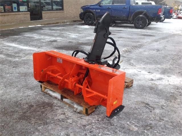

So I want to hydraulically articulate the chute deflector on my BX2822A 55" commercial snow blower with my B2601 tractor TRUE THIRD function.
I can't see paying $1100 for the hydraulic chute deflector kit BX2821A when all I need are the parts highlighted in red. If you purchase the kit, you are purchasing parts that you really don't need if you have a third function. You will be paying for a diverter, electrical harness, etc, all you don't need, and WORST YET another switch up on the joystick in addition to the 3rd function. YUCK!!!!
The dealership confirmed that the hydraulic chute deflector kit for the snow blower includes extra items you do not need if you have a third function on the tractor. It includes electrical connections and a diverter system that are unnecessary.
The dealer priced the actuator only and the mounting hardware at $560, which would save me $500 over the full hydraulic deflector kit.

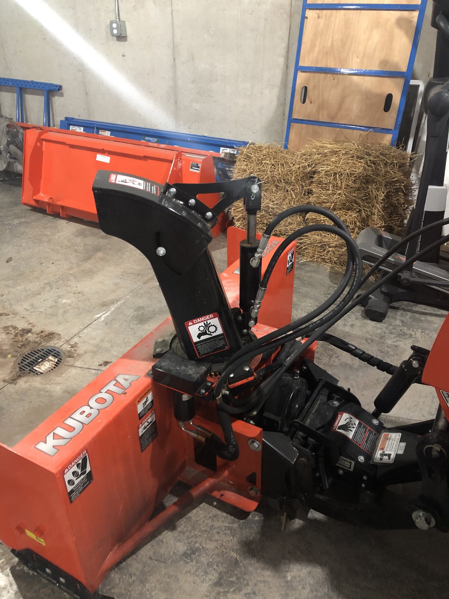

In the picture below, the person paid for the diverter on the blower and the dealer came out and hooked the deflector directly to their tractor third function.
Borrowed picture from someone kind enough to show me the clean setup.
STILL WORKING THIS ISSUE TO GET THINGS HOW I WANT THEM. THIS SETUP IS PERFECT!!!! CLEAN AND ONLY ONE BUTTON ON THE JOYSTICK.

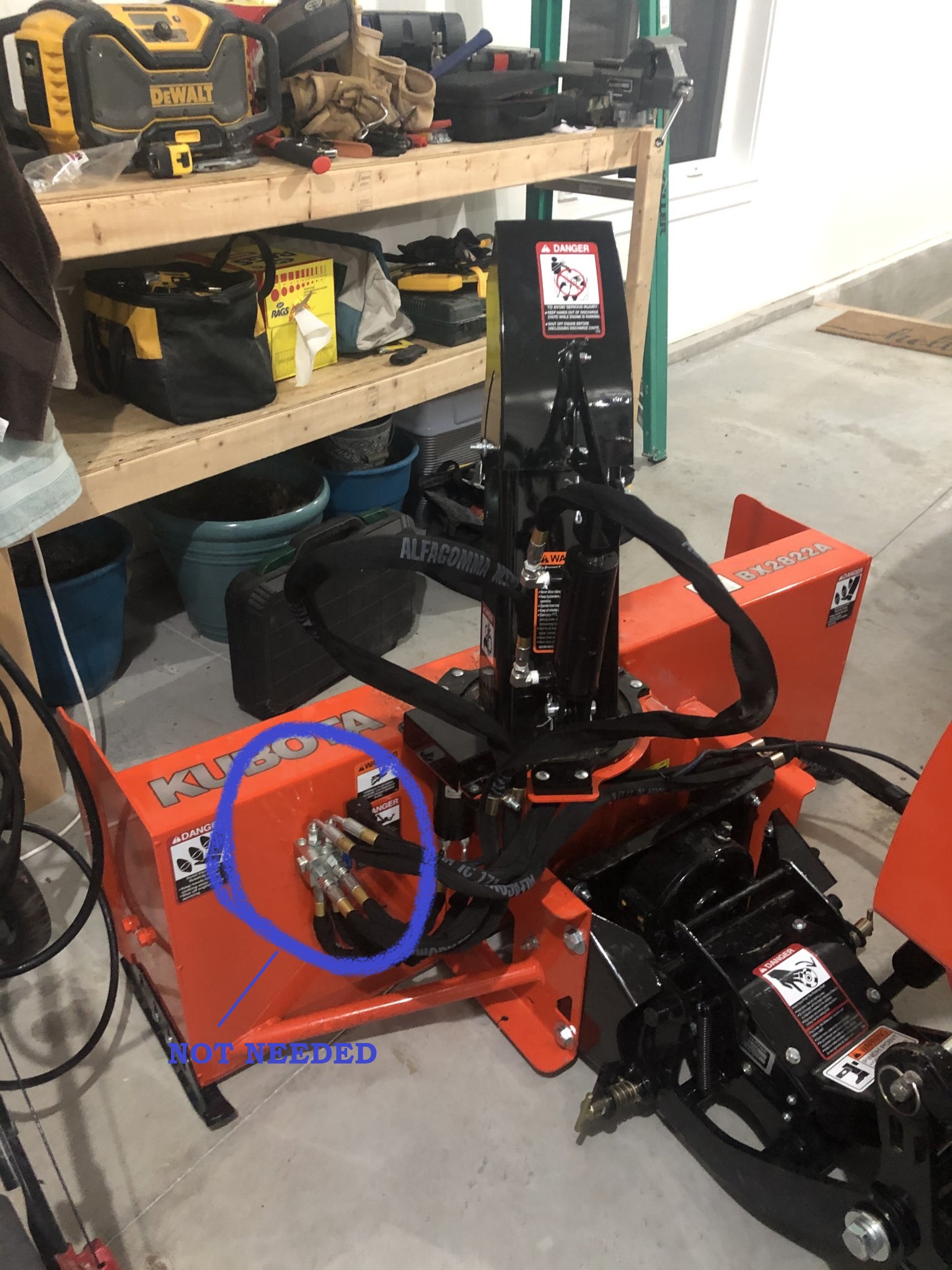

I ordered the 55" commercial snowblower for my B2601.
I've added (photos courtesy of someone on this forum):
1) Photo with chute deflector kit installed on the blower (NOTE THE DIVERTER HIGHLIGHTED IN BLUE THAT IS NOT REQUIRED IF YOU HAVE A THIRD FUNCTION. This kit costs about $1100.
2) Photo after a dealership REMOVED the unnecessary diverter and switches and connected the chute deflector directly to the third function.
3) The exploded parts diagram where the dealer worked with me to order just the parts I needed from the chute deflector kit.
4) The priced up price list from item #3, included needed hydraulic lines to third function. Saved me about $500.
To convince my dealership I did not need all the parts in the chute deflector kit, they opened one up in stock and they said "hey, you are correct".
