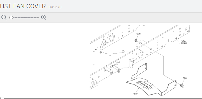

With the deck removed, loosen the two upper bolts and remove the lower bolts. The plate will swing down, leaving the filter out in the wide open.
When reinstalling the cover, you do not need to tighten the bolts to 35 ft lbs; just snugging them works well.

I looked and it didn't seem like that guard can be removed on my BX2670.

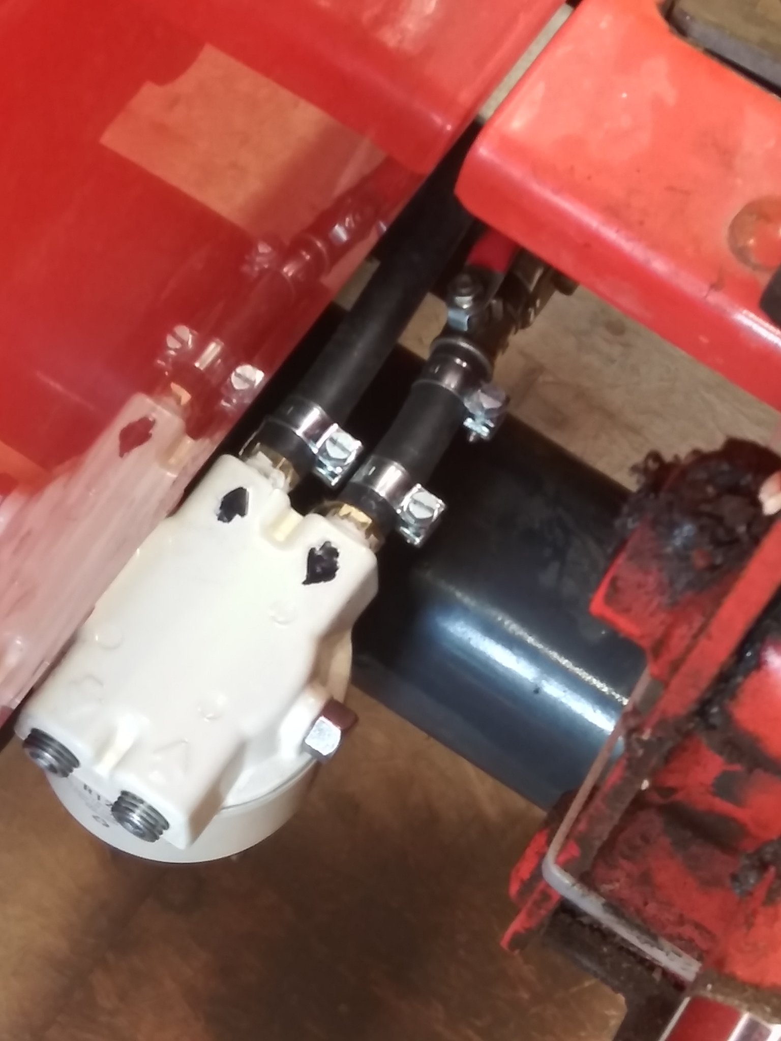

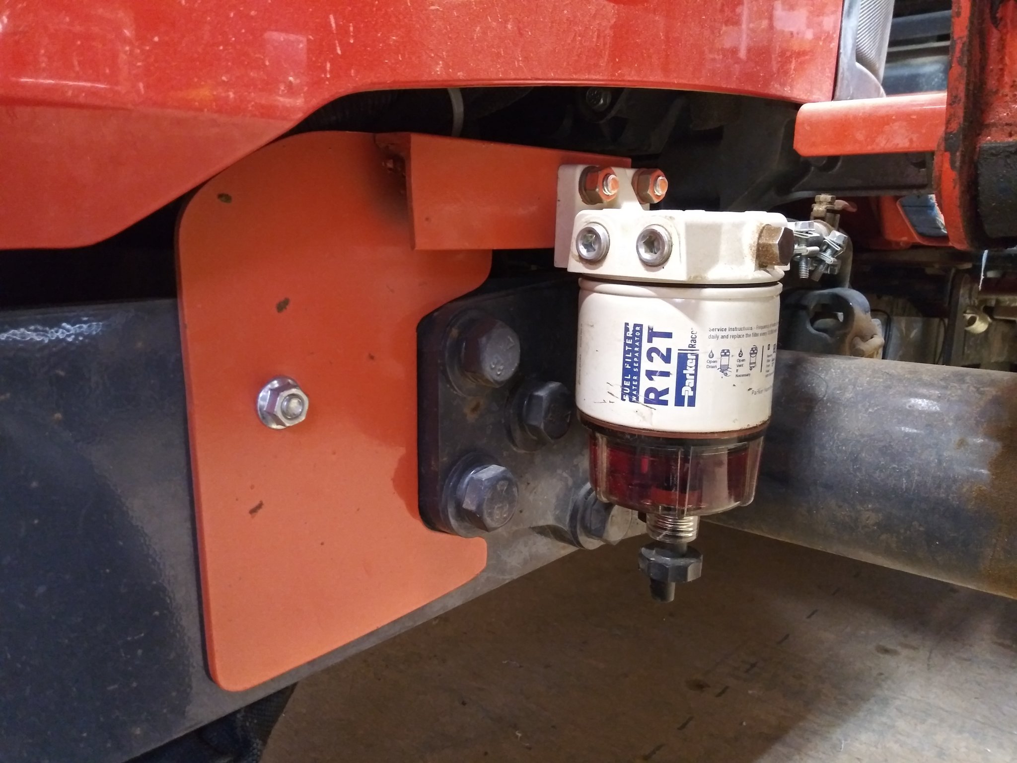

Run your hose all the way to the front THEN back to the pump.
Changing filters in the future is now very easy.
Reminded me that I’ve still got a filter relocation kit on the shelf in the garage.

I've been watching youtube video's on the BX Fuel Filter modification. The only difficult part of the mod is building the mounting plate. I like your mounting plate design.
