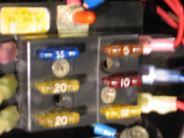

OK. I'm happy to report that I've completed all the wiring on the BX25D.
Yep. It took all day and most of this evening but it's done. I snapped some photo's for you all to look at. As you'll see I installed an auxiliary 6 cavity fuse panel. It's relayed so that power will only be on the fuses when the key is on.
I also snapped a few photo's of some GM weather pack solder-less terminals that I used. Some might not have see these used before so I wanted to include them in the photo's. You'll notice there's a special crimping tool that's need to crimp the little pins but I like these and use them a good bit. 95% of all the wiring was soldered and heat shrinked. I am not a fan of stab loc connectors but I do use butt connectors where it's dry and away from water.
I used waterproof switches for everything. I also installed a horn, reverse alarm with a by-pass switch so it could be deactivated when ever I didn't want it on. I installed the horn switch towards the said of the instrument panel due to lake of space but it's easy to reach there so I'm OK with it. I put in an extra accessory outlet and the tactical light on the ROPS is working now as is the 20" LED light bar. The ditch lights are absolutely awesome now that they are working. I also got the back hoe lights wired in and they are very nice as well. The 6 cavity fuse panel was just enough to get it done. I put a disconnect on the back hoe with harness because when I go to let the hoe go from the back of the tractor I'd need to be able to split the wiring.

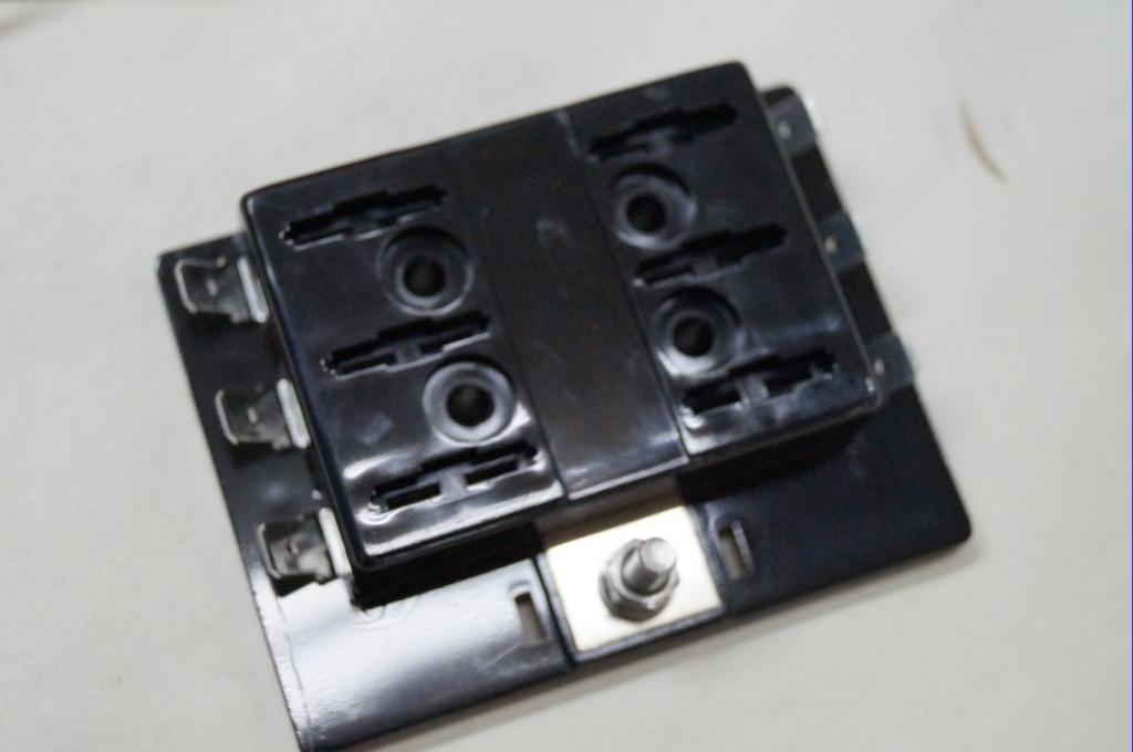

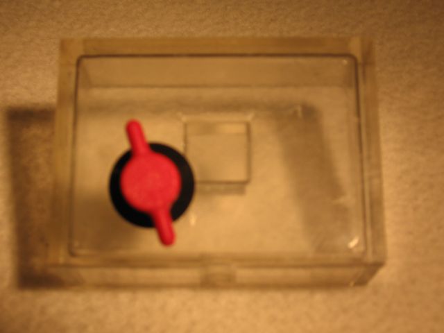

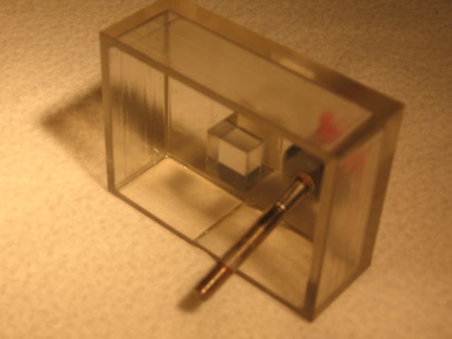

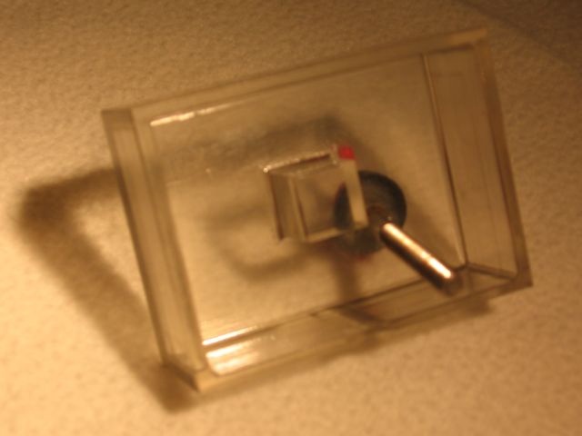

Wildfire- One of your earlier posts shows a fuse block that appears to be the same one I have used on several projects:
Here's some pics of a cover I made for mine- not completely waterproof, but it keeps the dirt, mud, and the occasional possum out.
Wildfire
More pics:
Nice work and a great idea. Thanks for posting it. ;)
