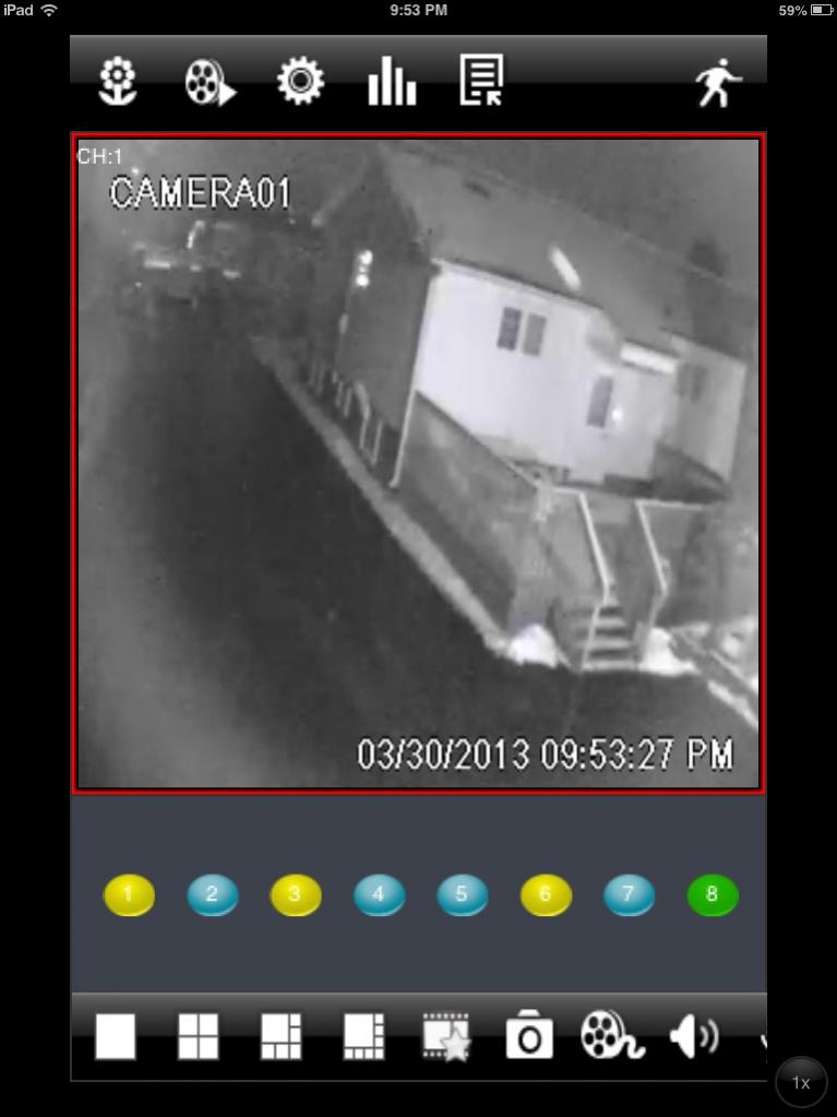

snowing???? What a shame, it was 68 in nth ga today. But, it was 22 last week, but it's SPRING TIME !!
I've seen it where we've had three snow storms in April. I just snapped this from our camera system. You can see some snow on the ground. :mad:
