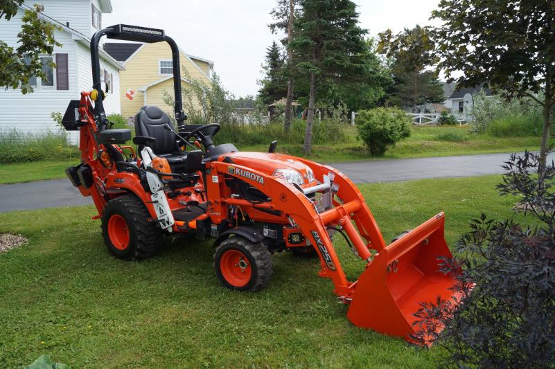

Early this year I bought a new Kubota BX25D.
Before taking delivery, the salesman when over all of its controls and features including the float option on the front end loader. According to his explanation and what I've read, pushing the loaded control stick all the way forward places the valve in a position that no fluid is supplied to either of the hydraulic cylinder and the bucket or plow basically follows the terrain.
For winter I use I bought both the quick detach option and the plow blade. This little beauty makes switching from bucket to blade and back a 5 minute job so this money was well spent.
The other day it snowed so with about 6 inches on the ground I started plowing. Drop the blade on the pavement and lock the control stick in the forward most position.
After moving a mere 6 to 8 feet I noticed the front wheels were off the ground! This seemed odd because the float position should not allow fluid to be pumped to either end of these cylinders but with the wheels off the ground this certainly was not the case....
I checked everything several times and can feel the click when the control stick click into the float position....I tried this several times and unfortunately had to finish clearing watching the height of the blade....not what I expected.

We have a BX 25-D and the float is an easy system to use. Push the stick completely forward and it should be in the float position. That being said even in the float position your wheels can still come off the ground if the bucket has enough resistance while moving forward.
If your wheels do come off the ground in the float position while moving forward just stop and back up a little. If the machine settles down on the wheels again then you know the float valve is working as it should.
There are times where the float position works well and there are other times it don't. It will take a little more experience to know when to use it.

If there is enough drag on the bucket,(friction along the bottom area of contact), the tractor will litteraly push it self up, just like a pole vault. Float is mostly used in the drag , moveing rearward position.

Once the front loader control stick was in the float position I started plowing. A couple of times I noticed the front wheels come off the ground so I backed up slightly to take some pressure off the front and what do you know, the wheels settled back down right where they should be.
I wasn't moving a lot of snow at all and but when the drag on the blade became too much I seemed to repeat this scenario more times than I'd like to see.
The machine is very powerful and I'm wondering if this is more of a weight distribution than anything else.
I left the backhoe attached thinking it would add weight to the rear wheels giving them added traction or grip when the snow is heavy and deep. While this is sound thinking it also may be assisting the front end lifting prematurely adding weight behind the rear wheels and using them as a fulcrum...
I'm wondering if I should remove the backhoe attachment or possibly add counter weights to the front?

OK guys, look at everything when it comes to this usage. As engineers, we use what is called a free body analysis showing all forces and resistances. At the time of front wheels lift, there are only two points on the ground, the bucket and the rear tires. The front upward rotation of the tractor is on that rear axle pivot. One factor is: where is the center of gravity of the tractor with respect to that pivot? Putting weight on the rear end moves it back, closer to the pivot, making it less useful in resisting tilting up and back. The driving force of the rear wheels is there only because the center of gravity resists overturning up and over backwards as the torque goes into the axle also tending to lift the front end. So for a tractor light on the front end or with a weight hanging off the back, one will expect more of this front end lift. Remove the rear weight or add weight to the front end will help to counter the lift. This then is tied to the geometry of the bucket linkages and its pivot providing a lever arm to tilt up and over backwards. This is why larger tractors with more overall weight and thus more resistance to overturning up and over are less likely to have this effect. Also blame some of on the power of the engine. A lower powered machine won't be as affected so easily.

BX25DMAN what you are experiencing is normal. Some tractors are more likely to do it than others. When you are in float you just have to keep an eye out, to keep it from happening.

Yup, I had to keep an eye on it today. My concern is what happens when the snow becomes deeper requiring more effort to move it? Thinking that I'll be pulling a wheelie every time I drop the plow makes no sense at all.
I may end up disconnecting the backhoe in order to change the weight distribution, this should help the situation....

Just my own experience but on my bx25d the first few snow falls I still had the BH left on and float would lift the front wheels with very little snow built up. Since that I picked up a second hand 3pt snowblower about 300 pounds so about half the weight of the BH and now I can push alot of snow before the front wheels lift. It will still happen if I angle the cutting edge down to reply dig in or climbing a steep hill but a big improvement
