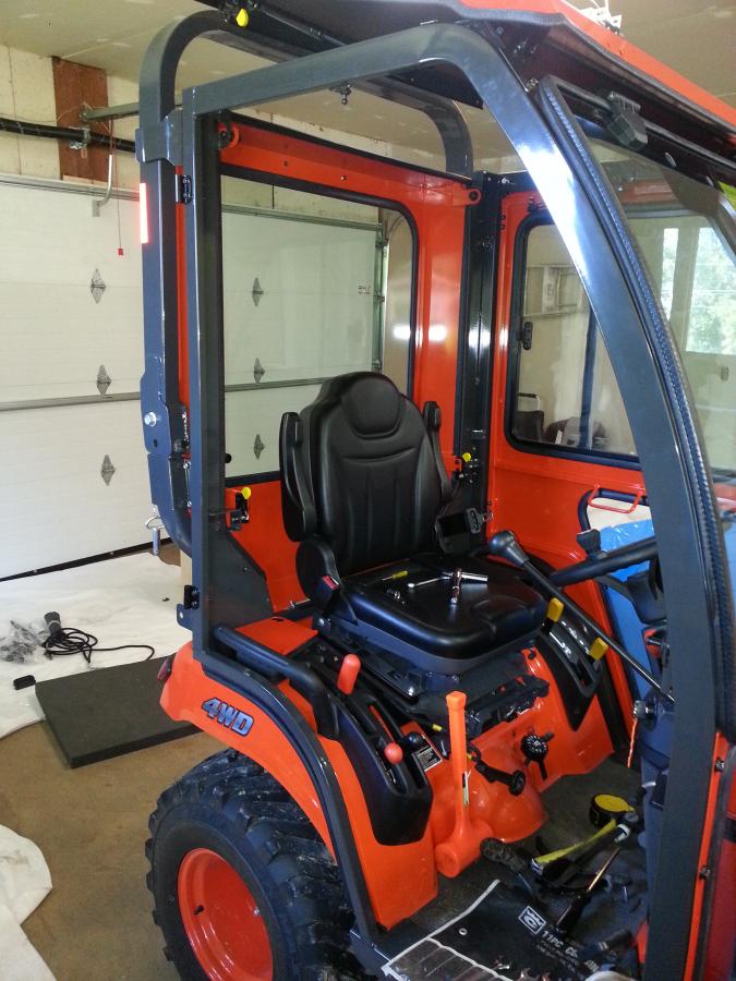

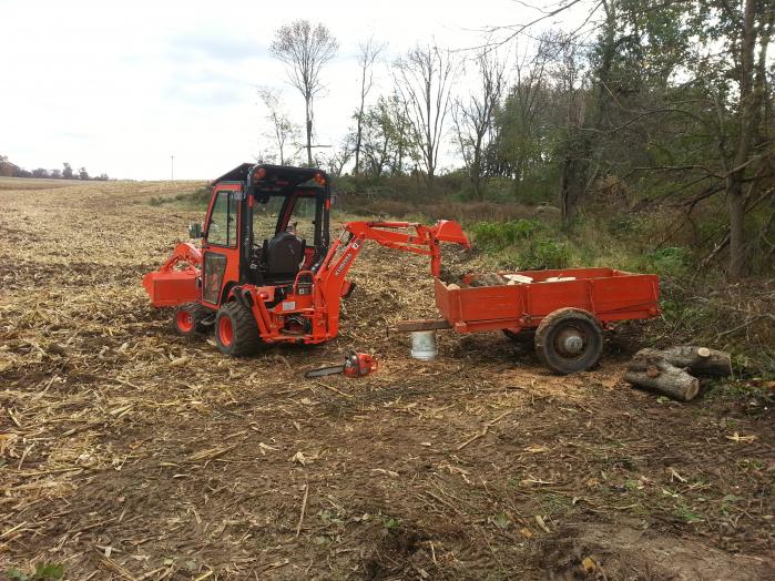

lreops,

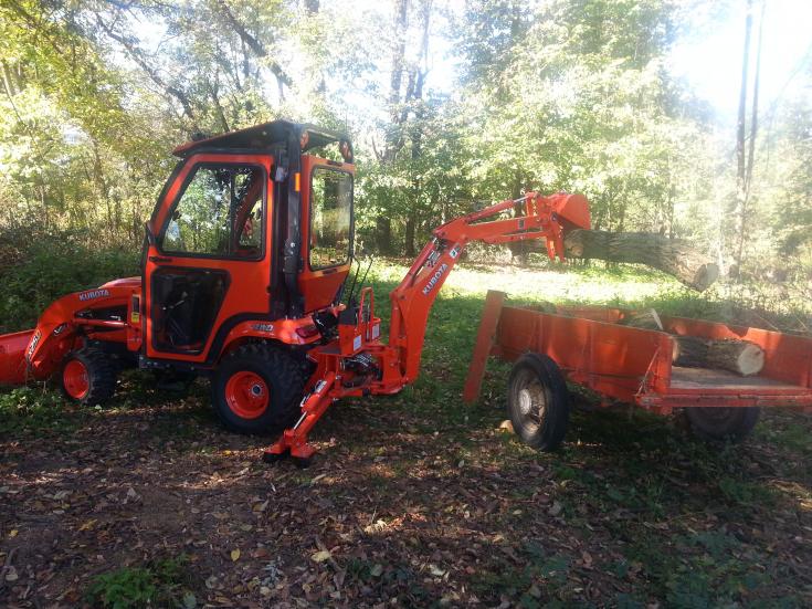

The roof tilts up, and the back wall comes off and was designed by Curtis Cab for the Backhoe operations. The doors lift off as well as the back wall. No issues or time needed to take any of the three parts off for long or short term usage.

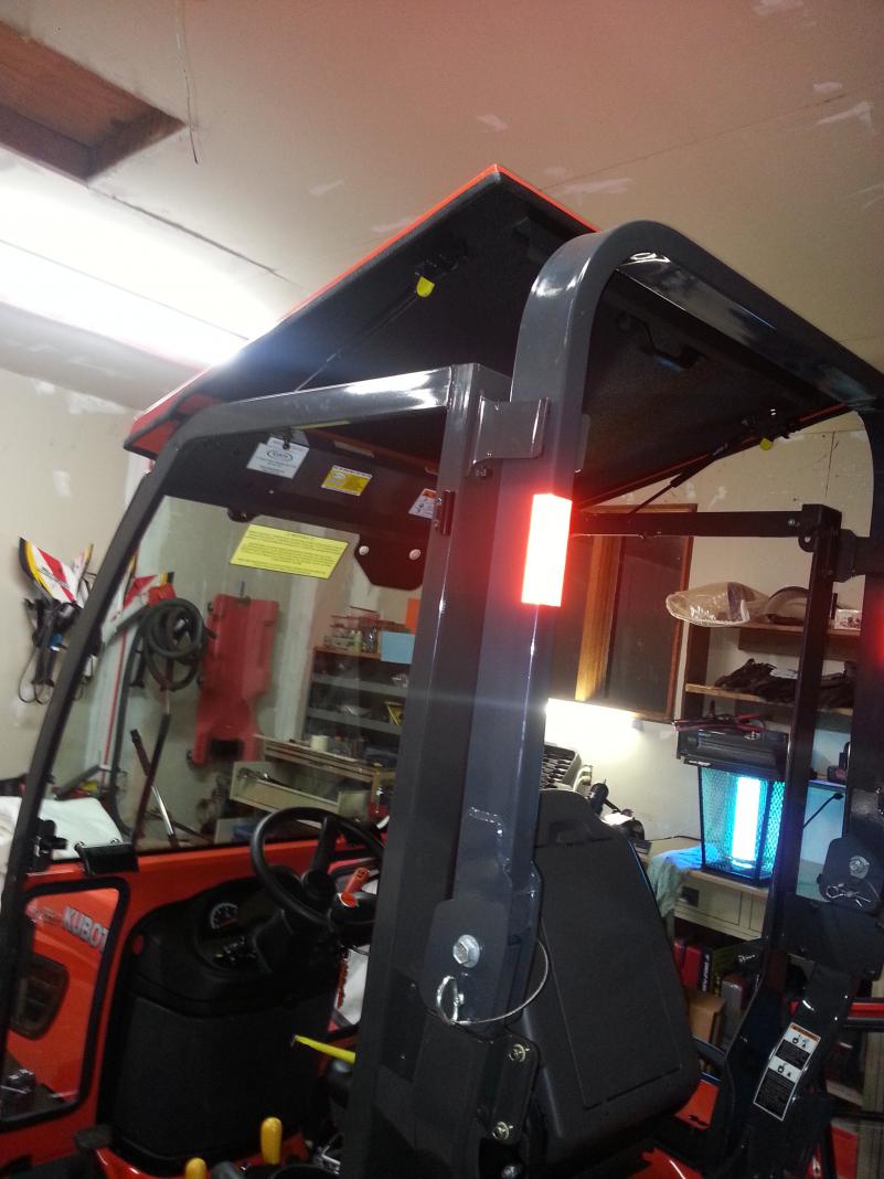

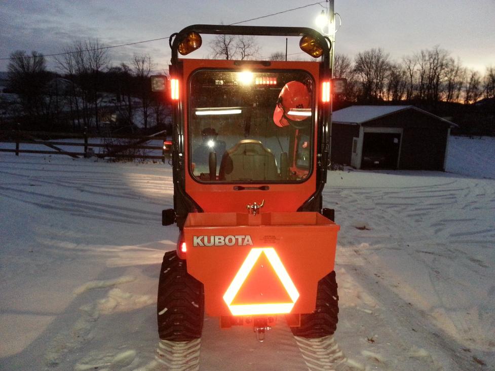

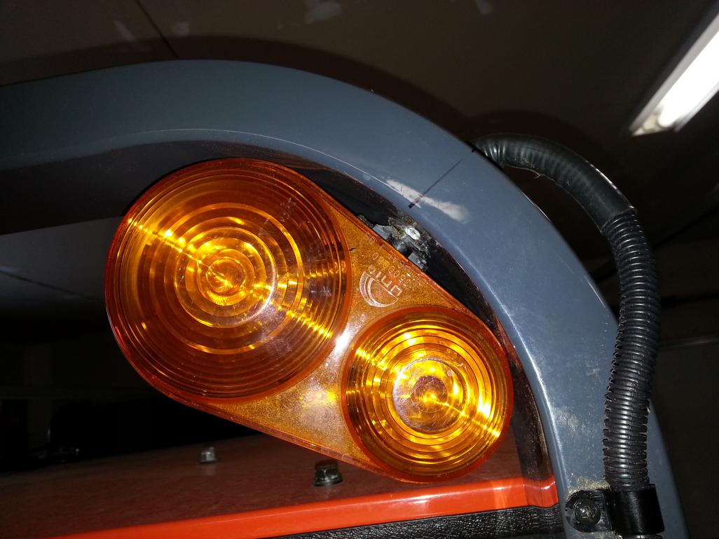

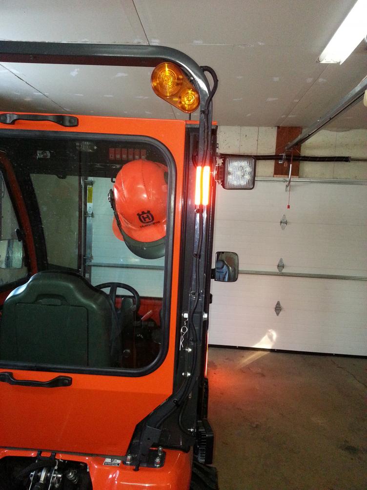

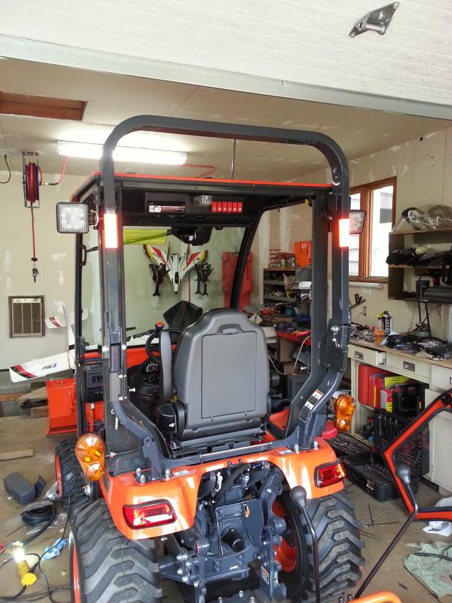

I noticed you moved your lights to the ROPS. Was the bolt long enough to make it thru both tubes or did you need to modify it. I like that idea and it gets them up where they can be seen. I live on a very busy highway and even in the blowing snow people pass my house at 60 mph so getting them above the snow banks would be a much better idea. Cab looks awesome.

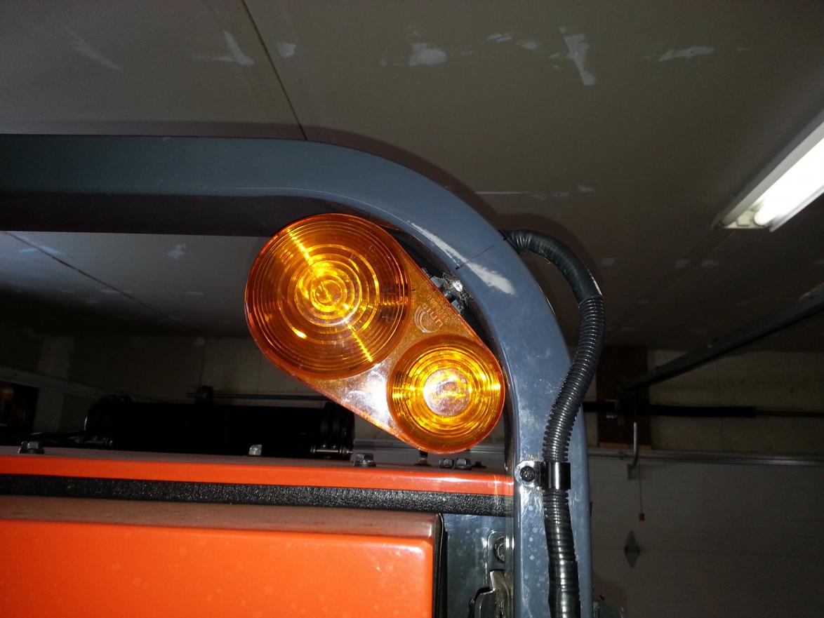

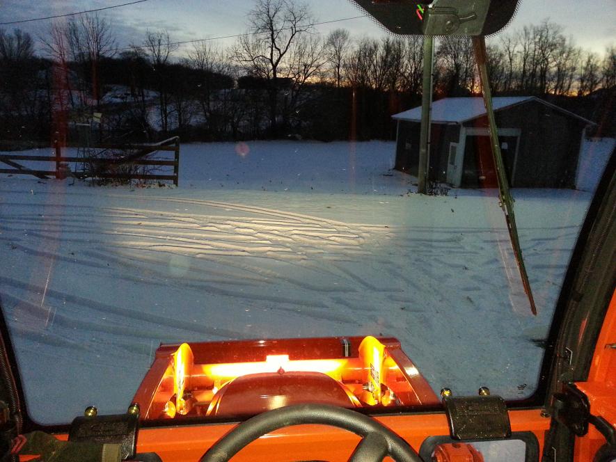

Hazard light move: The bolt is long enough, but base will need to be cut. study pictures closely. Iwanted to be seen better when on the roads and in the woods.
remove lights and grind /cutoff all the black base Pic 1
extend wires to top of ROPS. Soldering+quick disconnects at top, Pic 2
Drill, paint, install lights and seal with silicon and shrink rap wires Pic 3

From what I have seen and I am sure you will hear about. I do believe you have violated the warranty on your ROPS by drilling through it. I understand it is a NO NO. It is yours and if you are ok with it that is all that matters.
Overall I gotta say nice work. I do like what you have done with your play toy :D
34,235
9,421
Since Kubota_Man already dove into the shark infested waters.:eek:
I would also note that one should never drill into or weld onto the ROPS, it does effect the structural integrity of the device, and keeping things safe is the ROPS job!;)

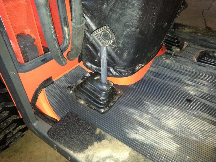

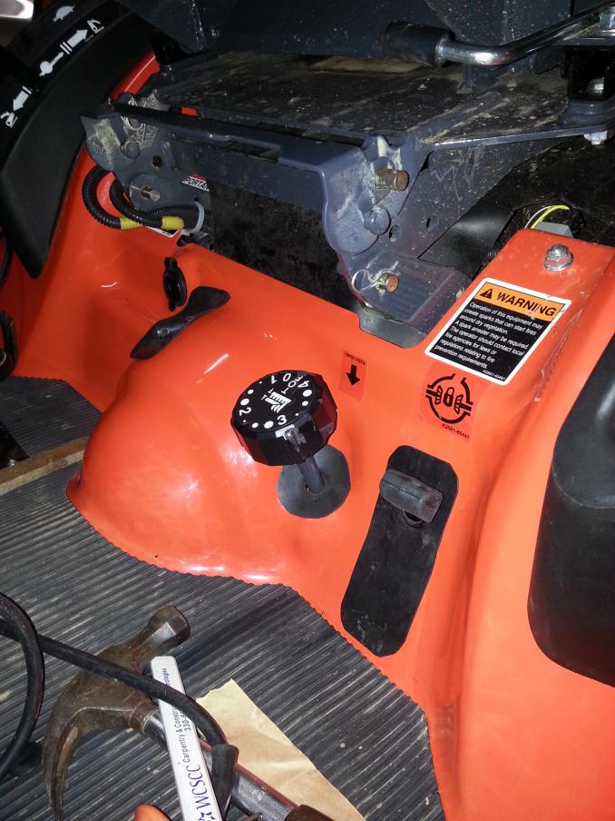

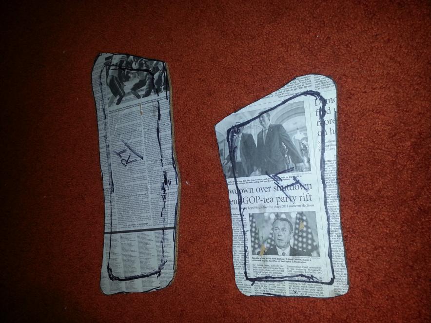

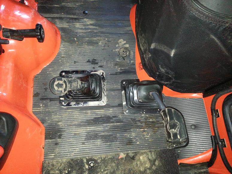

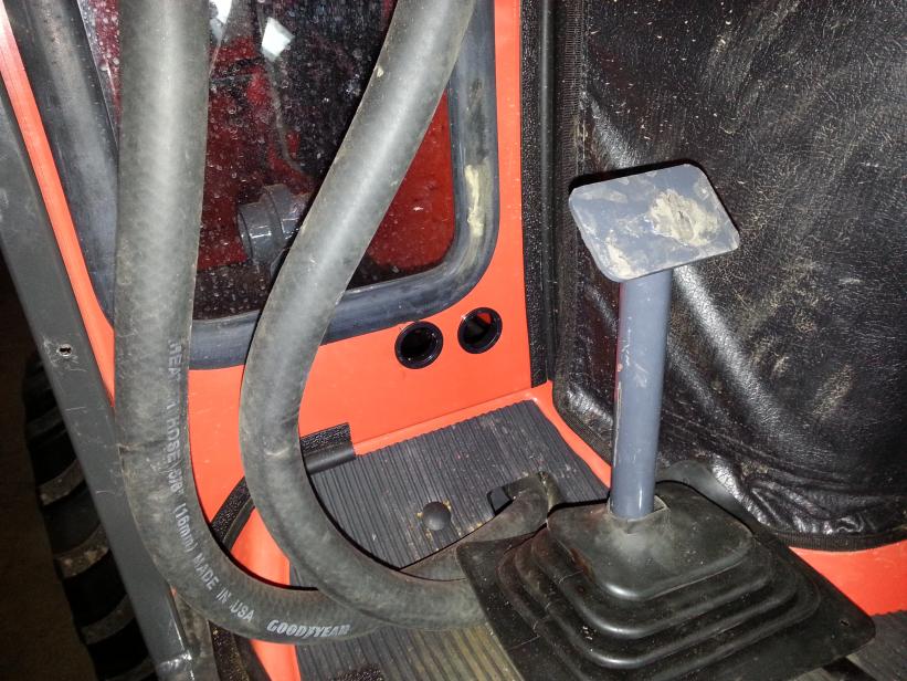

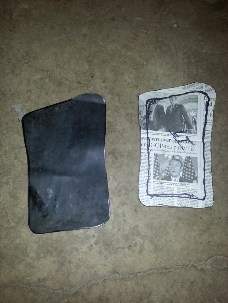

Closing up air gap on left side of seat
remove rubber handles
make a templet out of paper and card board
cut out rubber mat
trim rubber mat to fit
cut out line for handles to move in
Tape or glue down rubber mat

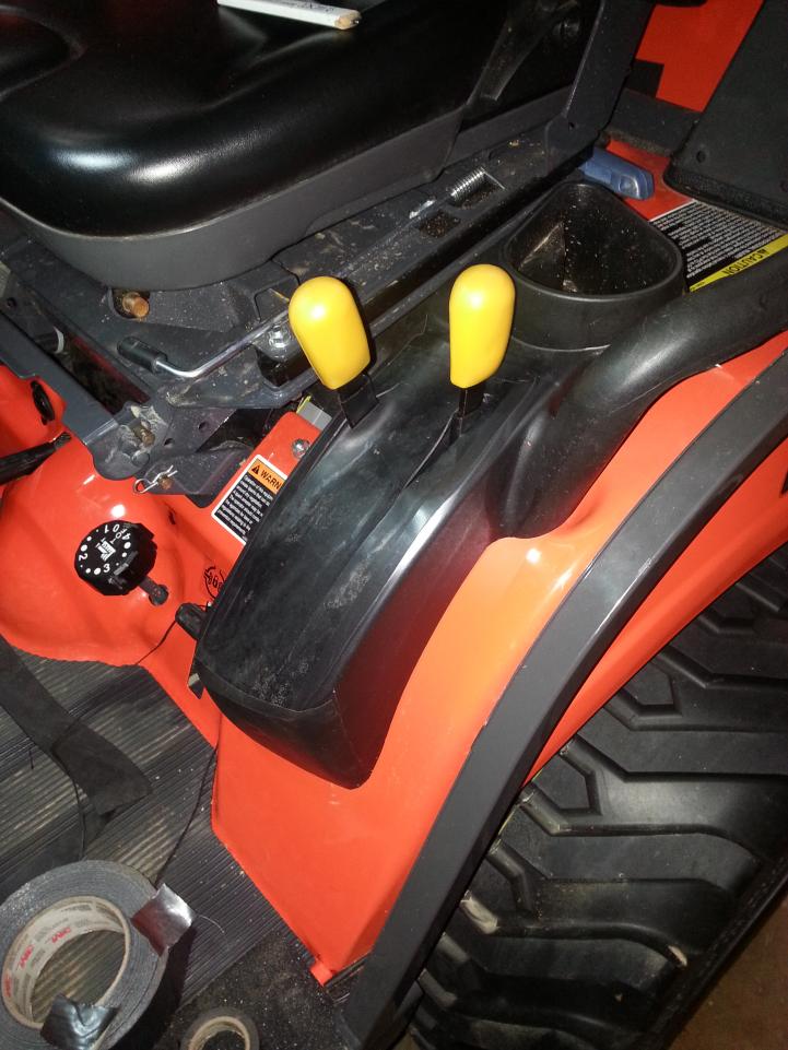

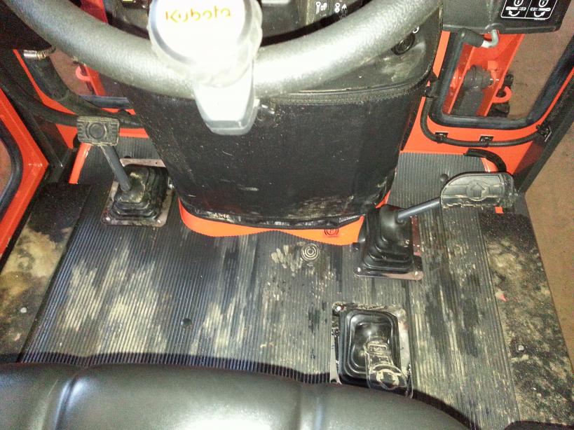

I decided to go a different way, for closing the air gaps , on the control levers on both sides of the seat.
FOAM TAPE.
KISS method (KEEP IT SIMPLE STUPID)
t33jetman
BX25D, TLB, 1860 bal. bucket, Curtis Hard Cab
Aug 31, 2013
212
Wooster, Ohio

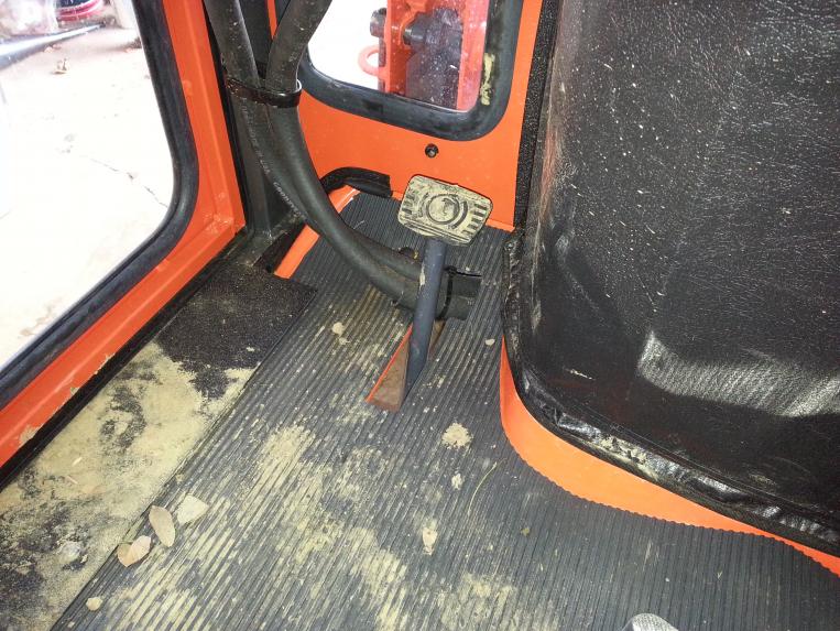

Finished the three levers under the seat
Cut up a rubber mat I had, cut to fit and used silicon water proof glue , done.
There is a rubber mat cut to fit under the seat also.

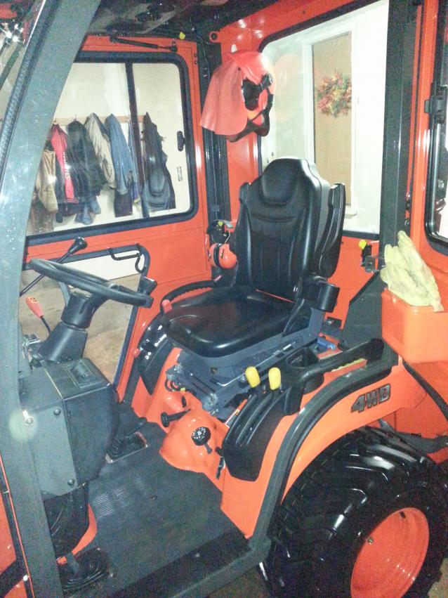

That should just about be all I need to keep the heat in.

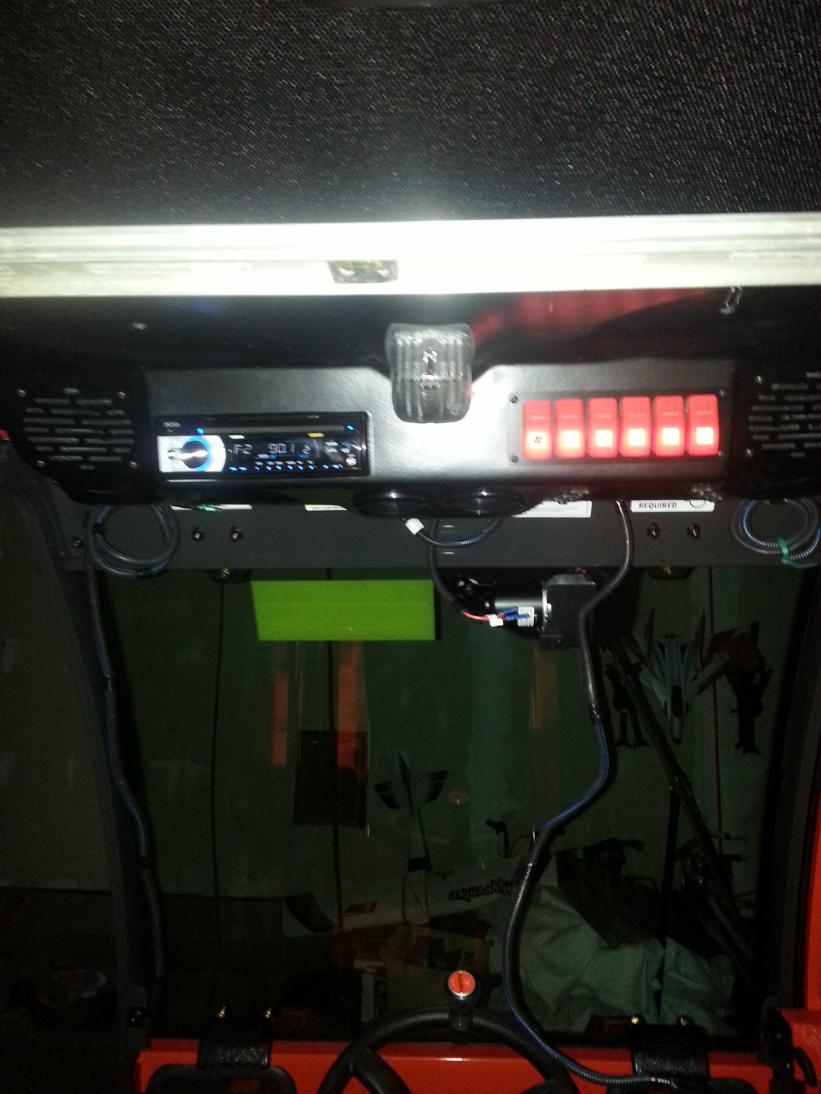

For all the guys who say it is hot in the summer:
The doors are on jeep hinges and lift off in seconds and also the back wall lifts off also in seconds after unlatching it.
Now you have three sides off but the roof and front windsheild stay on.

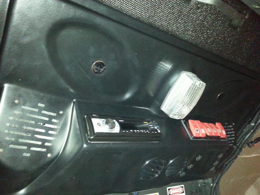

The fan in the over head console is very helpful staying cool in the heat, and the cd/radio will give you music to work by.
Yes you do need ear protection for the noise level. Unless you go ahead and put sound deadening material under the engine hood and all over the inside of the cab.
great install , here's some random observations /comments.
If its that loud I don't think I would have bothered with the radio?
The foam in the slots for the levers is way better than the rubber boot.

I don't cut five acres of grass with this tractor, my wife uses the big zero turn for that.
I use the radio/CD player, all the time when working out side of the tractor in the woods or in the barn or just riding down the road.
Even while driving and with my ear protection on, you can still here it just fine.
