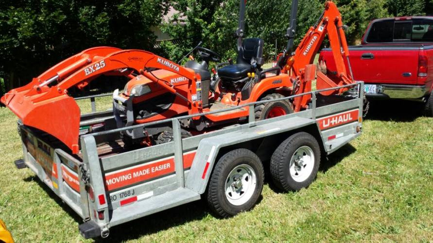

There appears to be some controversy about what size trailer is required to carry a BX25 with loader and backhoe. This photo shows a standard U-Haul 6ft X 12ft trailer. At first I had it in with the backhoe in the rear. I had a lot of sway. Backhoe to the front towed perfect.

Yeah as you see it fits and it worked. But if it was me I'd put it on a 16 foot deck and get the loader flat on the trailer bed and the boom down too. I don't like leaving loaders and booms up in the air when riding around. To much stress and strain on the hydraulics.
If a line blows and the loader comes crashing down it wont be pretty on that Uhaul trailer.
I would want the loader and backhoe down, too. It lowers the center of gravity.
A longer trailer also gives you the ability to get the balance in front of the axle, so that it doesn't sway. It also allows you to get the balance without having to overload the tongue- you can keep most of the weight on the trailer axles, but far enough forward to keep the center of gravity in front of the axle.
A bigger trailer also gives you more room to chain the tractor down- that U-Haul trailer doesn't.

Tom,
My BX-25 D was delivered from the dealer via a private hauler, a 12' single axle trailer!!!!
I was stunned ! I have pulled mine a 14' double axle trailer without any sway or problems via a 2002 trailerblazer, inline 6.
Now I ran mine up on the trailer bucket first, bucket hangs over front tougue side - I have tool box and the teeth do not come down onto the box, I also swing the backhoe to one side or the other, as others have said, get the weight forward with in reason or it will sway like the wind! Approx weight is getting close to 3000 lbs. 1600 for tractor, 400+ bucket, 700+ hoe, 60 mmm is about 250, 6 gallons of diesel.....filled tires....

Best I can say is go with what works for you and what you feel comfortable with. But think things through for what could happen. Again for me I'd want a trailer big enough to have everything contained inside the deck of the trailer.
Around my parts Kubota Man's set up would get you in trouble for not having the boom outside the trailer marked with a red flag and not having the boom tied down to the trailer.
I would not want someone plowing into the ass end of the trailer and busting the boom all to crap because its hanging on the outside of the deck. Yeah a rear end hit is no fun but the tractor is less likely to get destroyed if it was inside the trailer deck. Looking at it from a fender bender point of view...
You also have to think about what might happen in an accident. Will the tractor stay on the trailer? Will protruding implements cause more damage or injury/death, and not to belittle that, but what about liability?
A couple of years ago, a local contractor was hauling a skidsteer on a tilt deck trailer. He forgot to lock the coupler on the ball, and was going down the road doing 45 or 50. The hitch came off, the safety chains broke, and the trailer veered off the road and went across two parking lots, hitting cars and finally coming to rest in the corner of a building. The skidsteer stayed on the trailer. I would imagine the damage would have been greater, if they had seperated. No one was injured, fortunately.
Towing is a HUGE responsibility. What works may work for a good while, but the law of statistics says that the more you tow, the more chance you have of being in an accident. Make sure that you have done a more than sufficient job of securing your tractor.

I actually set the payload bucket onto the tailgate after the photo. The boom pin was in, so the backhoe bucket and stick had no where to go. There are tie down posts at all 4 corners of the trailer. The top rails actually give a stronger tie down points then the rails on the sides of many flatbeds. I have never heard that hydraulic failues are a problem when towing on a trailer. Since just about any one motion can lift the tractor off the ground (boom, stabilizers and Payloader) I cant imagine the worst experience towing could overcome the hydraulic hoses. If you have any real info on that I would love to read it.
I have been pricing dump trailers and the price increases about $1k per ft. Over 10 ft. So smaller is better for the occasional times that I take the BX for a ride.

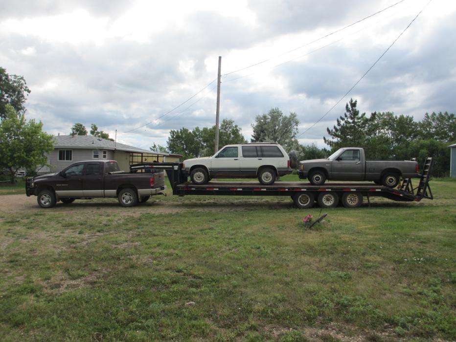

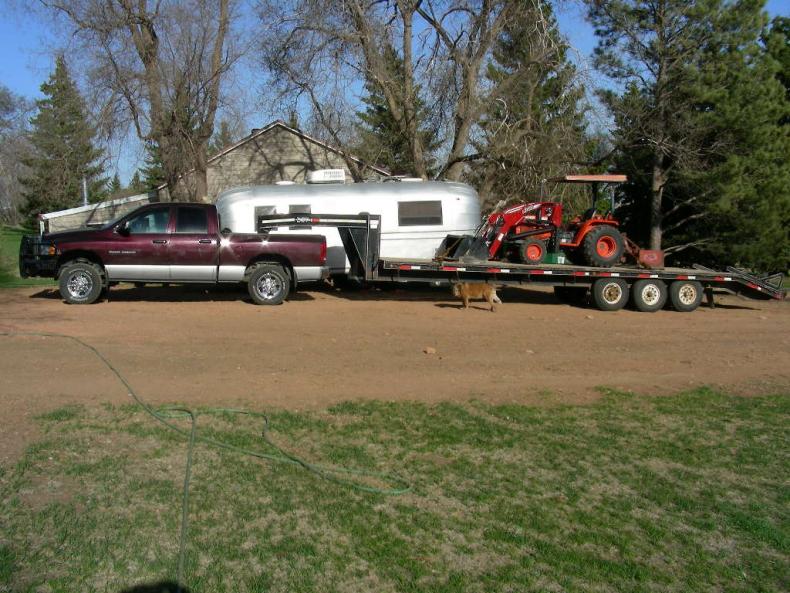

Trailer - 1995 DCT three 7K axles 26 foot deck with a 4 foot pop up dove tail so I have 30 foot total length, full 30 foot flat bed when the beaver tail is popped up.
Everything gets held on with 2 half inch chains and 2 chain binders.
