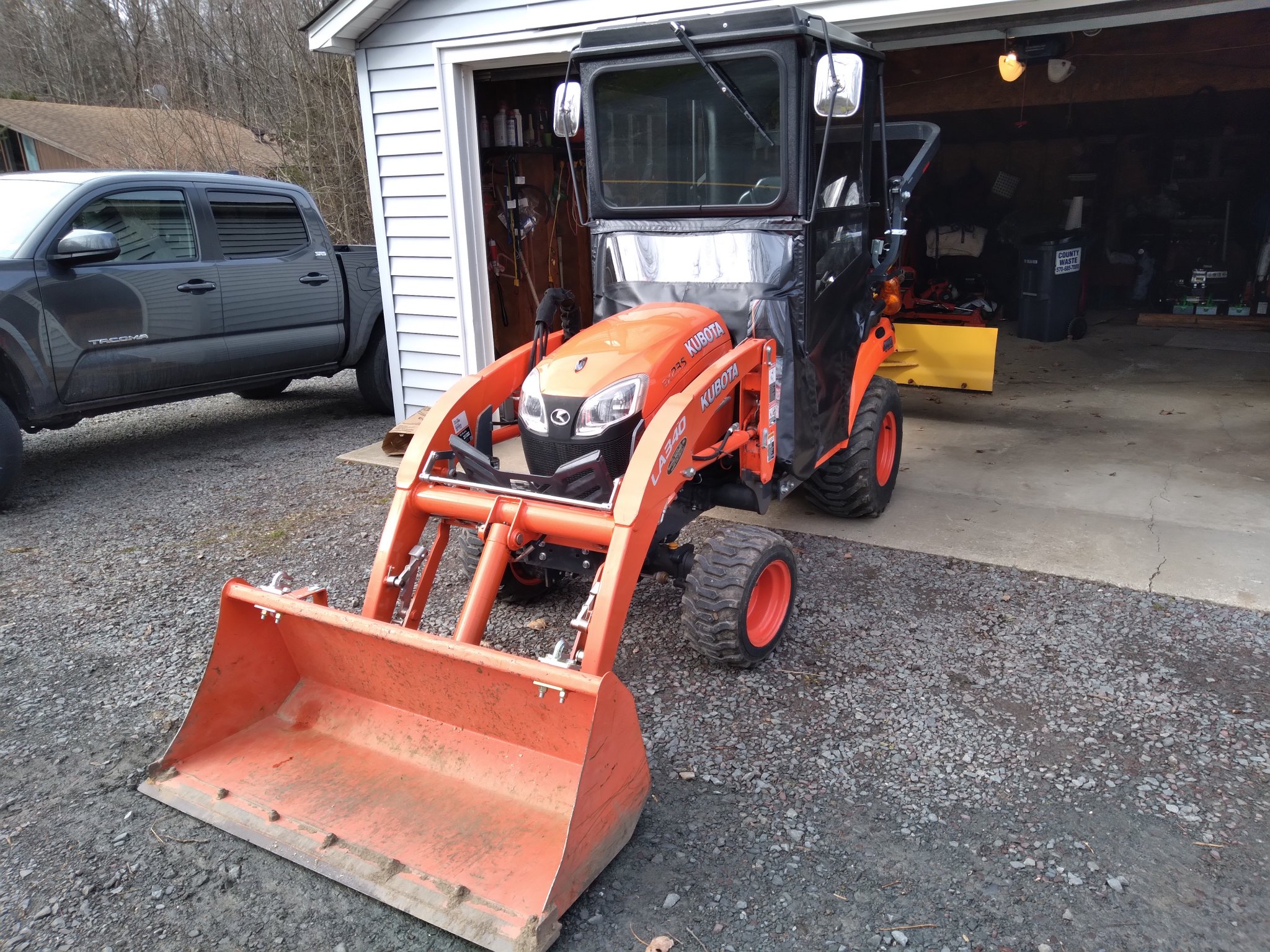

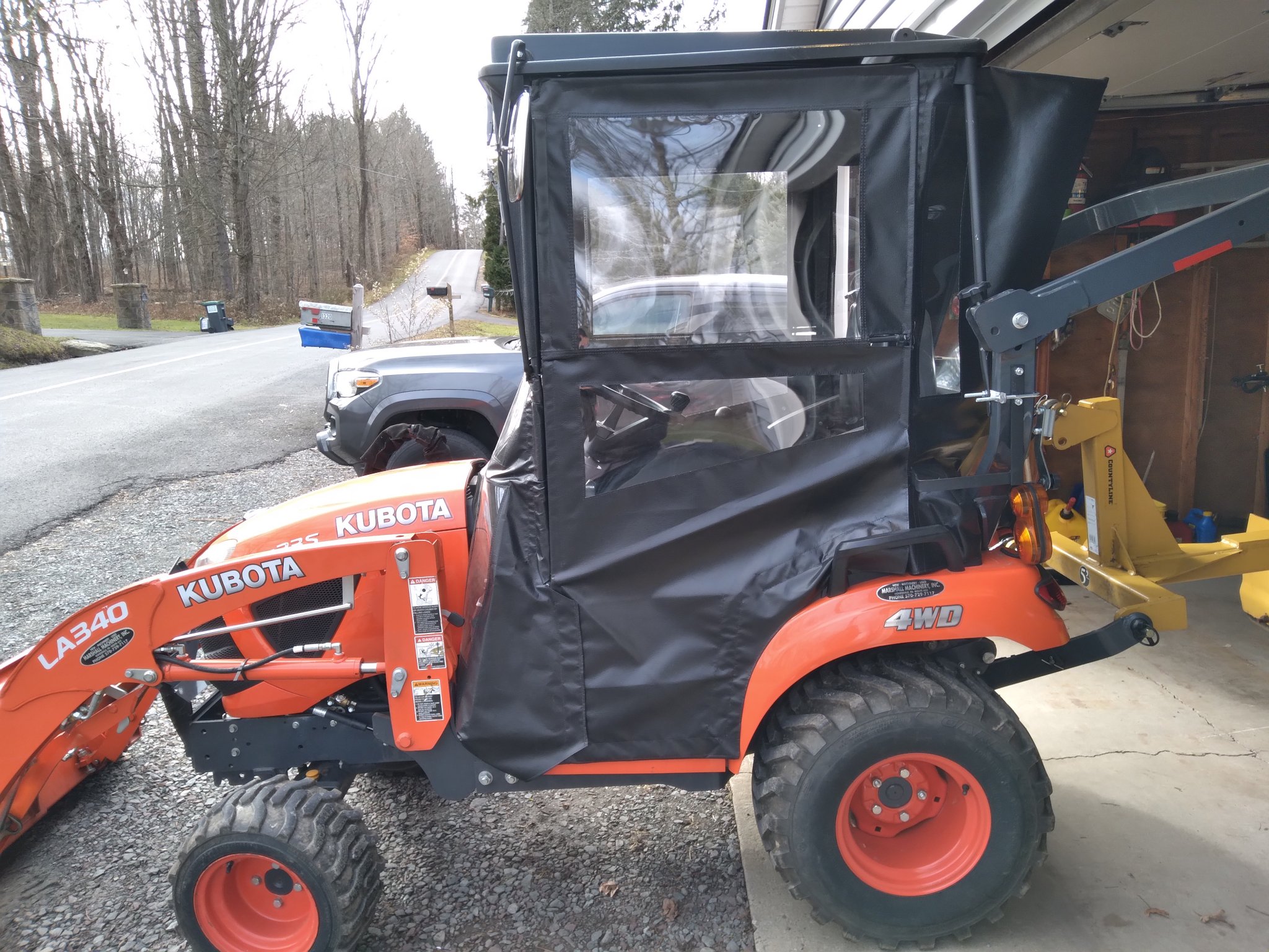

Here you go Jay! Not the $7000 model but its WARM in there

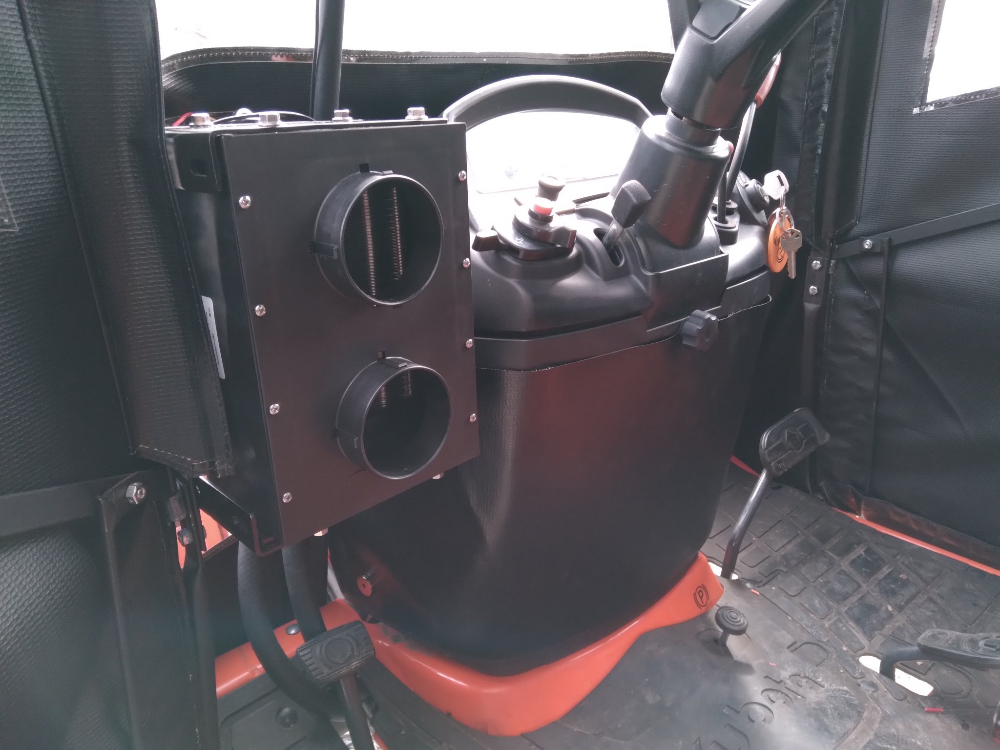

Heres the heater

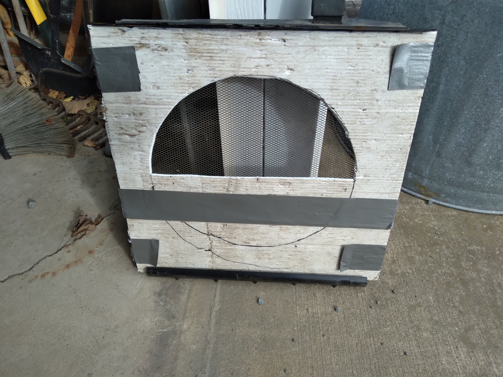

I have this much of the screen covered. 39 degrees heater off 2500 rpm's and no sign of over heating!

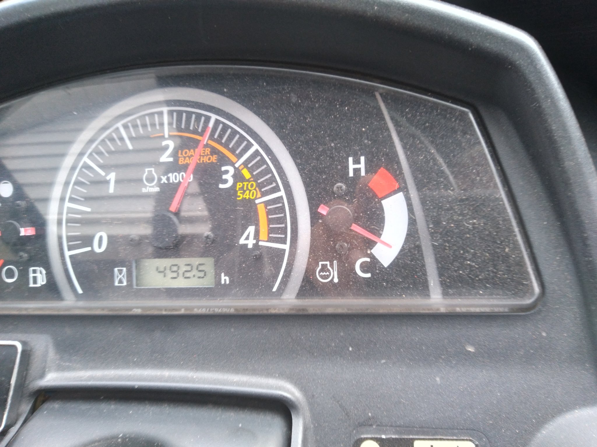

View attachment 70837 View attachment 70839
Lou, That looks great! Nothing wrong with that cab setup. Same heater as I use. It would be nice to come up with two rotateable deflectors for the round heater openings. You'll maybe find that the hot air blowing right on the one leg gets uncomfortable after a while. Still nicer than freezing in the winter, though. If I come up with something for mine.....I'll let you know.
Somewhere on OTT it was mentioned that in blocking off part of the radiator screen in cold temps to be careful and do it evenly across the fan blade area. If not.....the fan blades might vibrate and may eventually weaken and fail from the constant "loading" and "unloading" as they move into and out of that covered area.
An easy alternative for you might be to cut a "bullseye" cardboard piece and apply it to the center of the your cutout area. The bullseye could be made larger or smaller depending on how much you need to restrict the air.
Or just make the centered cut out circle much smaller to start with (and no blockage anywhere in it). If it's too much restriction....just enlarge it. If not enough.....make another one with a smaller cut out circle. The idea being to equally "load" the fan blades throughout their revolutions. That was their theory, anyway. It would especially make sense if the screen being blocked was real close to the edges of the fan blades. As easy as changing the design is, better to be safe to try prevent something that might happen.
Did you hook up your heater supply hoses in place of the water pump bypass hose? And I agree with you too. I don't think I could overheat the B2650 in the winter time here......especially with the cab heater going. There's still alot of openings underneath the tractor for outside air to get in and get moved around by the engines fan.
