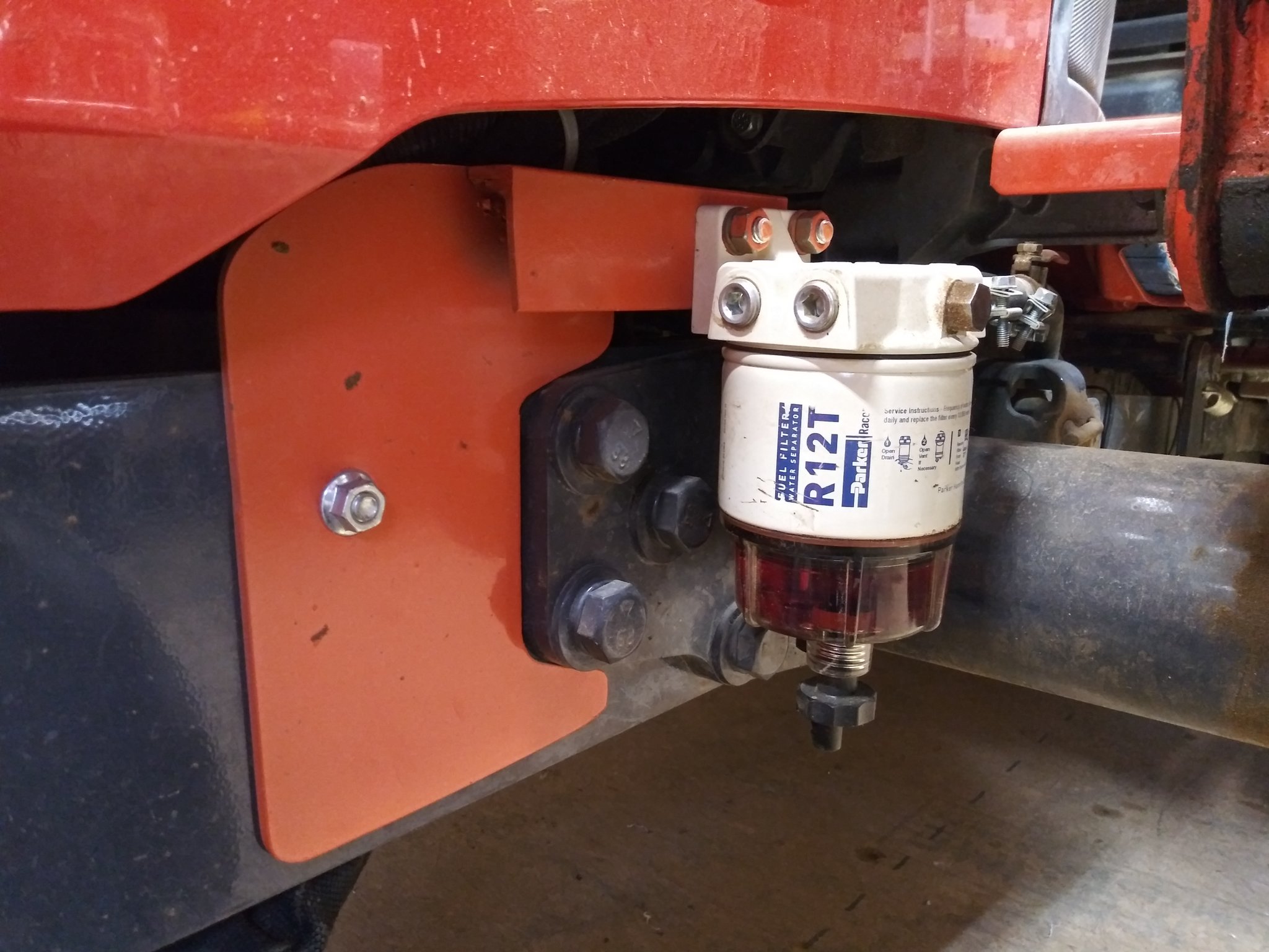

1st time I took that ##@#$$%%## fan shield off - I too cussed, then getting to the first filter - that was fun - NOT. I did get smart however, I had in my hand a 1/4 turn ball valve that I placed on the end of the fuel line!!! After that it was simply a huge pain to get down and under and what not.
Back in March when they shut schools down - I got to thinking, I ought to go ahead and fix this piss poor thought of the primary filter. Again I had all my ducks in a row and rerouted the entire filtering system.
Several people rerouted the pump too - I left mine where it is. I moved the primary filter to the front with the ability to drain off any water and sediment using a racor filter.
I will tell you this - to reroute the entire thing is just as fast as changing the first filter! It does cost more - but it is a "one and done" deal too. Whatever method you choose for your primary filter - move it to the front with some added hose, cutoff valve and you never need to climb under again. (other than to change the pump - if you choose to leave it there)
