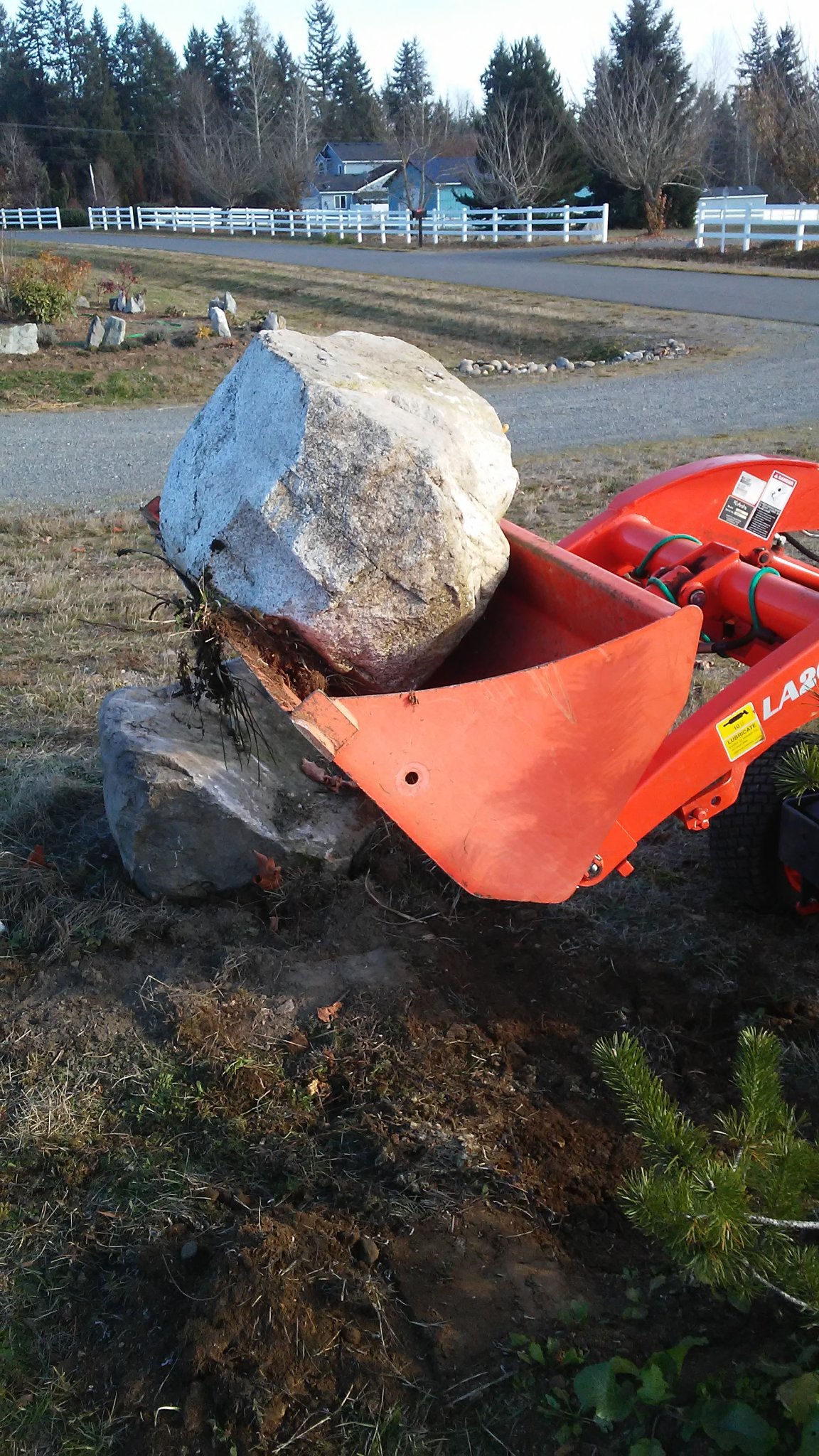

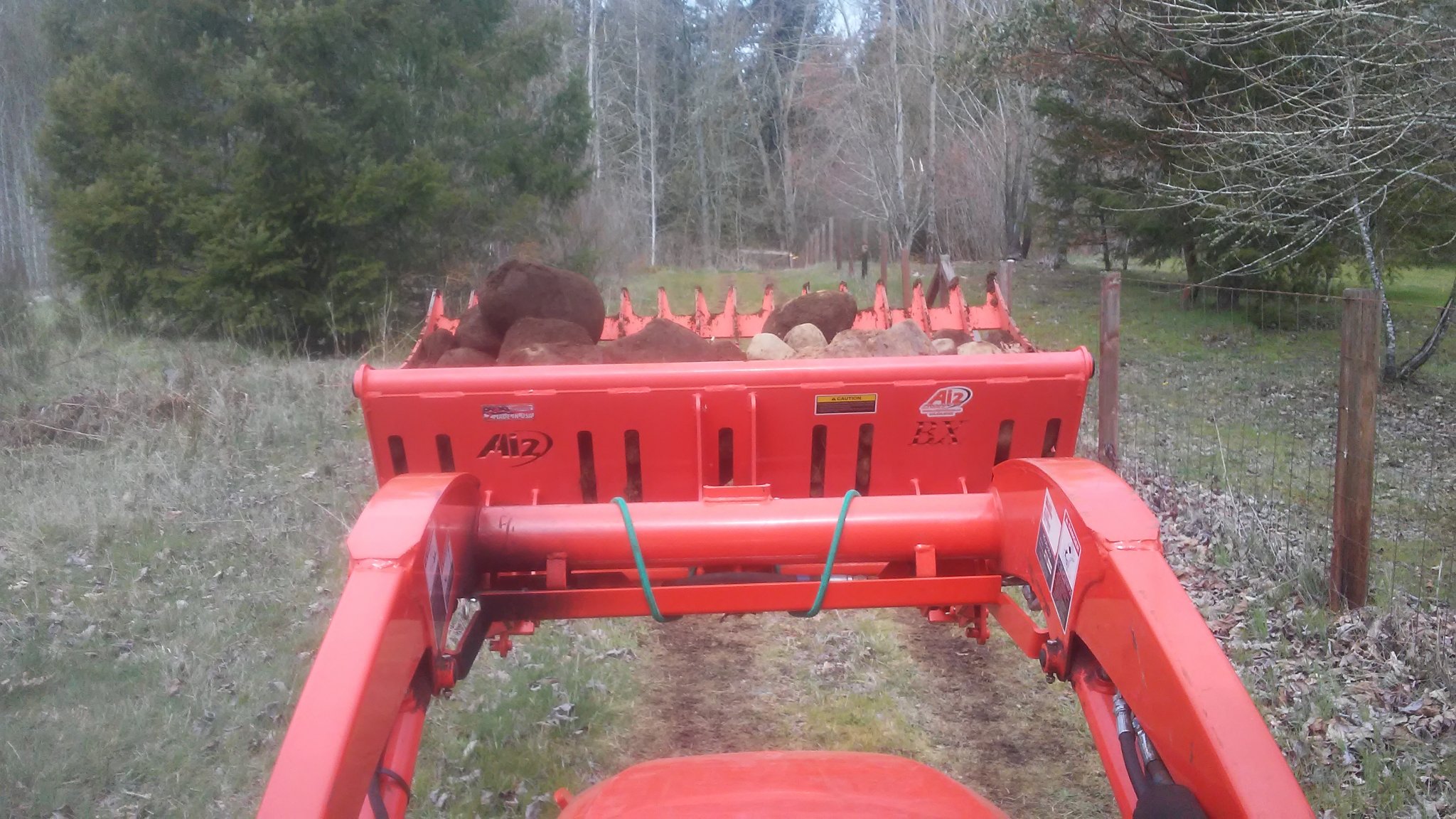

My BX1860 can lift heaping buckets of sand, gravel, rocks, all day long. I don't have any pictures of lifting sand or gravel but here are some of it with rocks.

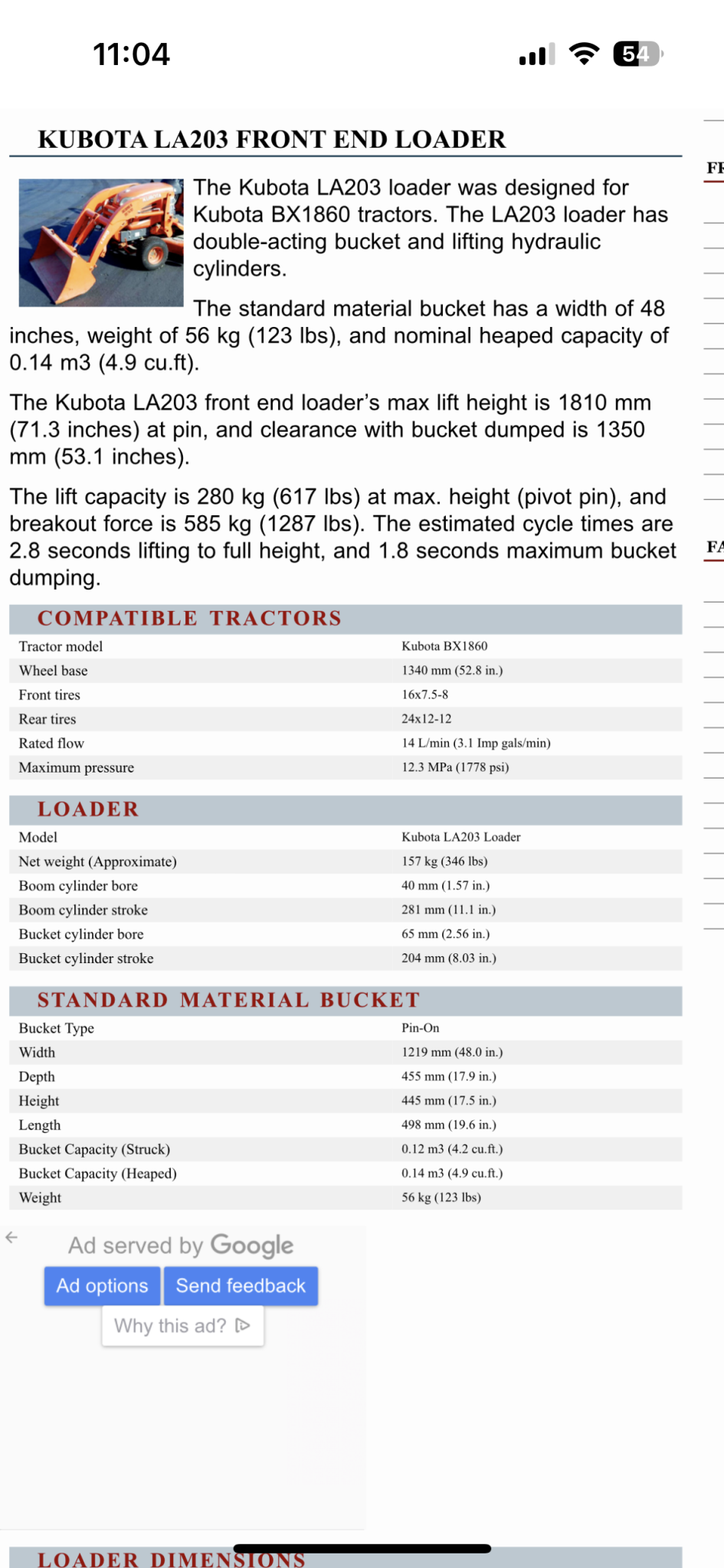

Your bx1860 has a LA203 loader and his bx23s I’m assuming has a LA340or LA340s depending on quick connect or not. Your bucket is 4.2 cu.ft struck or 4.9cu.ft heaped. The LA340 is 4.6cu.ft struck and 6cu.ft heaped. Both look to have the same lift capacity so that extra cu.ft is gonna affect a load. No idea what those rocks weigh in your pics but looks like your bx has it covered. It’s more about the loader model and less about the bx.

Your bx1860 has a LA203 loader and his bx23s I’m assuming has a LA340or LA340s depending on quick connect or not. Your bucket is 4.2 cu.ft struck or 4.9cu.ft heaped. The LA340 is 4.6cu.ft struck and 6cu.ft heaped. Both look to have the same lift capacity so that extra cu.ft is gonna affect a load. No idea what ththanks ose rocks weigh in your pics but looks like your bx has it covered. It’s more about the loader model and less about the bx.

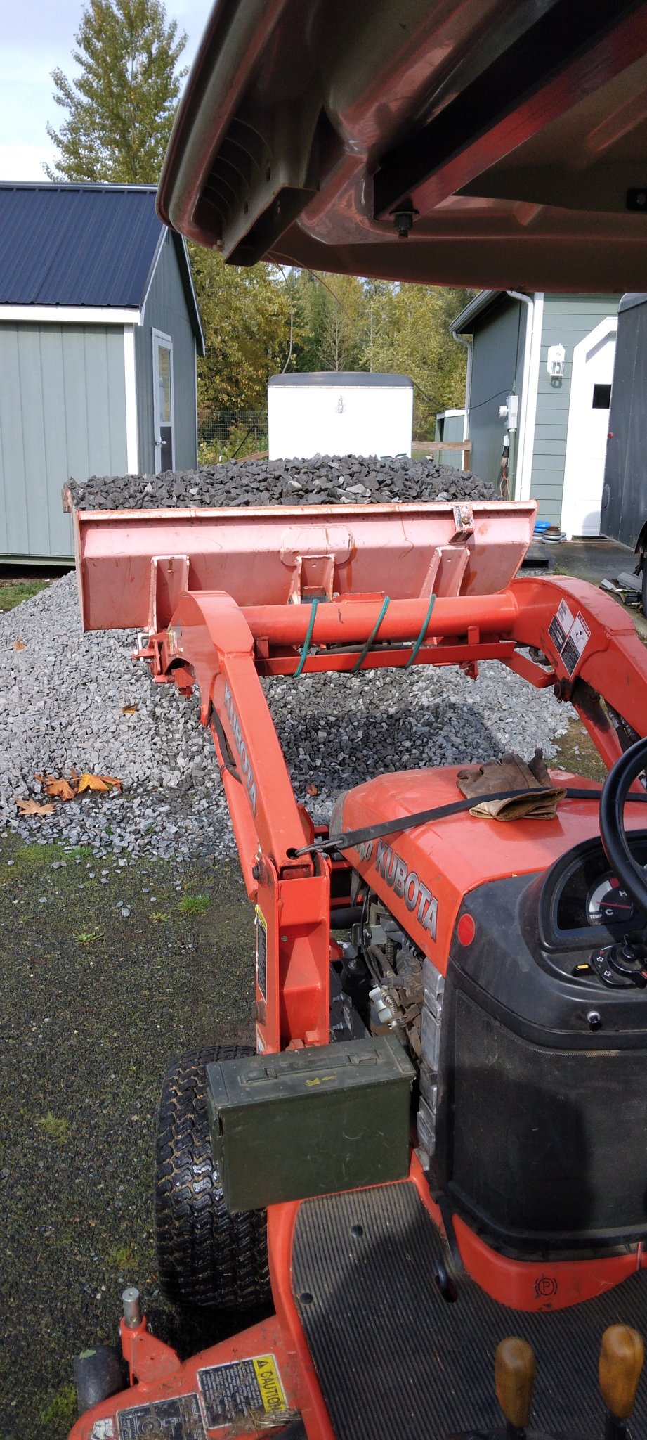

That is some great information. Thanks! My thought was that by the op's description he should probably check his hydraulic pressure. I was merely showing that a near similar tractor can carry heavier loads than what he described.
Today I happened to be doing some rock work after I posted those pictures. I took a picture of me lifting and carrying a bucket load of 1.25" clean blue rock. I also changed to my rock bucket which is the same size bucket he has on his BX23S. I am attaching those pictures. Maybe these are closer to the kind of loads he should expect to be able to carry.

Love the glove holder. I always seem to lose one....especially late fall/early spring

Standard retired army dude ammo can tool box. I got the 50 cal version. Holds more stuff
Yeah, I have the larger ones too but they don't fit where I have these mounted. I have one on each side of the tractor in the same position.
