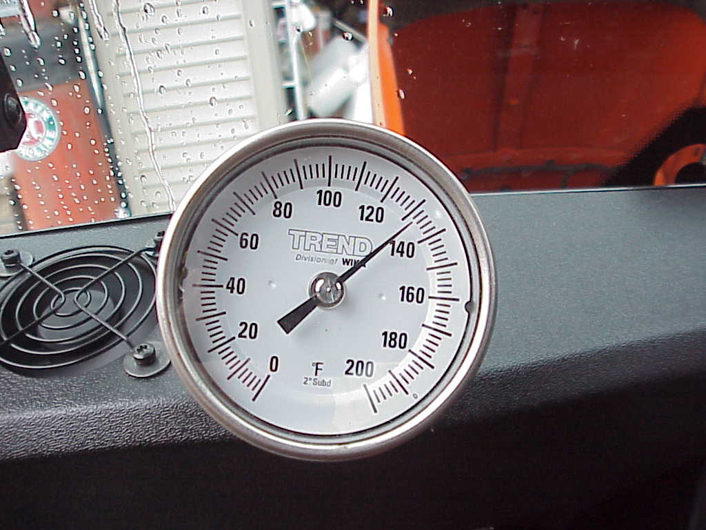

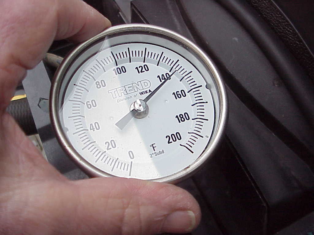

Today, I took the heater off of the tractor while leaving the hoses attached. I set the heater on the ground alongside of the front wheel, and it did belch out some air. I then filled the radiator and reinstalled the heater. I now have 132 degree air moving out of the vents, and I checked the temperature of the coolant at the radiator. It is 144 degrees. I then blocked one-half of the radiator screen with a piece of cardboard, and it didn't make any difference in operating temperature. I do have heat, but it isn't that great. I called my dealer service department and was told that I shouldn't expect the cab to be warm like a car. I am not impressed with the quality of the heater, especially for the price.

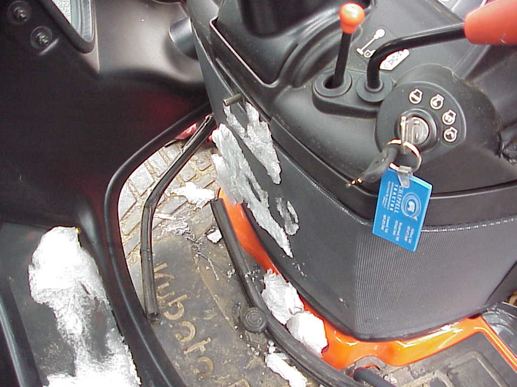

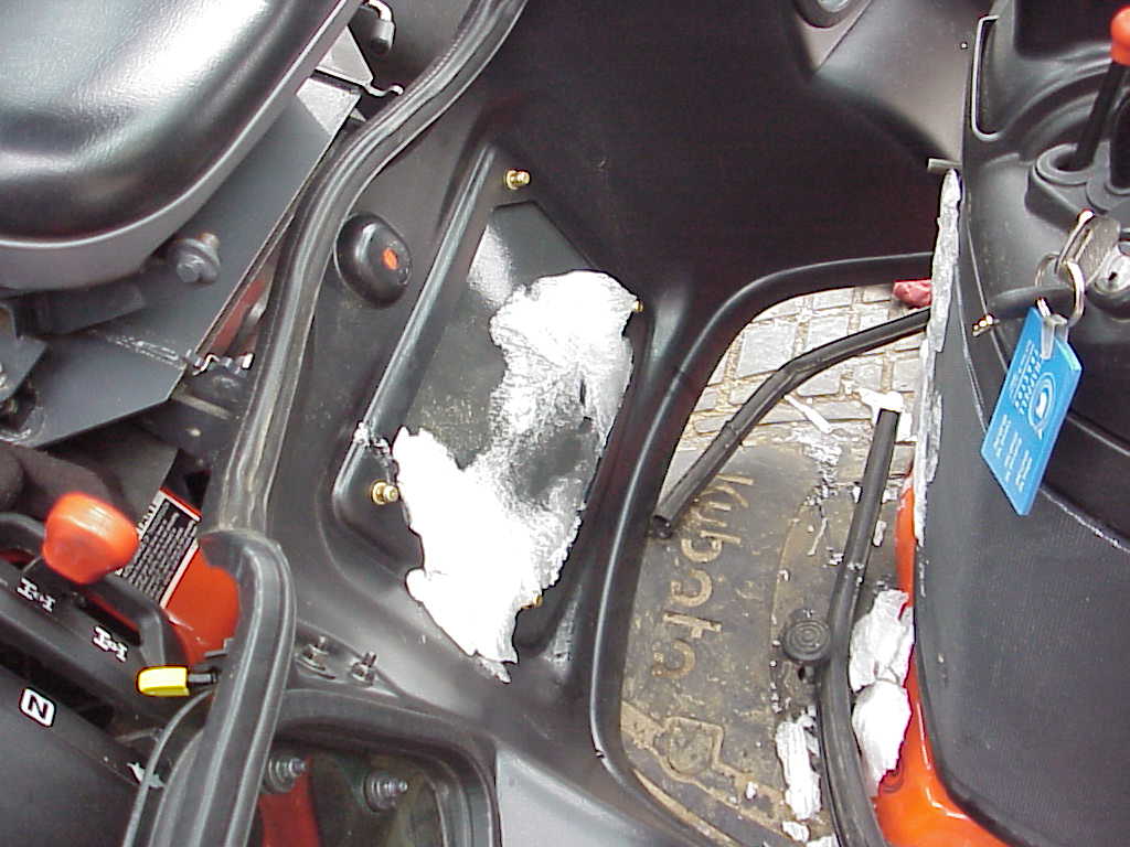

When I was removing the inside shroud, I found it packed with snow that came in from the side vents of the cab. MVC-001L.JPG MVC-002L.JPG MVC-003L.JPG MVC-005L.JPG MVC-006L.JPG
When I was removing the inside shroud, I found it packed with snow that came in from the side vents of the cab. View attachment 74344 View attachment 74345 View attachment 74346 View attachment 74348 View attachment 74349

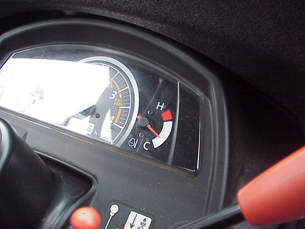

On my fabricobbled BX 2370 cab, I have about 75% (10" sheetmetal) of the rad debris screen blocked for winter use. I tried 50% but the temp gauge would only read 1 bar. With the increase to 75% I get 2 bars on the gauge, same as summer use. I'll check coolant temps and heater discharge tomorrow morning during warm-up before the snow removal fun starts.

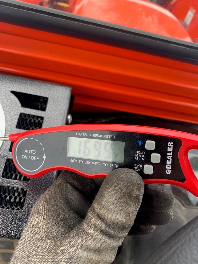

Dusty,
Just check my heater discharge temp on my home brew cab heater and it's running about 170F.
Radiator debris screen blocked off about 75%. Outdoor temp 19F.
Hope this helps.
