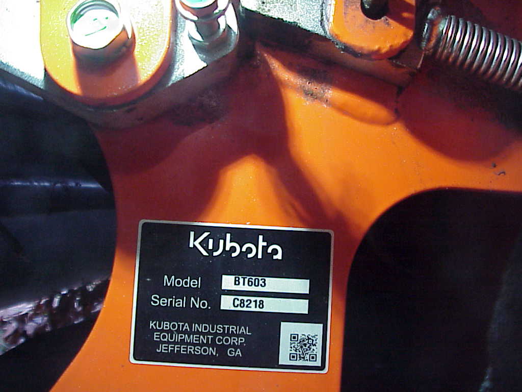

I think I posted a photo of the serial number. If not, here it is.

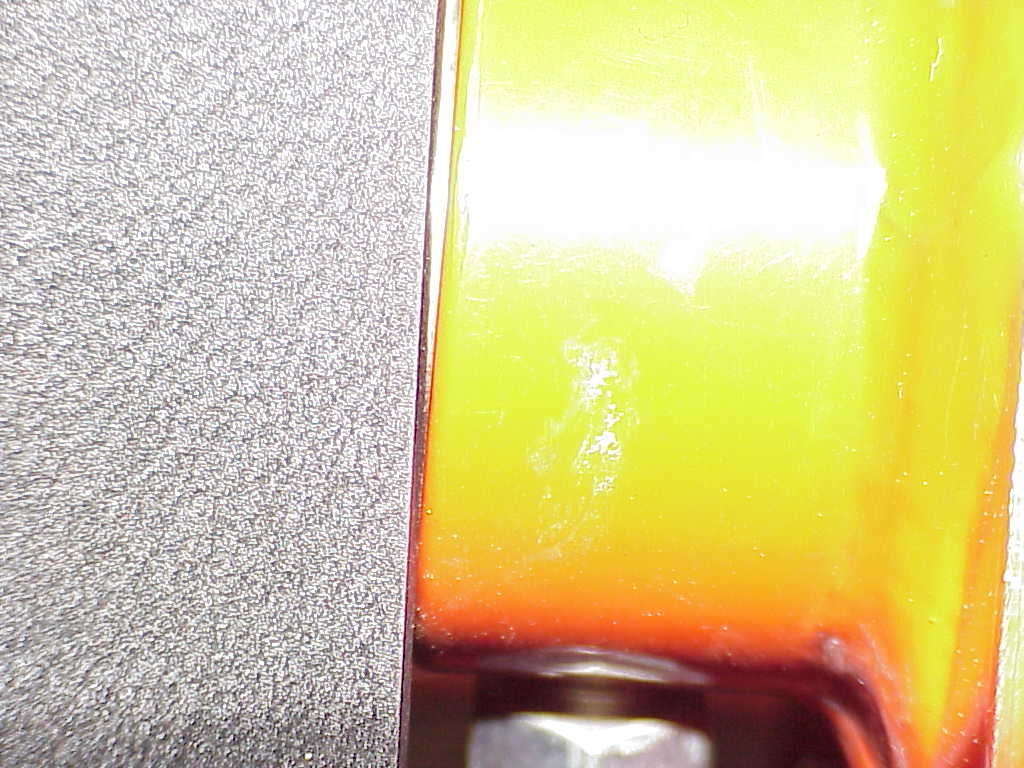

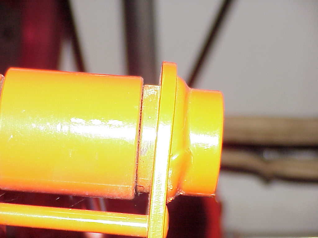

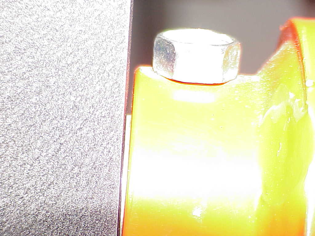

Yesterday, I moved my backhoe around in my storage shed to get another piece of equipment in, and I looked at the top of my backhoe to see if it was exhibiting what yours was doing. It appears that it is also splayed out at the top, albeit not as bad as yours. Today, I checked it with my straight edge that I use for checking cylinder heads for warpage. When I checked the right side of the hoe, at the upper and lower bushings, it was perfectly parallel. When I checked the left side, I can see that it is starting to bend outward. You can clearly see this in the pictures below.
MVC-008L.JPG MVC-009L.JPG MVC-010L.JPG MVC-011L.JPG MVC-012L.JPG MVC-013L.JPG
