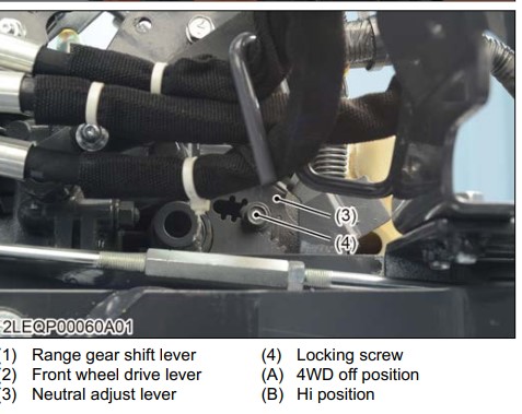

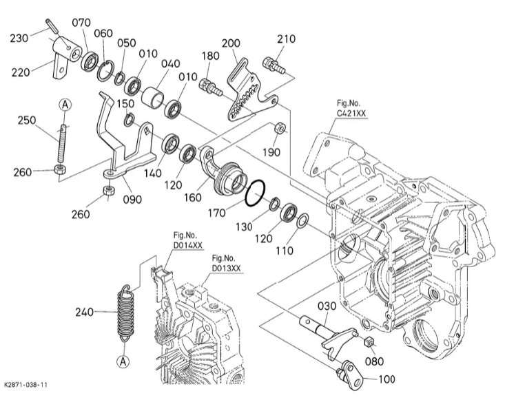

According to my service manual, if the tractor creeps a bit and requires touching the pedal lightly to stop it moving forward, I need to adjust the hst neutral position. I cannot find this adjustment on photo 2LEQP00060A01 items 3 and 4. where the heck is it? I have a 2021 BX2380

Try increasing tension on spring #240 be adjusting #250 via nuts #260.

According to the service manual with the photo I show to fix this you need to move to a slot closer to the front of the tractor. With right wheel off, I can’t locate that part to make an adjustment

I found where to make the adjustment finally. Not easy to get to.

4.2 Adjusting HST neutral position
CAUTION
• Park the machine on a firm and level ground.
NOTE
• When adjusting the HST neutral position,
loosen the locking screw approximately 2 turns
counterclockwise not to drop the nut inside.
1. Place the wooden blocks at the front and the rear
side of the wheels to prevent tractor from moving.
2. Lift up the rear wheels and secure with rigid jacks.
3. Remove the R.H. rear wheel from the tractor.
4. Shift the front wheel drive lever (2) to the 4WD off
position (A).
5. Start the engine.
6. Operate the engine at the maximum revolution.
7. Shift the range shift lever (1) to hi position (B).
8. Loosen the locking screw (4).
(Forward to neutral position)
9. Depress the speed control pedal to forward speed
position, and release the foot from the speed
control pedal. Check that the rear axle (or the
wheel) stops rotating. If the rear axle (or the wheel)
does not stop rotating, move the position of the
locking screw to
the machine front side to stop
rotating.
10. Depress the speed control pedal to reverse speed
control pedal. Check the rear axle (or the wheel)
stops rotating. If the rear axle (or the wheel) does
not stop rotating, adjust the locking screw (4) to
stop rotating.
11. After adjusting the neutral position, tighten the
locking screw (4) securely.
