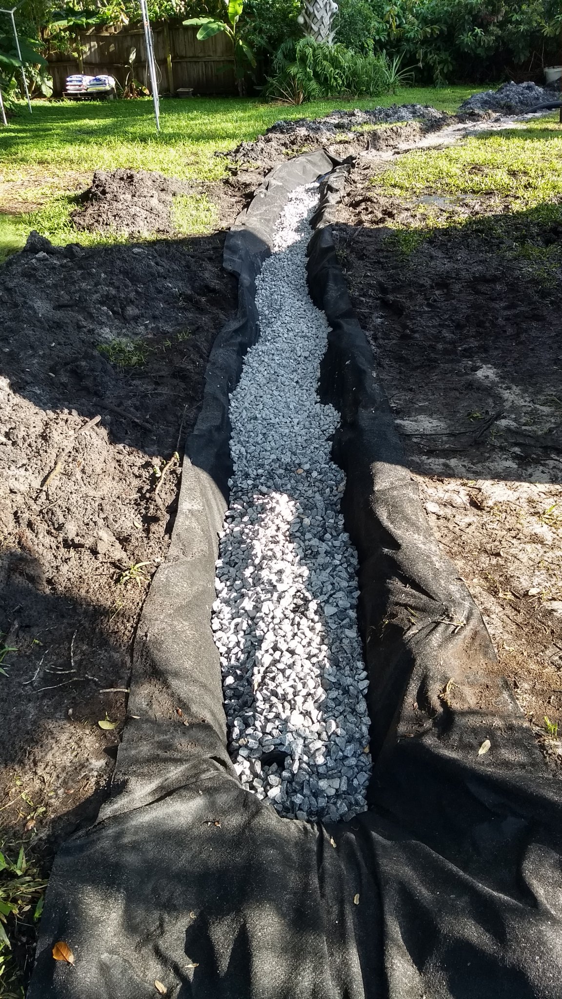

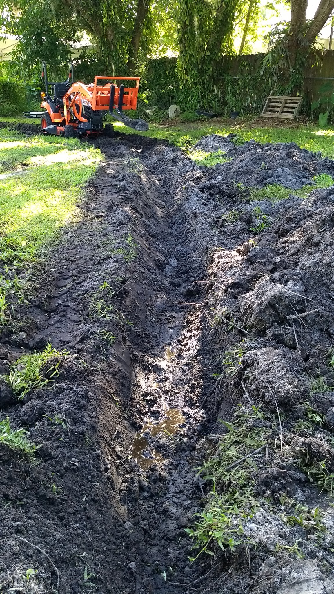

I put in a French drain, over 100 feet long about 18 inch deep, with my BX1880 using a spade to dig that attaches to the forks. I used a hitch mounted ripper to tear the roots.
Well you learn something every day. Before I clicked on the hyperlink, I legit thought you had attached a shovel to the front of your tractor. "No way!" I exclaimed as I zoomed the photo to take a closer look.
