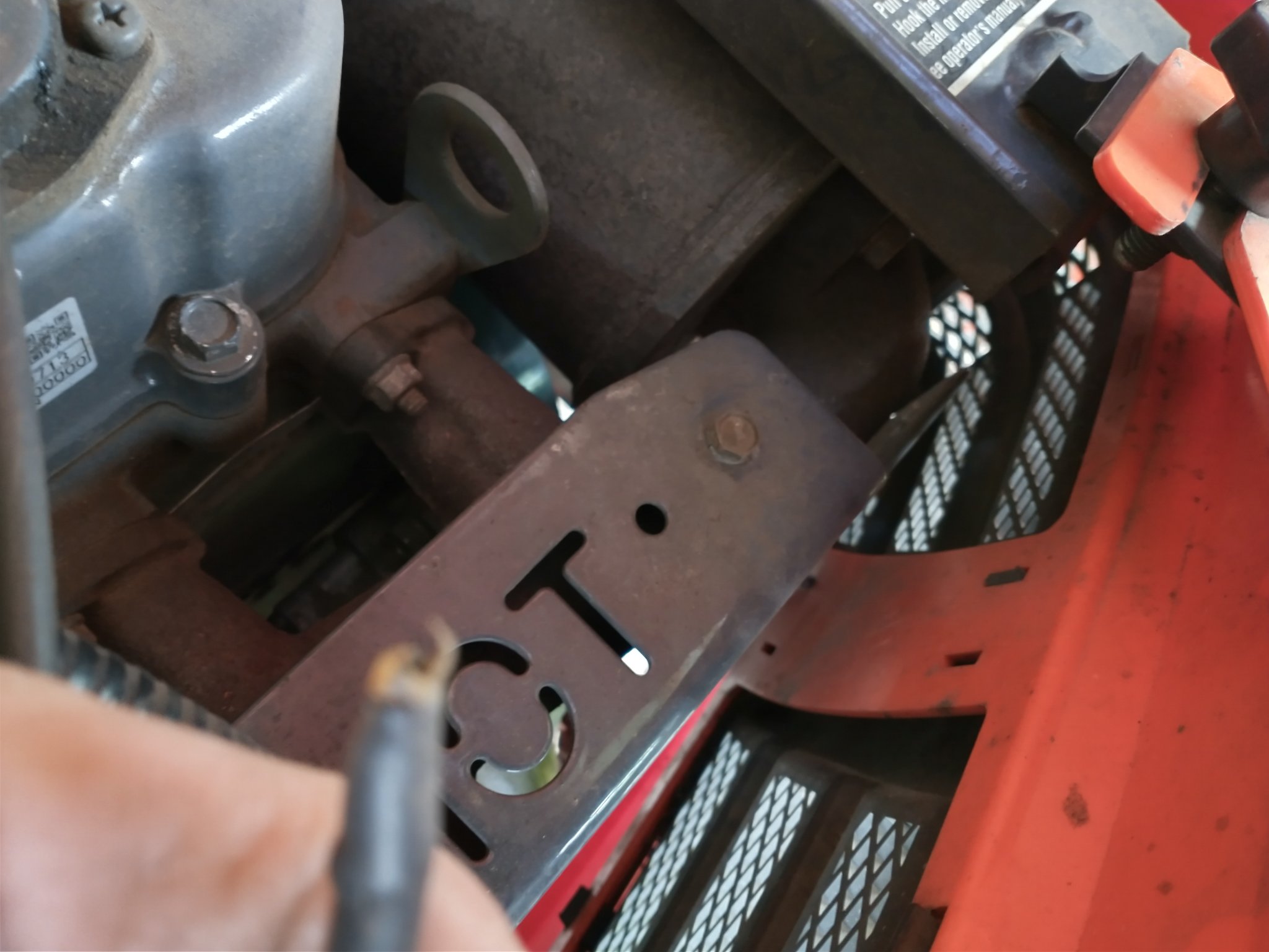

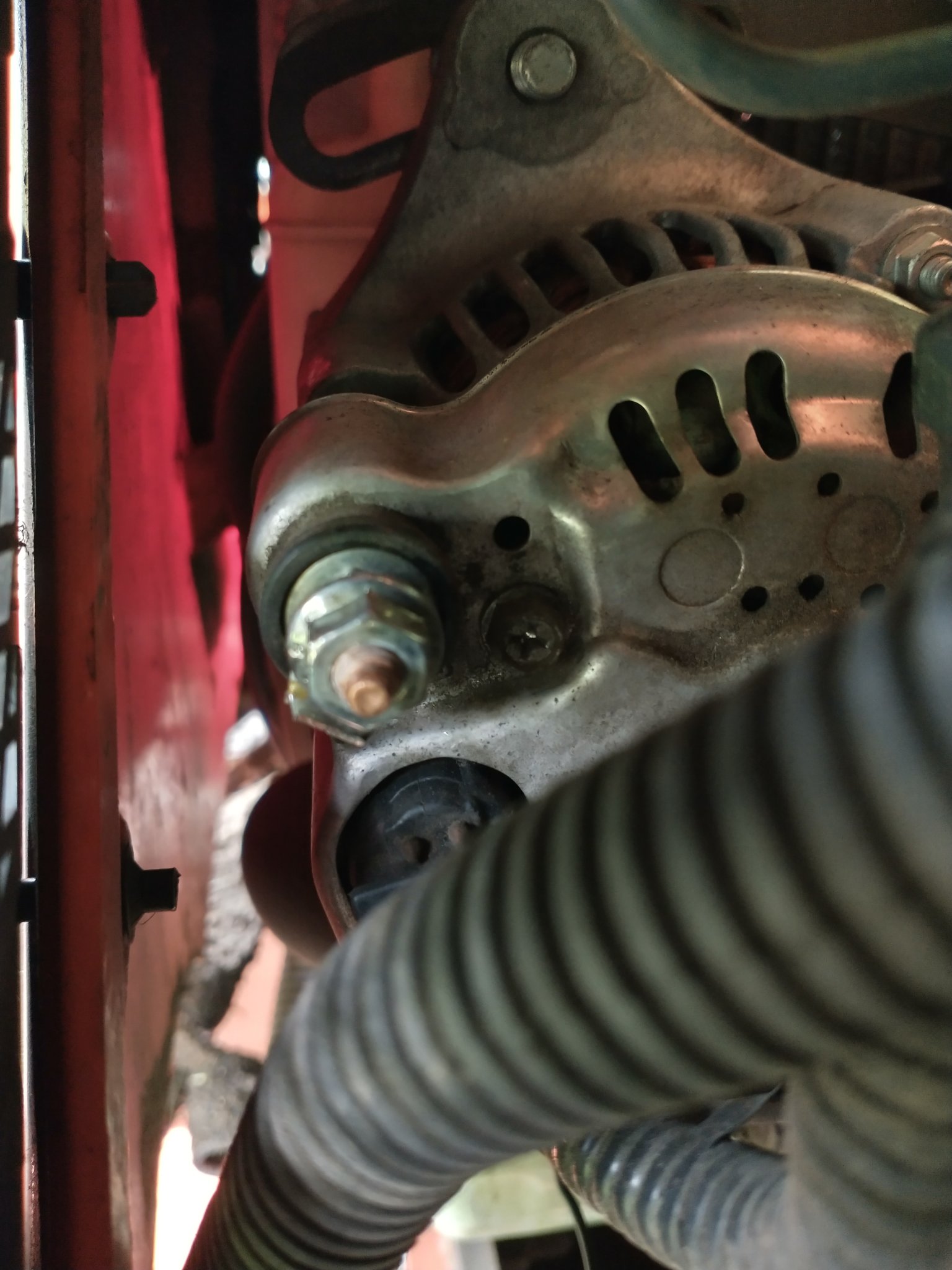

Thanks guys, after a few days hiatus for birthdays and a wedding, finally got back to work. The folks at my local local Kubota dealer(Bentley Bros in Brockport NY) are gems. Printed out a schematic for me of electric system. Traced all the wires, education in itself, while tracing wires the boot on alternator came off with a broken connector inside boot . No connection was being made. Repaired wire put new crimp connector on wire and battery finally read 14 volts running on meter. So longer story longer, saved purchase of new alternator and repaired for 10 cent connector. Appreciate everyones input.

Glad you found it! One of those times if you had been able to do voltage drop testing you would have found that when checking for drop between the alt and the battery. Still a good result not buying the alternator before finding.
