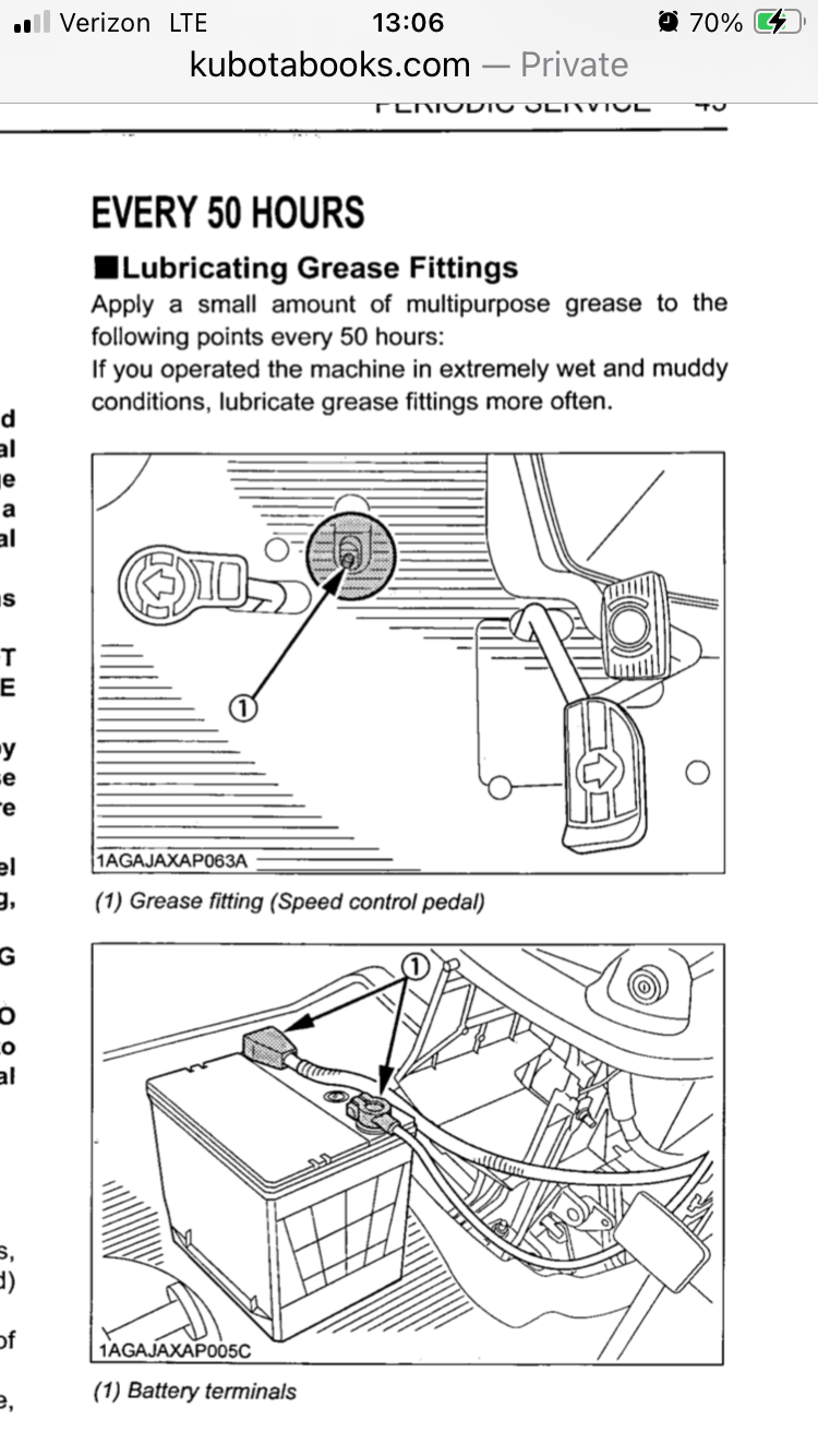

Have you been greasing the “speed control pedal“ every 50 hours per the owners manual?
10,941
2,768
Not a "gas" pedal ....it is a hydraulic fluid pedal - changing the flow of fluid flow.
As sawdust mentioned - there is grease zerk to be greased.

Yes I’ve greased it. Not sure if every 50 hours. But didn’t neglect it. Replaced the fluid with Kubota super UDT. I realize it isn’t a gas pedal lol

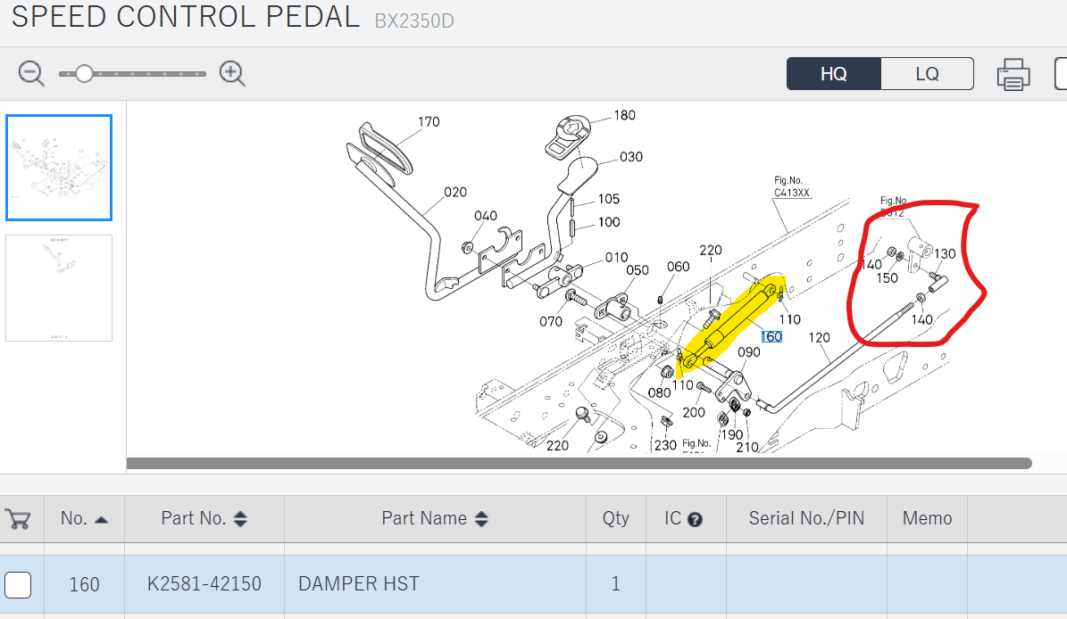

Sounds like you have an issue with the dampener, remove it and see if your problem goes away.
Also check the red circle that is known to come loose.
10,941
2,768
In NIW post the "nut" marked 140 is the problem - It backs off and causes slop in the movement.
Hard to get to - remove right rear tire to get a better look at it.
