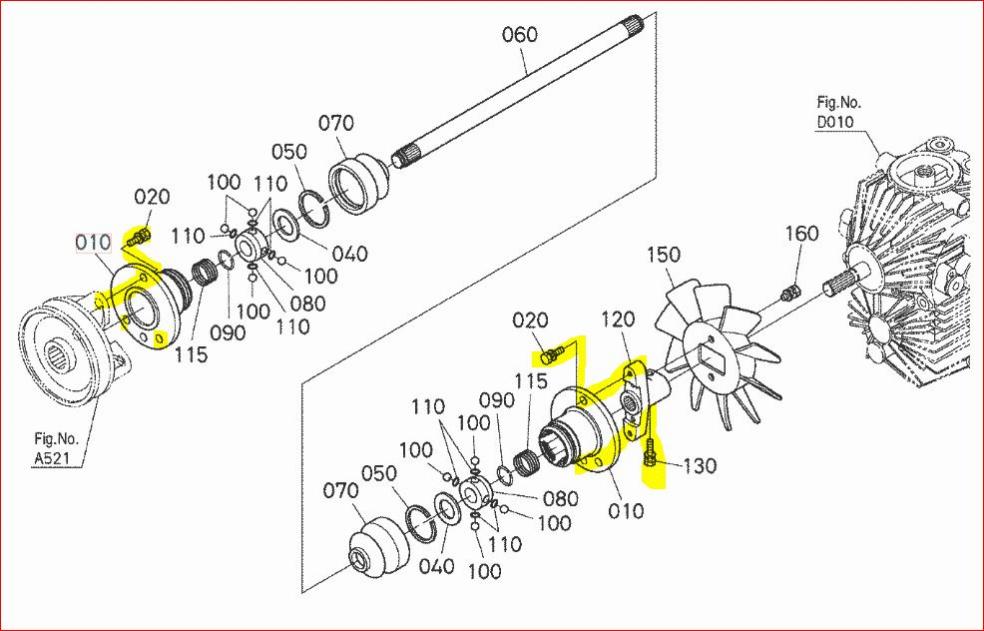

Sounds like you might have something going on with either (externally) with the propeller shaft, or (internally) with the HST unit.
ON the propeller shaft look for sheered or missing bolts.
If you can look for the fan on the front of the HST pump spinning while you try to move the tractor.

Thanks, I'll take a look at the drive train. Mine runs fine, BH, FEL works fine, just won't move. Funny thing is if you give full throttle, the tractor feels like you've taken it out of gear.
