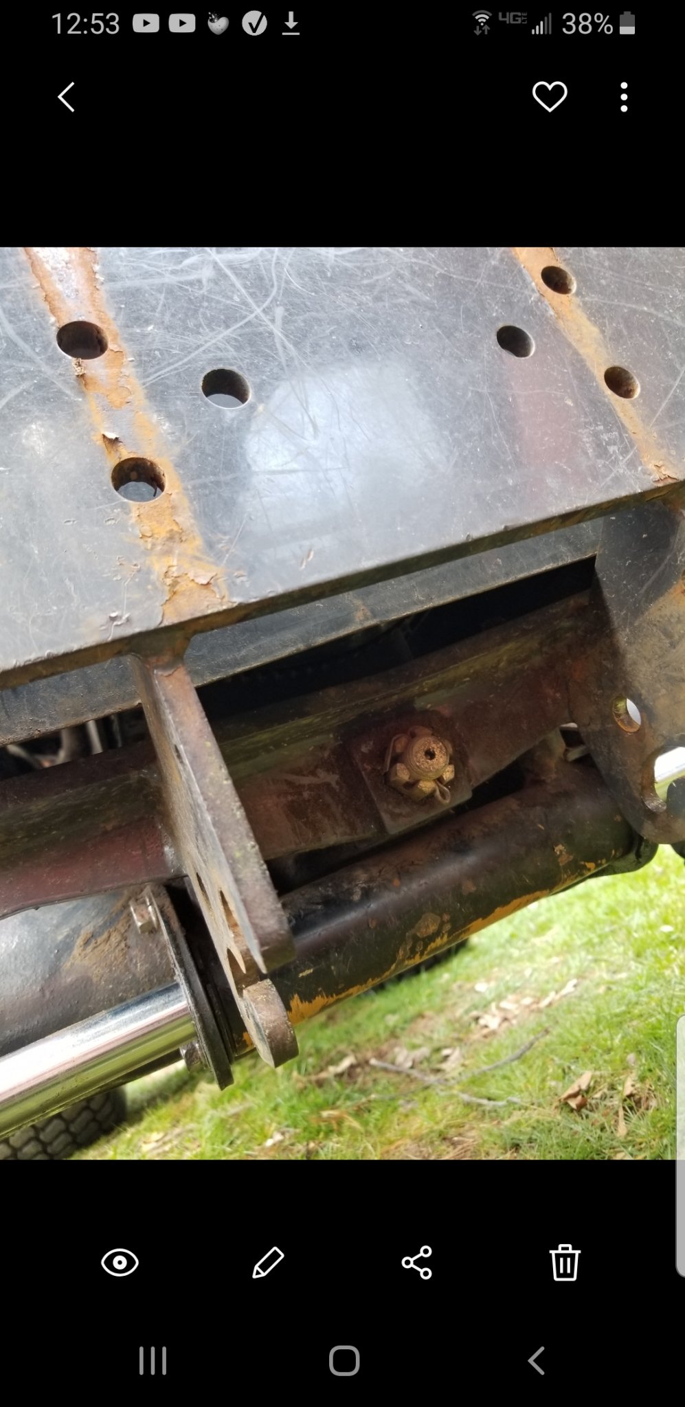

Hmm. Easy, huh?
It's spring. The steering was doing so well I thought I might be trying to send the part back, but in the midst of cleaning up 5 large pines that came down this week, it crapped out again and topping off the hydraulic fluid isn't fixing it this time.
I saw a video where someone changing the cylinder on a 2008 bx2350 said he had to drop the axel to do thre disassembly. I might be able to reach the hydraulic line on the left side (left as in sitting in the driver's seat) but the right line seems difficult/impossible to reach. I could use some guidance on this - do I need to drop the axel and how to do that? What's the best way to stop from losing all my hydraulic fluid. Any other tips would be great or links .

You do not have to drop the front axle, that would make the job several times more difficult. The RH hose fitting is accessible, sometimes you will have to remove the RH mounting bracket to lower the cylinder some to turn the wrench.
You will only lose the fluid in the cylinder, steering hoses, and steering valve. Maybe a quart at the most.
The inner tie rod ends are loctited into the cylinder shaft, you may need to heat the end of the shaft to break them loose. A small propane torch usually is enough. Use a couple of drops of Red loctite during reassembly.
Some unscrew the inner tie rods from the shaft before removing the RH mount, others take the outer tie rod ends loose from the knuckle and remove the cylinder with the tie rods attached. The assembly can then be done on the bench or in a vice. DO NOT CLAMP THE NEW CYLINDER IN A VICE!
After reinstalling the cylinder, start the engine, turn the wheel back and forth, stop to stop a few times, shut off the engine and top off your hydraulic oil level.

So it happened again. I was exploring how to do the disassembly, rotating the inner tie rod ends - it looks like you need to get a wrench on each nut so the cylinder doesn't just spin?
Anyway, after fiddling with it, I decided discretion was the better part of valor for today, and just went to put the tractor away for the day and darn if the steering didn't start working again, perfectly. Im thinking there must be a seal that pops in and out. I know I'll have to do this eventually.
