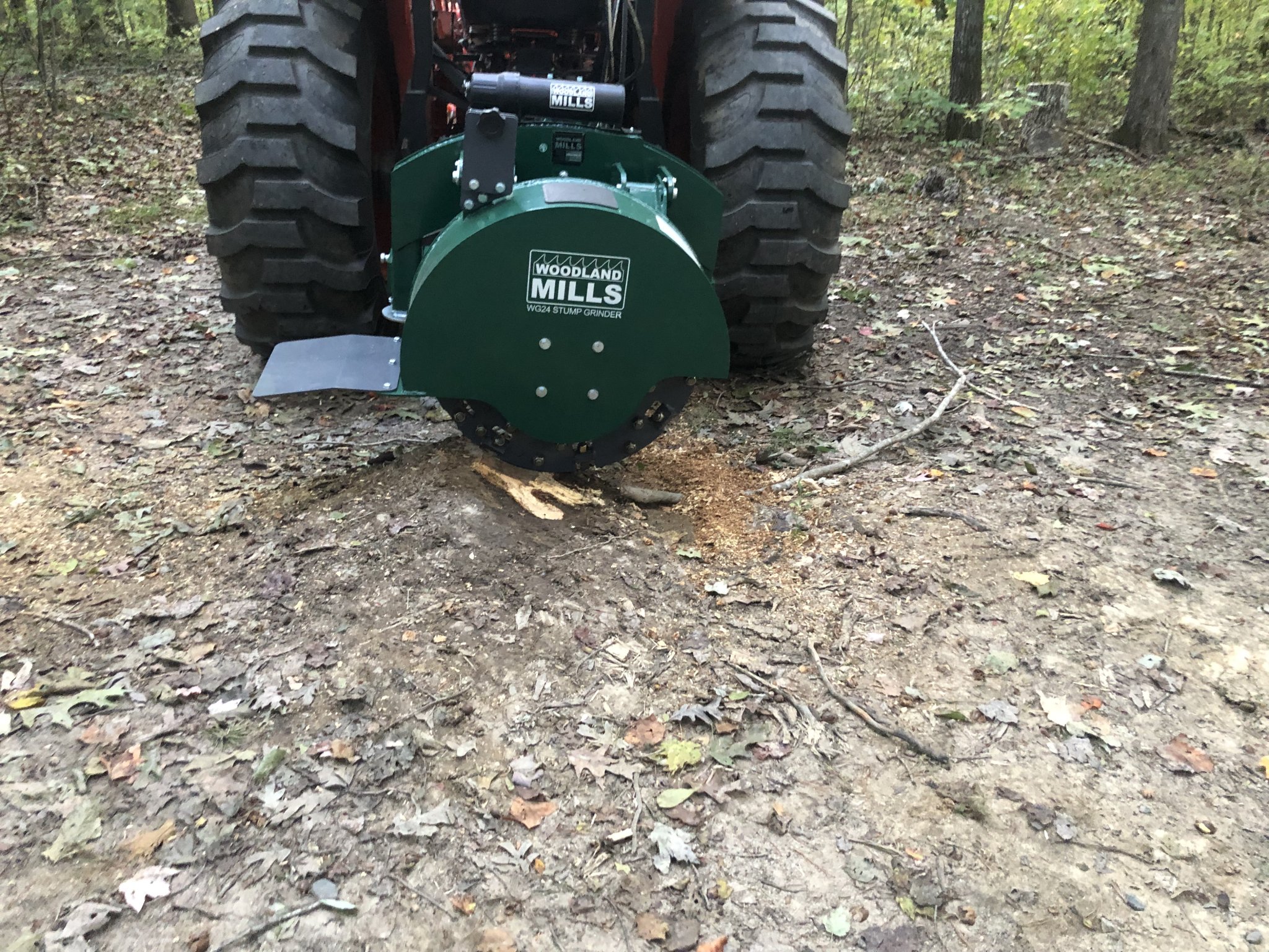

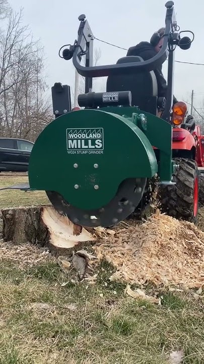

I have a Woodland Mills WG24.
Works well if you have the mass to hold onto it. There are several here with same or similar grinders. Maybe someone is running one on a BX?

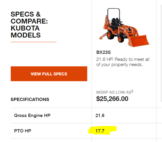

As far as pto hp when running any kind of a ‘blade’ or tool head the hp is not determining whether you can spin it at all, just how fast you can ‘feed it in’ to the work or feed the work into it. My 12hp b6100 will run a 48” bush hog or 54” finish mower just fine even though you wont find a 54” riding mower rated under ~25hp in the last decade. The only limitation is how fast i can travel while cutting. If it is super thick i have to go slow or limit the cut depth. But it works.
About the only limitation of pto hp vs an implement is if you have an extremely heavy rotating assembly on the implement and a very light rotating assembly on the tractor but only have an on/off switch for the pto, you may have to engage the pto at full rpm to avoid stalling the tractor with the sudden load of lurching the implement up to speed. If your pto runs on a clutch pedal you can ‘feather it’ to spin it up slowly. My old tractors have old school clutch-pedal pto engagement and if i dont mind the heat/wear on my clutch i can spin up pretty much anything with my <20hp. I just probably couldnt go very fast while using it.. 😅

I have a Betstco FH-SG24 I use on my BX2370. Yes, it's heavy and I have to be careful using it. However, I've used it on some pretty large stumps with success. It CAN throw the tractor around and there is a learning curve to using it. In spite of that I was surprised at how well the BX handled it. As with any piece of equipment, seems like using it GENTLY is the key. There is a picture of it on the trailer in the "Show your tractor on your trailer" thread.

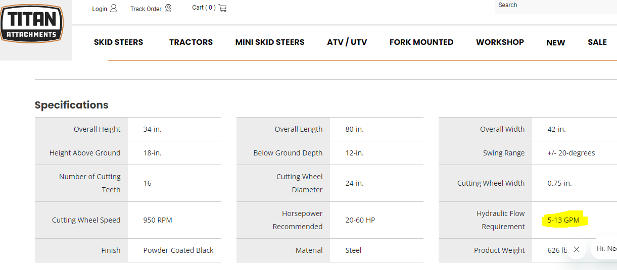

I am not telling you it is a good or bad idea.but here is some real life comparative data for perspective:
The guy I pay to grind stumps has a Vermeer SC252 stump grinder with 16" wheel. It's pretty small but eats stumps like a starved beaver.
The SC 252 weighs 1050 pounds and has a 26HP @ 3600 RPM 2 cylinder Kohler Command gas engine. The hydraulic system produces 3 GPM.
Your BX23s weighs 2800 pounds with loader and backhoe. Subtract 800 (probably less ) for the hoe and add 600 for the grinder and you are triple the weight of the fully dressed Vermeer.. Your tractor produces 6 GPM hydraulic flow which is double the Vermeer and more than enough for the two angling cylinders on that little 3pt grinder. You would probably want to add a valve that allows you to operate it from the ground like the Vermeer.
The only real concern I can see is the size of the cutter wheel. The Vermeer is 16" and the Titan is 24". You may find your a little light on PTO torque for a wheel that size and need to feed the cutter wheel a little slower.
I now have a WG24 on my L3901. It has already paid for itself and Tom's Stump Grinding has lost a customer
