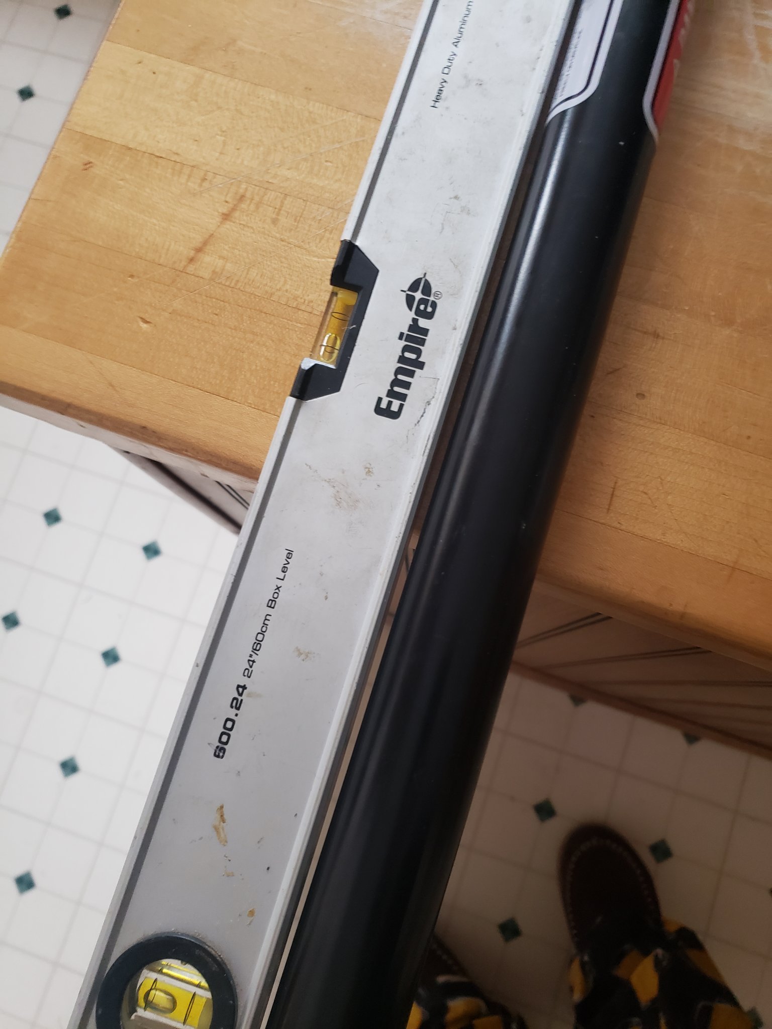

I'm in agreement. I must not have tightened the set screws down on the bearings to the shaft. Yes, the shaft shifted forward. Which kind of surprised me because I couldn't budge it. I had to remove the bearing housings to move the shaft. Removed the shaft, cleaned it up, looked it over.
However, It looks like this was all for naught. The shaft is bent. I checked it against a 2 foot level. I hope I can get a new one before we get any major snow again. Time to bust out the snow plow. I hope I can move some of this stuff after it's been sitting there freezing.
Thanks all.

glad you found the problem, real bummer though.
how bad is the shaft bent ? I've straightened some 'bent' shafts in the past. Depending on tools in your shop, you may be able to get it reasonably 'good' ( within 1/8th inch true )

All that I really have that may do it is a small bench vise. For the cost of replacement (~$300 on Messicks), I'd think a new one would be the safer move. I don't think it's over 1/8" out now.
12,966
5,689
If the vice is FIRMLY bolted to the bench and the bench bolted down, find the 'bend' point, secure into vice. Take a reasonably tight fitting long pipe, slide over the shaft and bend it 'some'. Look what happens,odds are you'll need more. It's a 'do and see' operation.
If the vice isn't strong enough... got a pickup with a 2" hitch? if so and the receiver is hollow, use it for your 'vice'. Same idea, bend the shaft in the opposite direction of the bend.
Sometimes you have to think outside the box, get creative, I've driven my forklift over steel to 'rebend' it
