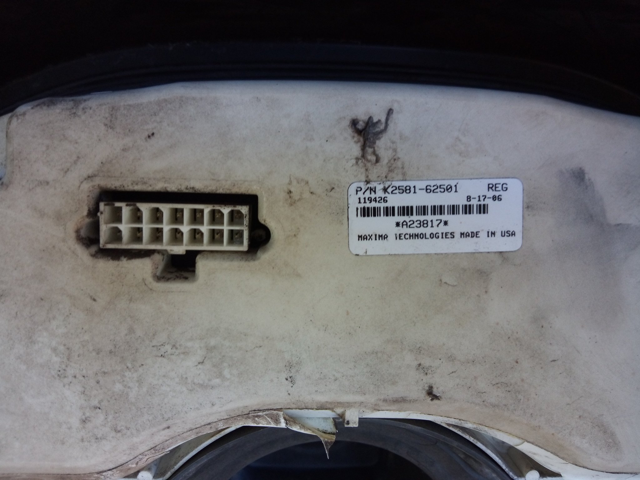

Hey - new instrument cluster is great. A nice upgrade. Unfortunately, I don’t have the original anymore, sorry!

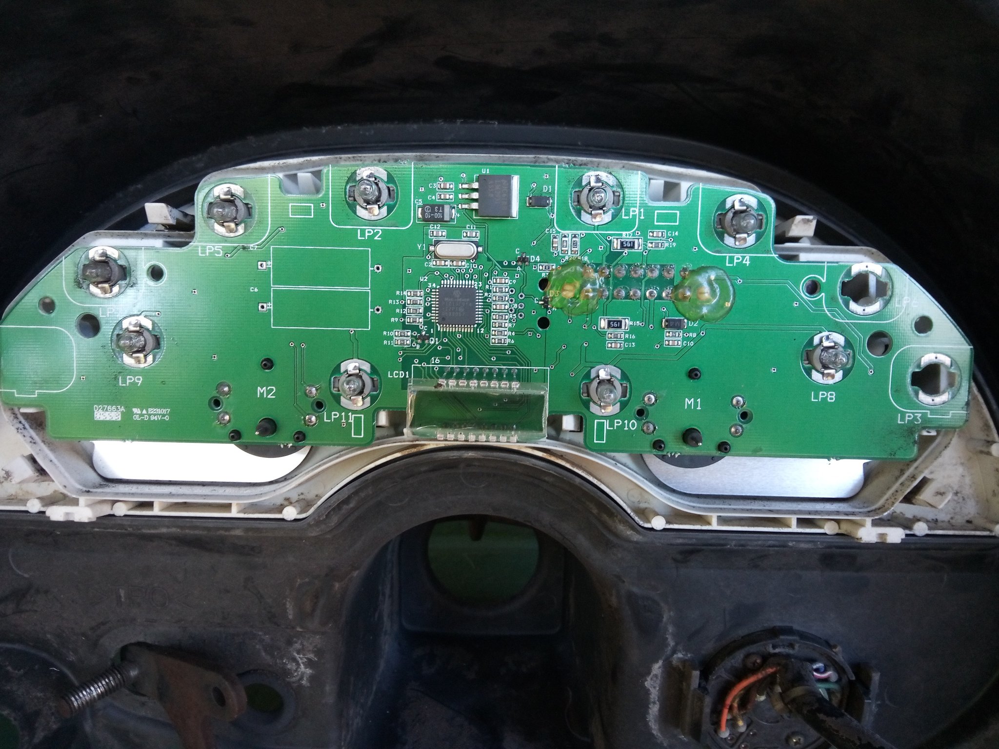

Wow! Look at all those highly customized off the shelf parts!
Sea Knights, eh? Cool. (y) I never got a ride on one of those. Just Hueys and Chinooks.
But back to your circuit board. Looks to me like possibly a capacitor blew up. The question is, why? Before you put anything new in there, make sure you go through your system and look for wiring problems. Poor connections, including grounds, can hide and cause lots of problems.
As toasted as that is, I don't think you are going to be able to repair it just by replacing a part or two. There is the real possibility that the board itself is damaged. You need specialized knowledge and tools for that kind of work. I suggest you try to find a company that does that kind of repair work. They are around.
Yes, Vietnam 1969-1970 search and air evac...the board isn’t a problem, I’ve spent the last 50+ years rebuilding and repairing PCB’s. It’s information about the missing part I don’t have.

yes, sure looks like cap c501 blew up....
it'd be nice to see the other side of the board as above C501, there's some 'ZDxxx' writings. That may indicate Zener Diodes which suggests 'power supply' parts. It's unclear if the 'light smokey' color around the cap is water damage or protective coating. While I'd like to assume the PCB is coated to mimimize water damage, without seeing it in person, well..it's a guess. I know the early Honda Goldwing dashes had a thick coating, making it 'fun' to repair,but great money in that . You really need a good PCB to compare to though as a 'winter project' it could be repairable.

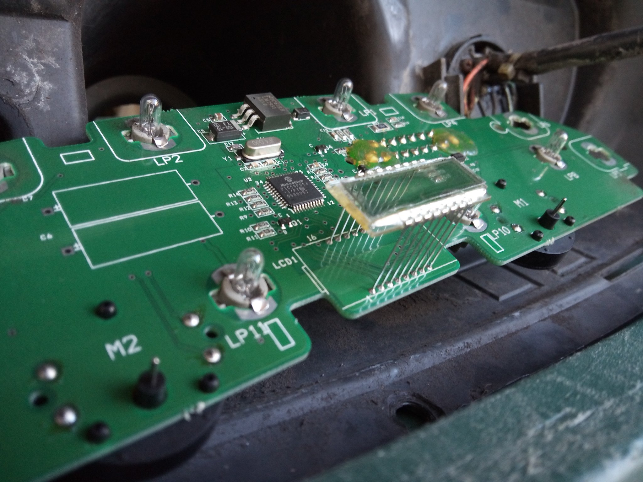

I have a BX2350 that has a failed LCD tach/hour meter display. A new cluster is over $400 which seems crazy considering I just need the LCD. I am considering reverse engineering the LCD, but need a working display in order to do so.
I can't be the only one with a black LCD. If you have a BX series tractor with a bad LCD display and would be interested in having your panel rebuilt at a reasonable price, please chime in. If there is enough interest then I will move forward with the LCD design.

to find the LCD, you'll need a good picture of it during the 'selftest', which lights up all segments of the display. it'd also be nice of a closeup of the PIC microcomputer to get the info off it.
It is possible to 'ring out' the connections between the PIC and LCD, that will 'decode' the actual LCD pin usage, which really narrows down the search.
The LCD will be a custom unit, not a regular 'off-the-shelf' item BUT there are surplus parts vendors who might have them. There 'should' be some info on the backside of the LCD,may be hard to read depending but it should be there.
