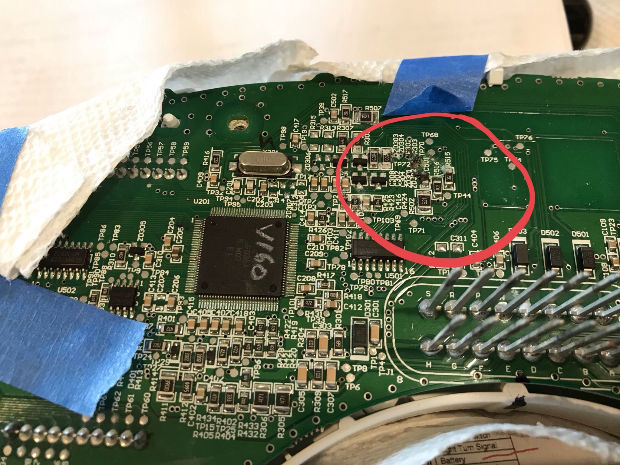

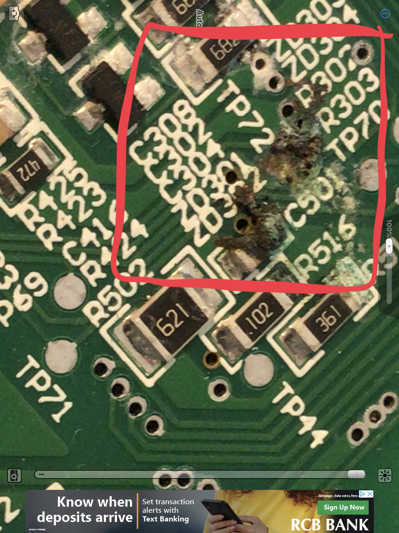

I don’t know if I’m out of order here but here goes. I have a BX2670-1 with a dead meter panel. I have located the problem but without a real schematic of the PCB or even a photo of a board with all its parts I’m unable to make repairs. I will try to post photos of the problem. It would be great if someone has or could get me a working photo of same area and/or part info of missing part.
any assistance would be greatly appreciated.
