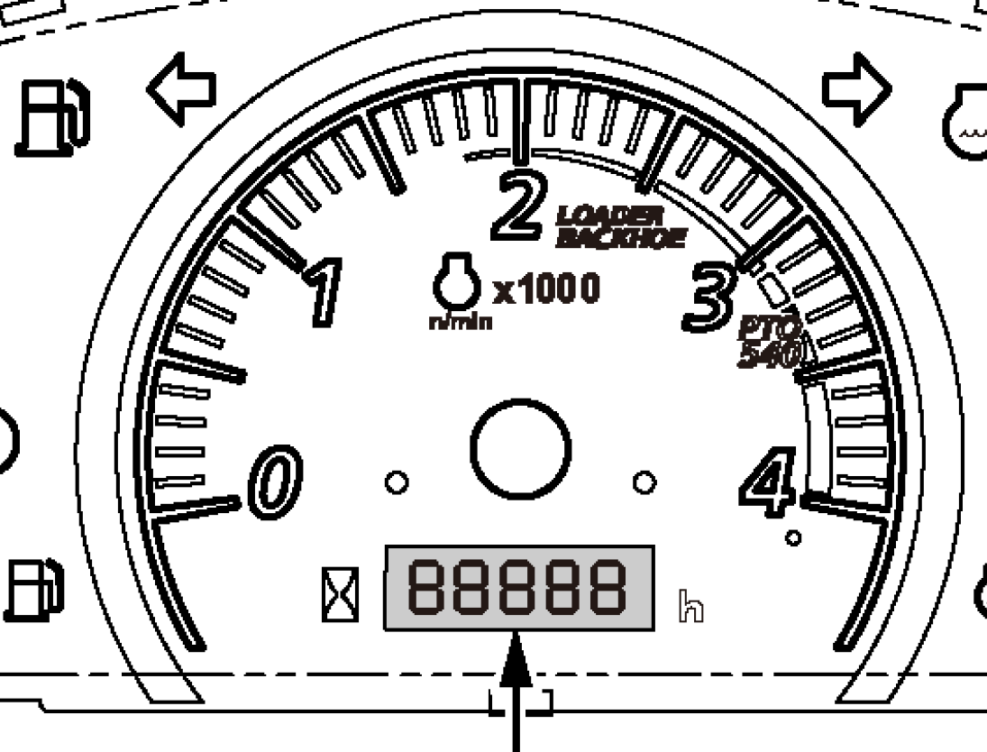

My manual for the BX2380 says to run the mid PTO @ 2500 RPM.
My manual for the BX2830 (not a typo) FRONT 48" commercial blower says to run at maximum RPM in heavy snow.
What do you guys do...vary RPM depending on the DEPTH/TYPE of snow you're dealing with?
I've been running around 3000-3100 as there was a little mark on the tach for "PTO" and I never gave it much thought until now.
(I do engage it at lower RPM's of course) (1500-1700)

Pretty sure your manual doesn't say to run the mid PTO at 2500 engine RPM, but does say the mid PTO runs at 2500 RPM when your engine RPM is the PTO mark on your tachometer which equates to about 3200 engine RPM.
You know, you could be right. Maybe it's semantics or the way I am reading the manual.
The tractor has a 540 rpm rear PTO speed and a
2500 rpm mid PTO speed."
PTO
Rear PTO
SAE 1-3/8, 6 splines
Revolution STD (540 rpm)
Mid PTO
USA No.5 (KUBOTA 10-tooth) involute spline
Revolution STD (2500 rpm)"

Yep, you got it. PTO RPM and engine RPM are different. Take a look at your manual for specifications. Not 30 minutes ago I went and looked at mine. Page 20.
