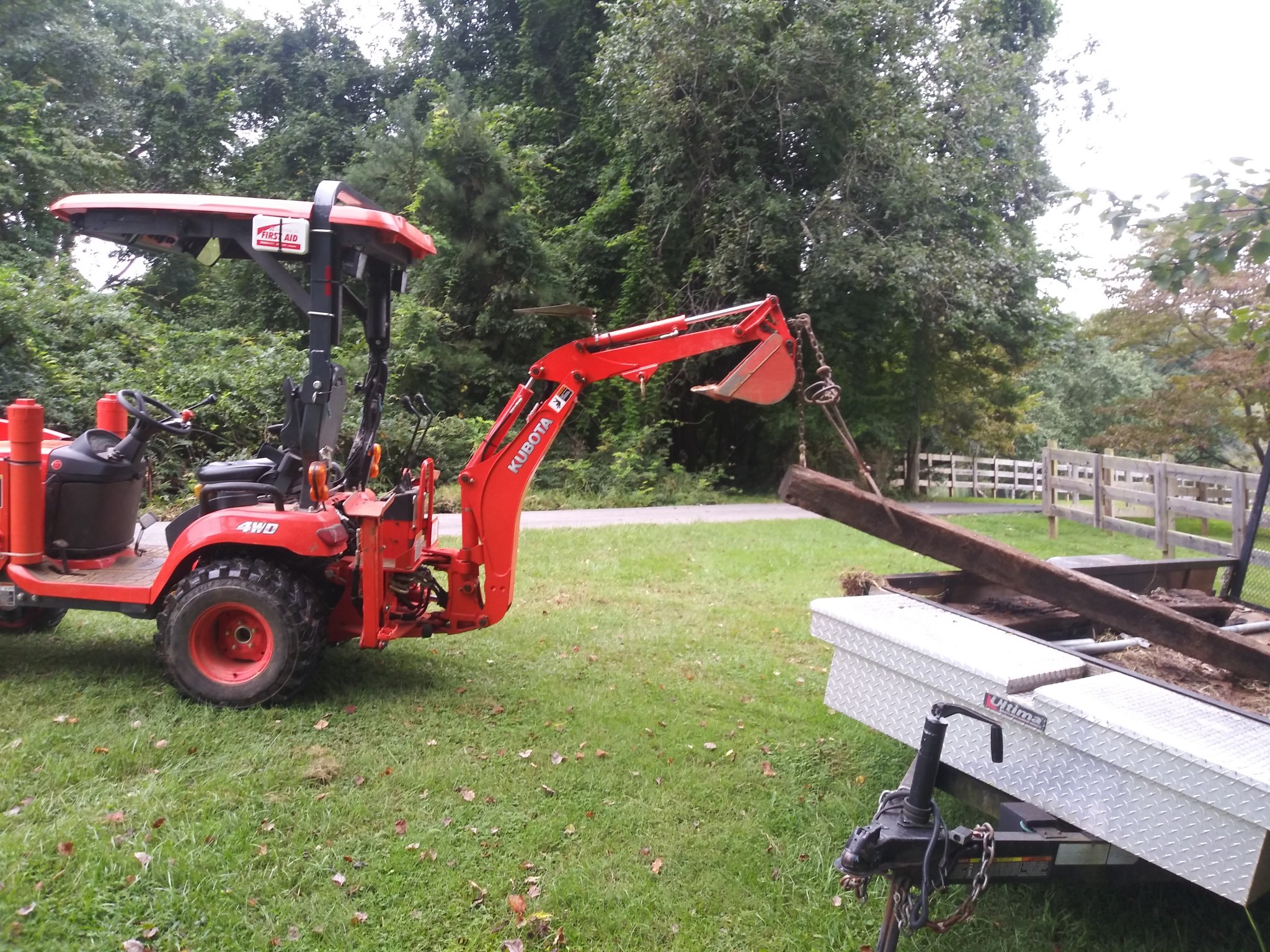

The BX will do everything the B will do, just in smaller bites. I have had my BX for 7 years, no regrets - have I ever thought of going bigger? Sure.... but the reality is the BX is perfect for my situation. The money saved on buying the BX over the B would be enough for a MMM or a 4' rotary mower.
People think the BX is an overstuffed riding lawn mower..... if you look at my avatar .... that is a rather heavy HST John Deere it is picking up and moving to the trash:love:
I used the BX today to skid some railroad ties off a trailer (using the hoe) did it with the FEL and carried several at a time also.....they way I did it today was easier and I was not in a hurry to get them all at the same time.
The B does have 3 ranges .... and more hydraulic capabilities as you mentioned - but unless you need that heavier lifting and multi range - the BX is still a perfect choice. I have increased the bucket lift on my BX - it will safely pickup 15% more than before, as for ground clearance..... not sure I want to run over anything it will not clear easily!
