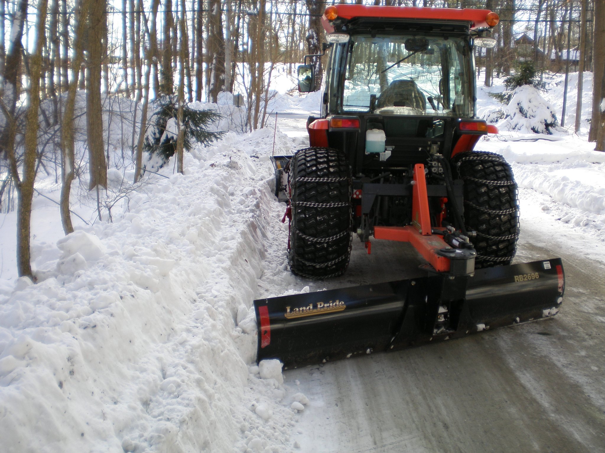

You want a rear blade width such that when you angle it your cut still covers the width of the rear tires. This is usually around a foot or 2 extra width.
sheepfarmer
Nov 14, 2014
4,441
677
MidMichigan
I'll be the contrarian and say that there are some cons to getting the biggest blade you can find. Owner's manual recommends max of 72 inches for the L60 tractors. I had to take into consideration how much space I had to park the tractor plus blade combination, and opted for something a little smaller. More important if you have a swivel type attachment to angle your blade, you may find it useful to turn the blade around 180 degrees to do certain areas like lawn or concrete where you don't want it to dig in. Too long a blade and it won't go past the rear tires and you will have to take it off the tractor to reverse it. These blades are heavy.
Even if the tracks aren't covered, it is quite functional to scrape with the blade offset and angled. Two passes and it's done.

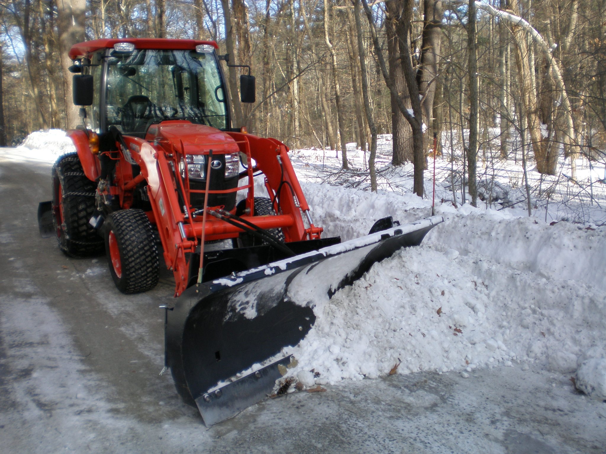

Thanks for posting the pictures... It makes it much easier to know what you are dealing with there..
It was my experience with a front blower you learn to appreciate a good packed base to work from..
The advantage of a 3 pt blower is you have the FEL to break things up so you can blow it back... Good luck..

I have a 96" plow and rear blade with my L3560HSTC and have had that for 8 years now. Never have I had any problems with size and power. I use them in conjunction with each other, the plow clears the brunt of the snow and the rear blade cleans up the tailings nicely.
