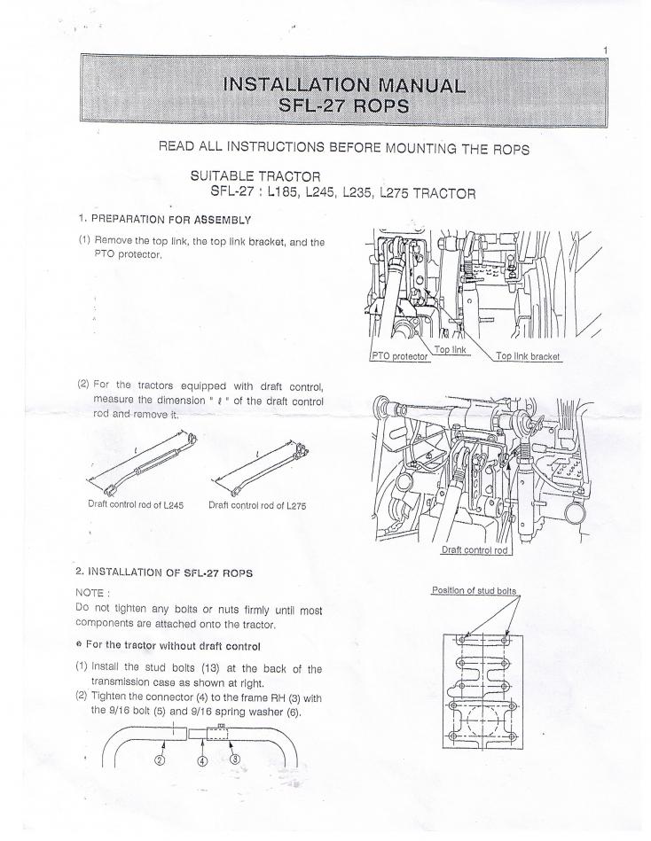

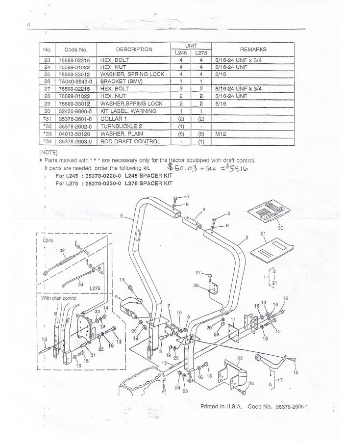

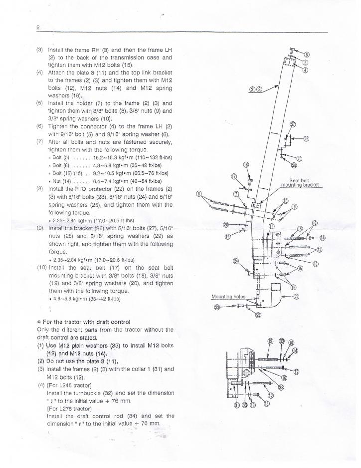

I have an L225 without ROPS. I can pick up some Chromoly tubing on the cheap, so I'm going to build my own. Anyone have suggestions/pics of where/how to install? Where do the factory units bolt on?
Gotta ask. What size/shape/specs on the chromoly? I'd trust my own ROPS out of chromoly over the factory unit any day as long as it was sufficient size and shape.
