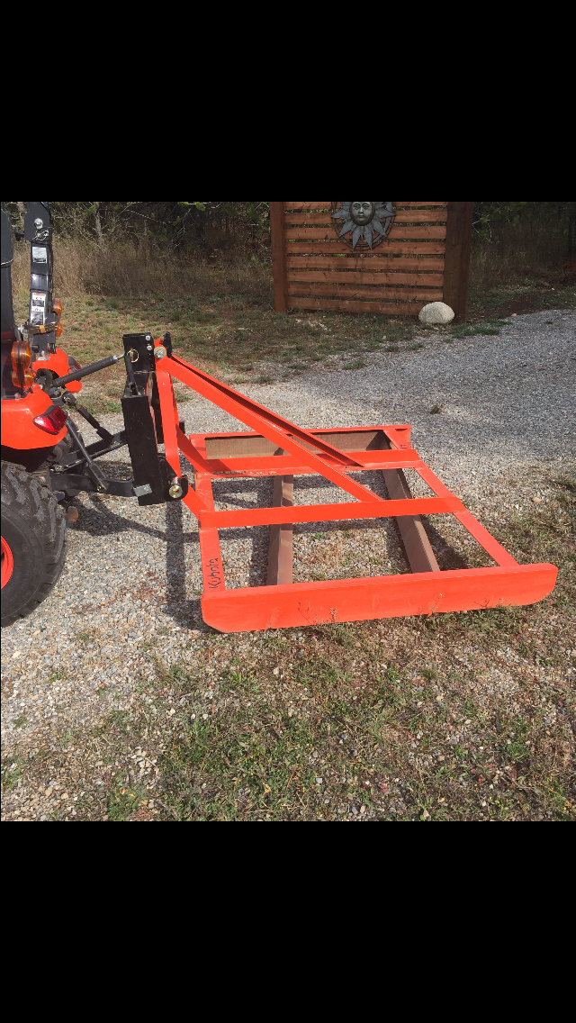

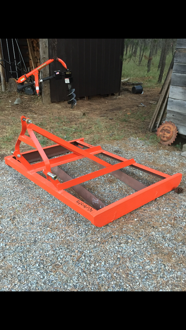

olekid, I made one from some borrowed parts off of my box blade. I can put them back on the box blade when that's needed again. I use the land plane much, much more than the box blade. Here's a link to some pics. see post #6
Pull type leveling box scraper land leveler | OrangeTractorTalks - Everything Kubota
hope this gives you some ideas. I didn't draw up any plans but I could take some measurements for you.

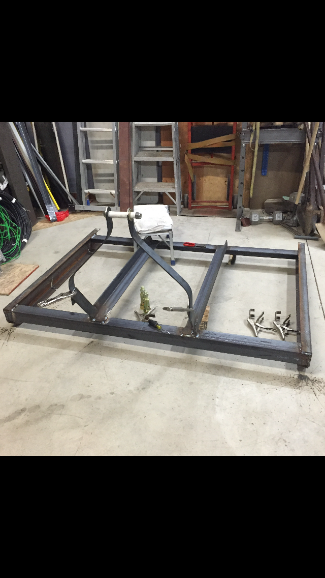

There’s a few builds on here, with measurements. Best way to do it is find one for the size and weight of your tractor, take pics and copy it. That’s how I built this one. Copied a friends.

Depending on the size of your tractor, you may not want to make a huge land plane if you have a BX. You don’t want to lower it and have it stop your tractor. I made mine (blades) 60” wide, and the two AR Steel blades are 5/8” below the side rails. I measured the angle of 15 degrees L to R on the blades.
The longer you make the side rails, it will cut flatter. I made mine the size it is because I got that size side rails from a friend.
Mock it up first. The 60” blades at an angle makes the width approx 58.5”. You need a little weight, but too heavy is a hindrance.

One more thing, when I fabbed up the blades(4” AR steel flat stoc) , I backed them by adding some 2” 3/16 flat stock to make the blades into T configuration so there is no deflection . I only stitch welded them about one inch every six inches or so.

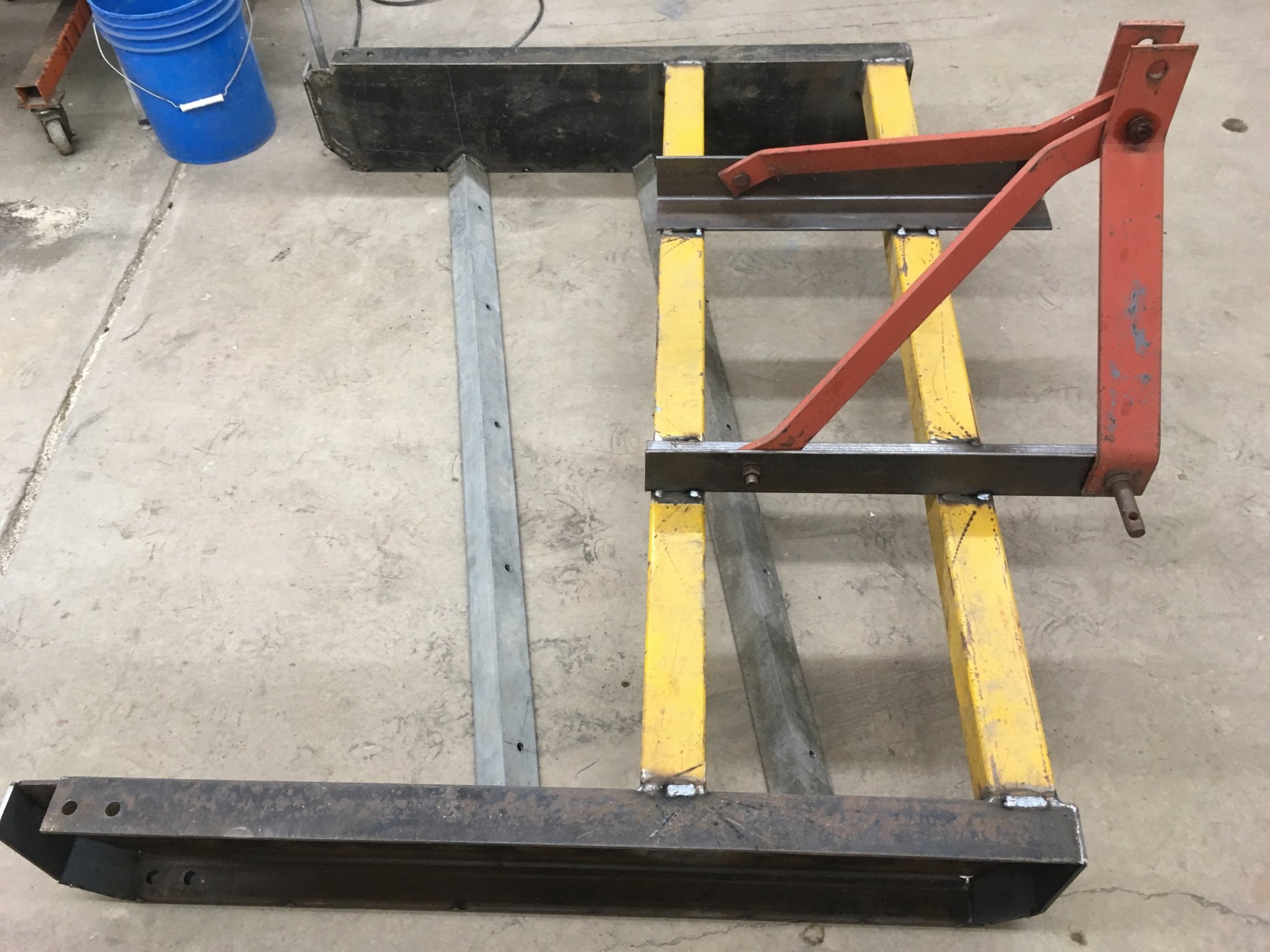

We made one at work, and I have one at home that has been configured two ways. The first picture is one we fabbed for smoothing some gravel areas at work.

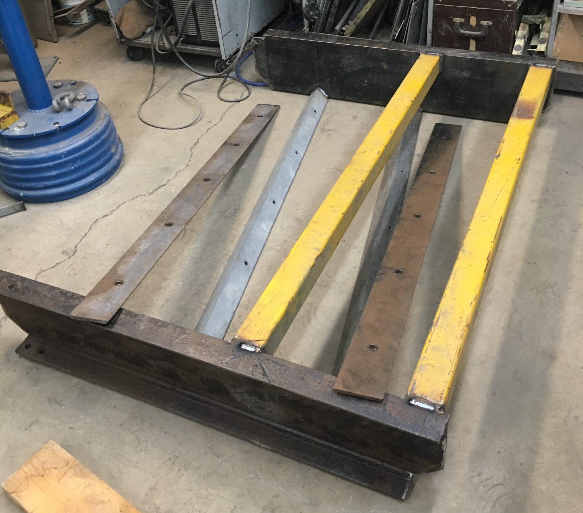

The next two are of the one I made for here at home. In it's first rendition, it was suspended and pulled with chains. It worked OK, but was a little unhandy for casting material right and left. Using it here with the B7500 years ago to make a parking area at one of #2 Son's rentals.
The current configuration is with an old pipe flange for added weight and rotation control.
