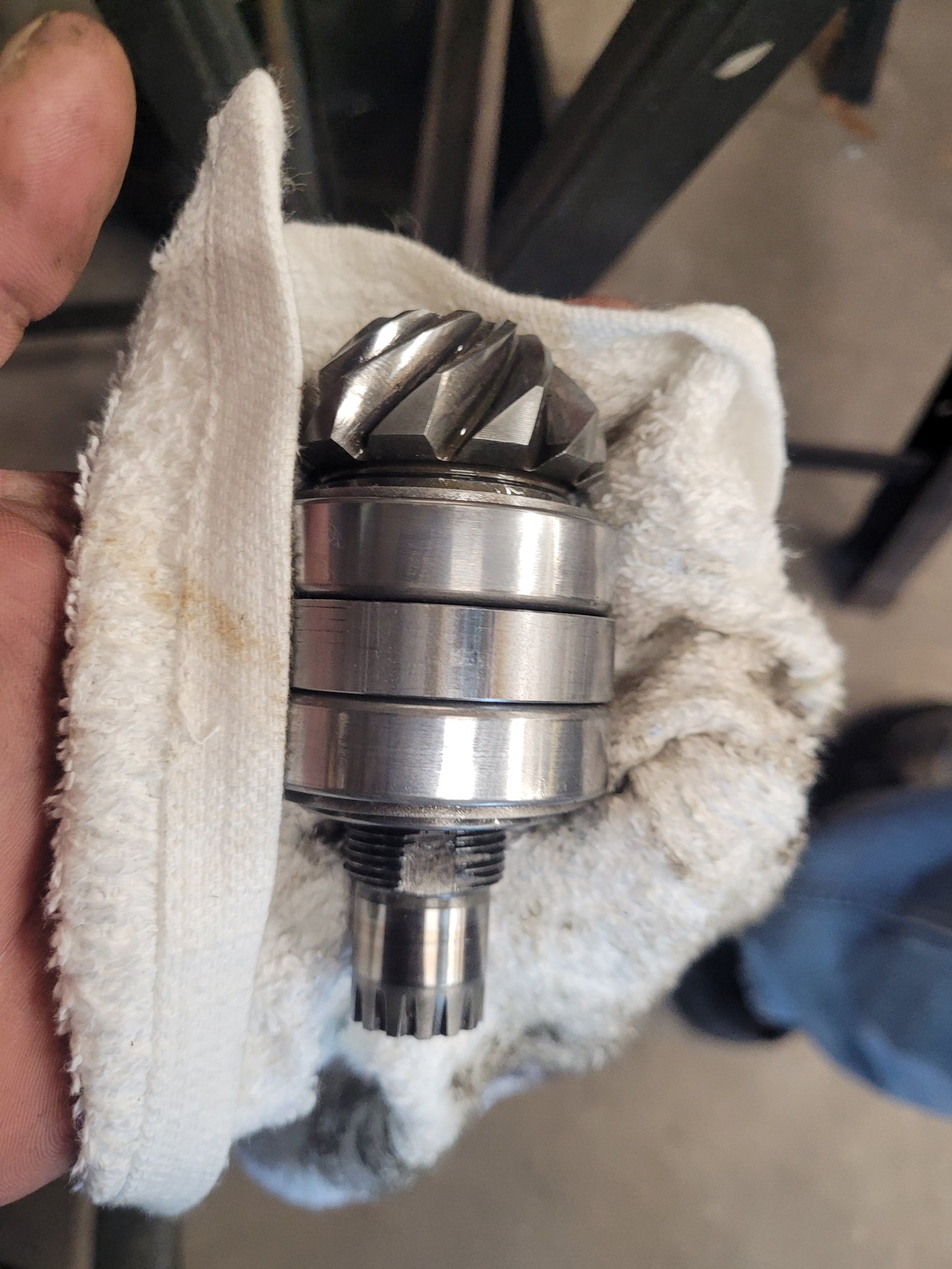

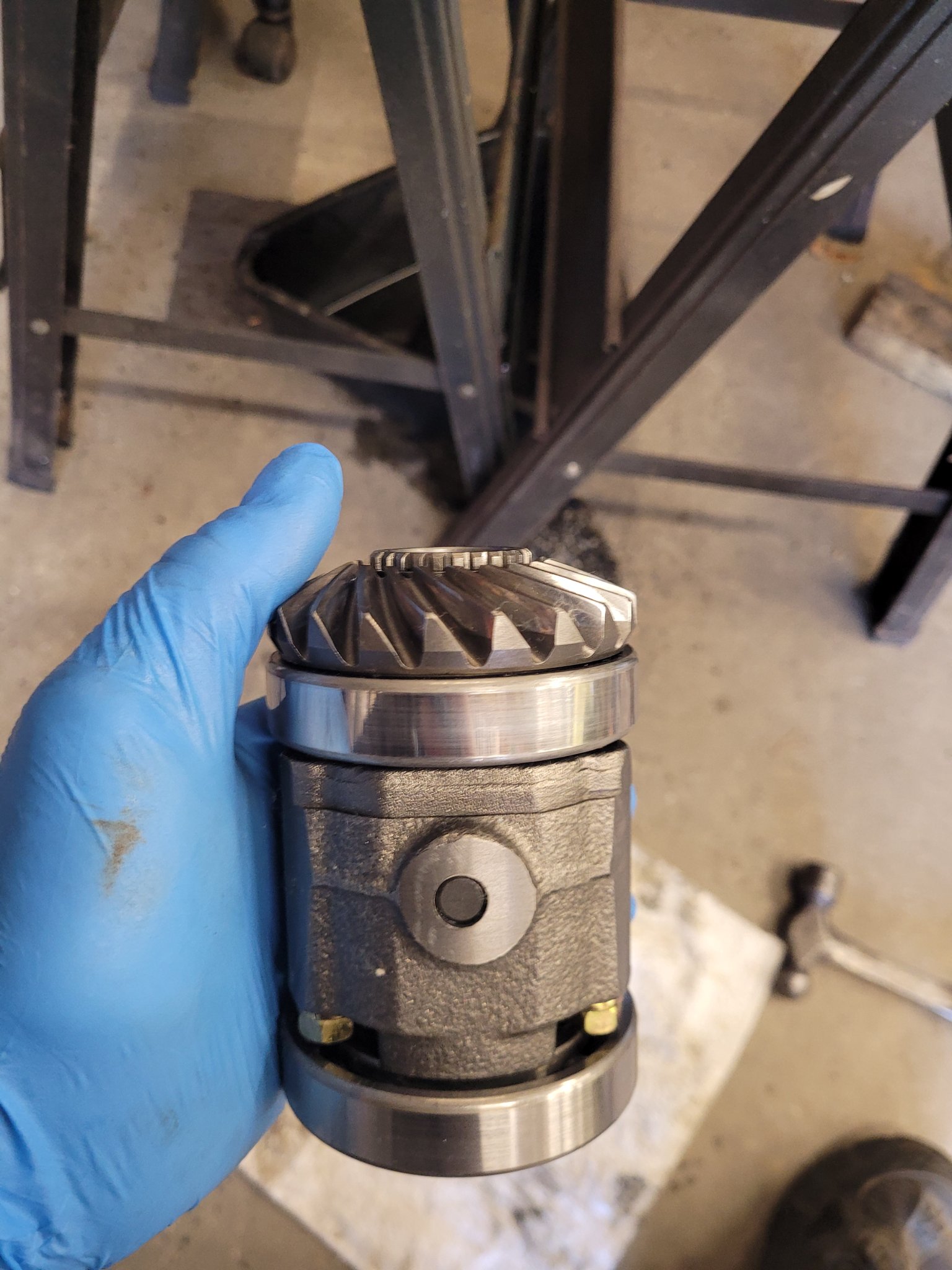

Cleaned up tube and differential. Replaced bearings on differential and new bevel pinion gear. Did not do anything with diff gears. Reinstalled pinion shaft with factory collars. All is within spec. Tightened nut down so I have 34 lbs of turning torque. Everything nice and smooth with no noise.

Good news!
Even so, it's probably a good idea to check the gear mesh pattern on the teeth with marking paint.
I have used a dial indicator placed against the face of a ring gear tooth to check the gear lash. I forget the specs for the diffs I was working on, but they are probably not applicable to your diff anyway...

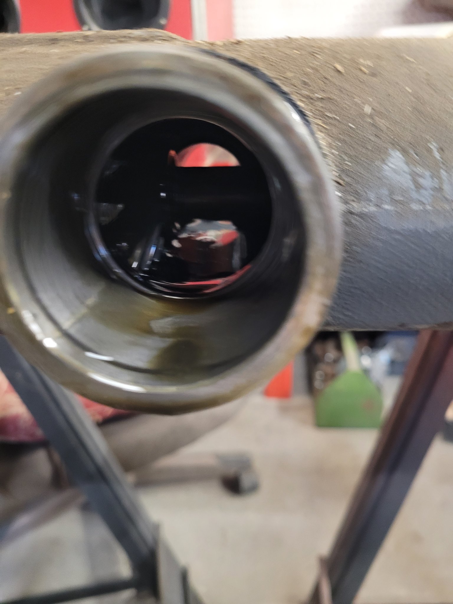

This thing is so little and it slides down into the tube. No way to measure anything inside. Not going to worry about pattern. In 4wd only moving a few miles an hr.

I knew that there was a reason that I never wanted to learn how to do differentials. Thanks for reminding me what it is. I would rather pay someone else who does it all the time to do the setup for my 1962 Chevy than attempt it for myself. The local differential shop charges a flat $450 to do the setup on a positraction differential and doesn't care if you buy the parts from them or bring them the parts needed.
