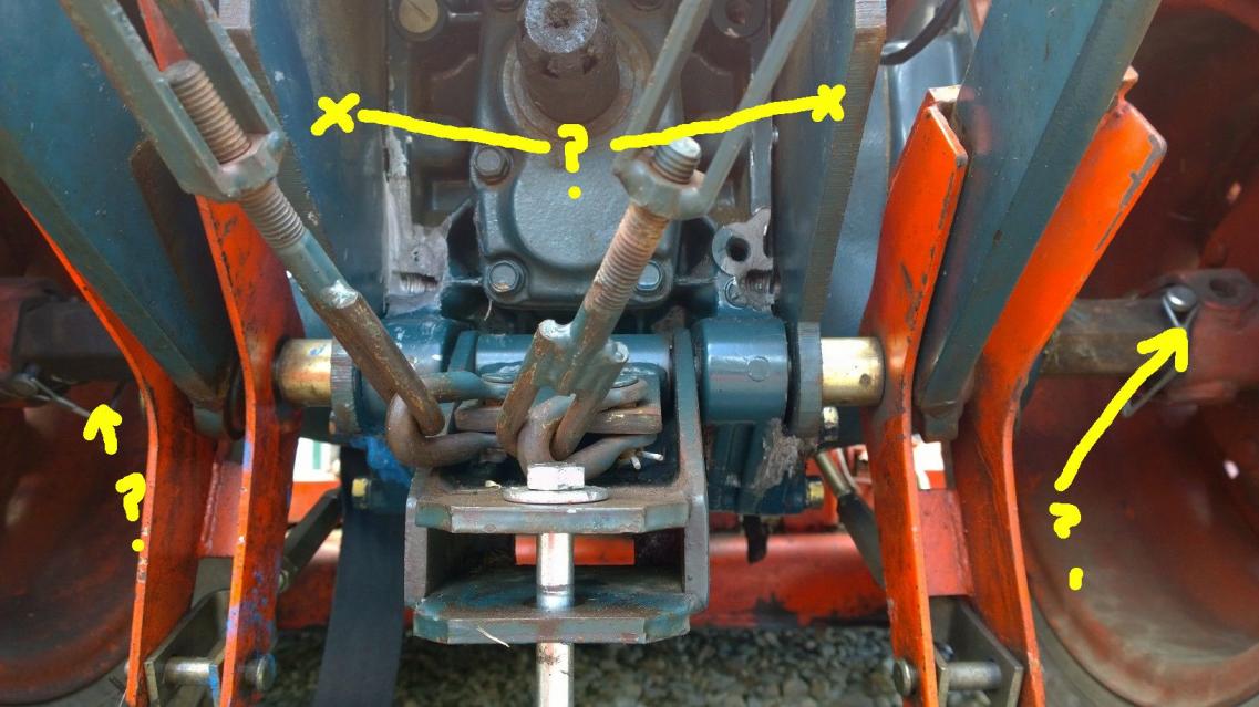

Just bought a new house on 5 acres. I was in a hurry, new to this, stressed out, knowing I needed to start mowing all that grass. Rushed into a private purchase of a B7100 with a 60" underbelly mower. :eek: Now discover that the rear differential housing is both broken (someone tried to pull something they should not have) and badly leaking (see picture). :eek:
I am already $2,500 into this. How can I keep from spending another $2,000 to replace the center casing? How do I know when to cut and run? :confused:

Looks like a casting was pulled off. I don't see any oil. If the housing is OK, why worry?

I need another picture from a little farther back, and at right and left angles of center.
I'm trying to figure out what the 2 plates on the side of the Differential case housing are????:confused:
Back hoe mount?
I see where they have blobbed blue silicone on the bottom on the left and smeared something on the right lower side too.
and why are there pins on the inside of the axle hubs????
Post some more pictures and we should be able to get you going on a good path to recovery!

NIW, I think those two plates are the pto shield. I have mine off the tractor and working on it now and looks very similar to mine. Several things don't reflect my b7100 setup from this single photo.

And here is a view from the rear, right. The drip is the worst on the left side, perhaps running down a bit and dripping off from the lowest point. I bet it could lose a quart or more of fluid a day. Perhaps more.

Give me a picture zoomed out I need to see more!
From what I see it looks fixable to me! ;)

Have you tried checking the bolts that hold the axle cases to the side of the differential? I don't know what caused the breakage on the rear. However it looks to me like the leak is between the axle case and the differential case.

The pins on the axles are for the wheel adjustment in or out on the axles. You can make the rear track wider or narrower.

What's confusing Ogre, is that the pin should be going through the hub and through the axle. On my b7100, that is what holds the tire on the tractor as far as I can tell. I don't know how your wheel is staying on the tractor without that pin in there, other than the fact it has only be driven lightly on level ground. It looks like it should just be able to walk off the end of the axle. You may have to lift the tractor, remove the wheel, rotate the hub, so that the hub and axle have an aligning hole for the tire width you want to achieve.

I know that, but why are they on the inside of the hub instead of going through the hub like they should? :confused:
good point, didn't notice the pins weren't through the hub until you said something.

It does look that way, and seems to me that is the first thing to do. I have not had a chance to try (still moving and such). But I have had two mechanics look at it and they both said, "I can't" - but all that was without either one of them actually laying a wrench on it.
If it were simply those bolts were stripped or something, they could be retapped and replaced - correct?

Wow, wouldn't that be something if they were so very careless that they actually did not pit the tires onto the axle. But that would also tell me that they also probably have not made any real effort to fix that leak.
