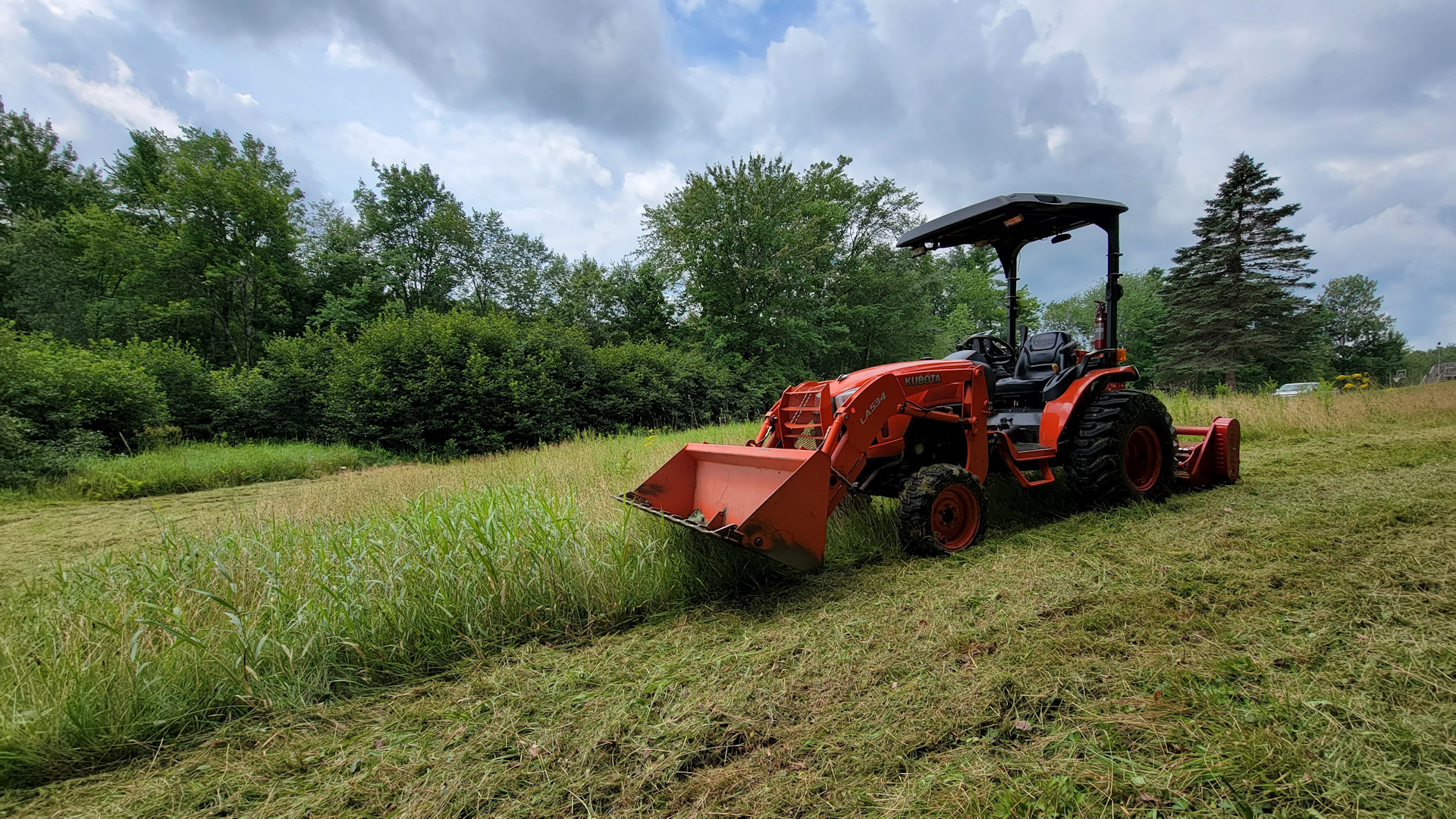

Can’t advise how to fix but when I have my cutter on the back, I’ll keep the FEL bucket low when going forward, and if in an area that I haven’t cut before, I’ll back it in with the cutter up high until I’m feeling the love.
And leave the cutting edge curled up when mowing so you will climb up on whatever it is giving you time to stop gracefully. It only took one blind full stop on a stump to always remember to do that.
